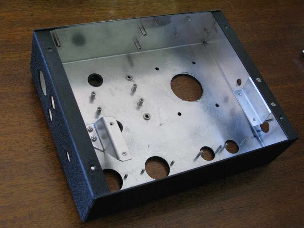

Well this afternoon my Elmo arrived, as expected, it was missing the stage glass and wouldn't power on whatsoever. I don't like the idea of 750 hour bulbs ~$100 so I didn't want it to work anyway. I picked it up for US$85 after shipping / crossing the border etc. and I hoped that all the optics would be intact.
I was happy to see the reflector, condenser and projection lens all in good shape, the top side of the fresnel has a small? scratch on it.. but since I can't light the OHP yet, I have no idea how big a deal it'll end up being.
Anyway, 30 minutes and a few shredded screws later, I now have a roomy, empty, Elmo to work with. By the way, I have a bunch of Elmo guts I have *no* idea what any of which does, if anyone wants some.. e-mail me.. I might want to keep some handy for now though./I]

The Broken Elmo
Optics intact!
The "fixed" Elmo 🙄

The Broken Elmo
Optics intact!
The "fixed" Elmo 🙄
