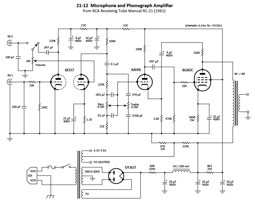

I have this little Masco ME-8 amplifier whose circuitry has been universally condemned by the local braintrust, and yesterday I happened to stumble across this schematic in my RCA tube manual, which uses virtually identical chassis hardware, making a retrofit pretty much a no-brainer if this circuit is worthwhile. It certainly seems normal/acceptable to me for use as a guitar amp (ie. linearity, distortion and bandwidth are not really a concern.)
But the ME-8 used octal tubes and this RCA design uses 9-pin tubes, but I believe I can use a 6SL7 in place of the 6EU7, and find a suitable octal version of the 1/2 6SL7 for the other tube. Or perhaps I could incorporate another triode into the circuit somehow, in order to end up just using two 6SL7s.
Can I just parallel the 2 triodes and adjust the operating points accordingly?What does that accomplish? More current flow certainly, but more gain too? Or might there be a better way to incorporate another triode without adding too much complexity (the chassis is really small/tight).
Your thoughts?
..Todd

I had a look at your other thread on the Masco. Why don't you just use the Masco as is for a guitar amp? A lot of classic guitar amps had grid lead bias just as the Masco does on the Mic input. If the problem is that you are using stompboxes and the Mic input is saturating from the higher input, then just convert that 1st stage into cathode bias.
I'd change the first stage (In1) from grid-leak bias to cathode bias with a bypass cap. Remove the 100pf cap and move the series resistor to the grid as a gridstop. And change the tone controls to a more traditional tonestack. THree stages is plenty, but you could make the second bottle a dual triode and either parallel them as you suggest or add an additional gain stage for more overdrive (but you might want to add an additional gain control between stages to give you control over it).

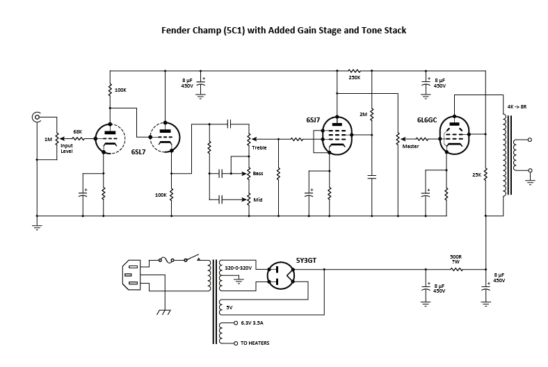

Okay, I've done a little research about tone stacks. I'm not sure where the best place to add one to a champ circuit would be though. The Masco circuit has an additional gain stage, which I consider worthwhile adopting, so I wonder if it makes sense to add the tone stack between the 1st gain stage and the pentode. And I understand that it's a good idea to use a cathode follower before the tone stack to provide a better impedance match for the filter network (which turns out to be handy for consuming the 2nd triode in a twin tube).
So here's my resulting schematic. Would this topology work? If so, I'll get out the data sheets and calculator and start figuring out values.
I was listening to some old 5C1 champs on Youtube. Very cool sound. I might build this as a separate project just because.
..Todd

In most guitar amplifiers the volume control goes after the first stage, because guitars have volume control on themselves.
So a better idea is to have volume control and tone stack between the first two stages, and add a master volume after the second stage. Standard way.

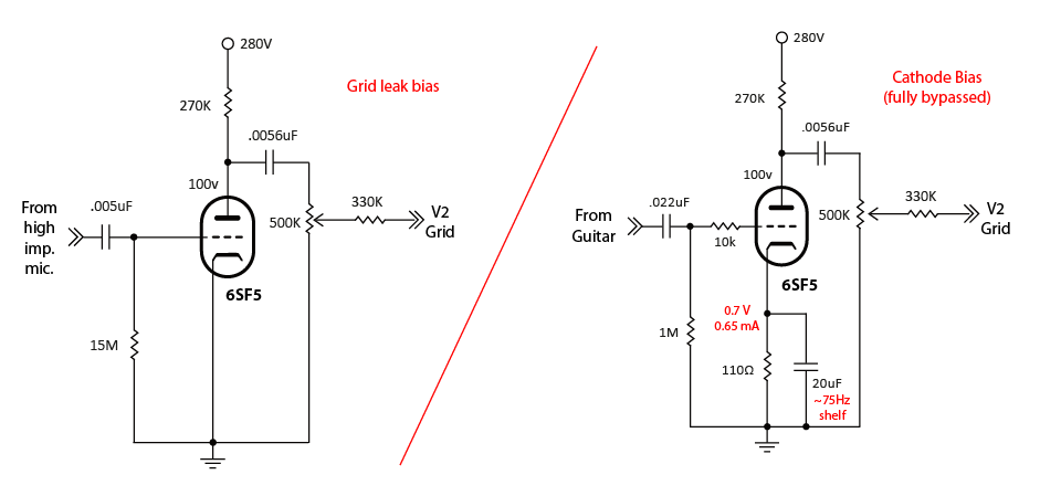

I was just puttering with this little Masco amp today to revive it in its current state. I've replaced the enormous filter caps that someone added to it at some point in its career, with ones much closer to the original sizes spec'ed.
Then I noticed the grid leak resistor on the input stage had at some point vaporized. The input tube, a 6SF5, was grid leak biased and I don't have a 15M resistor to replace the old with, so I decided to convert it to cathode bias. I planned to do that anyway one day, this just sped up the process. The goal is to change only the components necessary to convert the bias scheme and leave the rest as is.

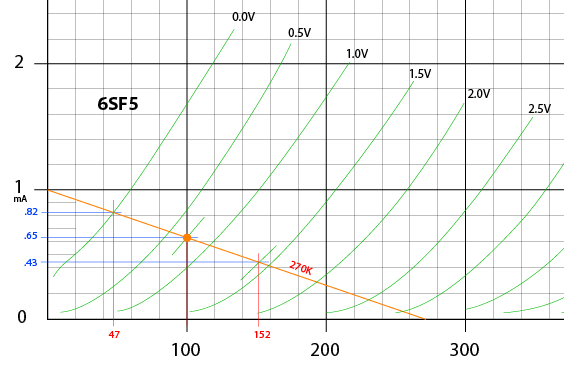

For today's dumb question, I just want the diyAudio brain-trust to see if I'm doing this conversion correctly. I grabbed the 6SF5 datasheet curves and plotted the existing load line and voltage points to determine what a reasonable bias point would be, and it looks to me like 0.7v/0.65mA will work.
Here's the circuit changes and load line I used. am I on the right track?
..todd
