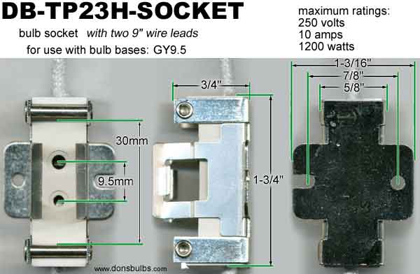

This should be self expainitory the bulb pictured above is inserted into the old reflector of the ctx two wires are conected to a GY 9 plug found at many stores online then ran into a normal 120Volt dimmer switch 2 wires with a standard wall plug on the end of it .Plug into a normall wall plug and bingo.You can adjust the brightness by using the dimmer switch,also the bulbs don't blow when you turn on the power because the power is slowly turnt on so that instant power does not blow out the bulb.

Most projectors will not work if it does not sence the bulb in place, i take it this projector is not like this, because you are not using any ballast from the projector at all, just straight to the wall plug with the bulb and dimmer switch and bulb placed in old reflector and placed back in projector bulb bay. Just asking for clearification.
retro fitting ezpro680 !
that is totally correct the bulb has just been replaced with the new bulb then put back into place ,however i am now experienceing an over heating problem with the new bulb.I need to add another good fan.
