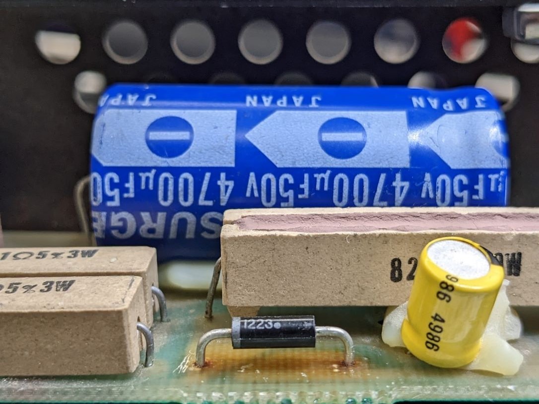

I've got a Crate G-40C guitar amp I bought new back in the mid-80's. Sometime in the first half of '93 it stopped working after an hour or so of use in a hot rehearsal room. I thought at the time it might have blown a fuse so I opened it up for a look. I didn't find any blown fuses, but I did find some scorching on the bottom of the rear PCB under what I think may have been a diode or resistor.
I say "think" because my troubleshooting efforts stopped there back in 1993. I have a faint recollection of de-soldering whatever was located there with the intent of trying to find a replacement, but I ended up just bagging all the loose parts, screws, etc. and setting it aside until I had more time to investigate further. Well, here I am now 28 years later picking up where I left off except all I have in the bag of loose parts is the four long machine screws used to hold the amp chassis in the cabinet and a short 4A/125V fuse of unknown origin. Conspicuously absent from the bag is whatever component I removed from the rear PCB (along with the screws and stand-offs to mount the rear PCB in the metal chassis and the three screws used to secure the IC heatsink to the chassis).
Now, I have a remedial understanding of electronic components (capacitors store energy, resistors restrict, etc.) and I'm comfortable with through-hole soldering. But that's about it. Having said that, I figured checking the schematics would be the best place to start trying to identify the missing mystery component.

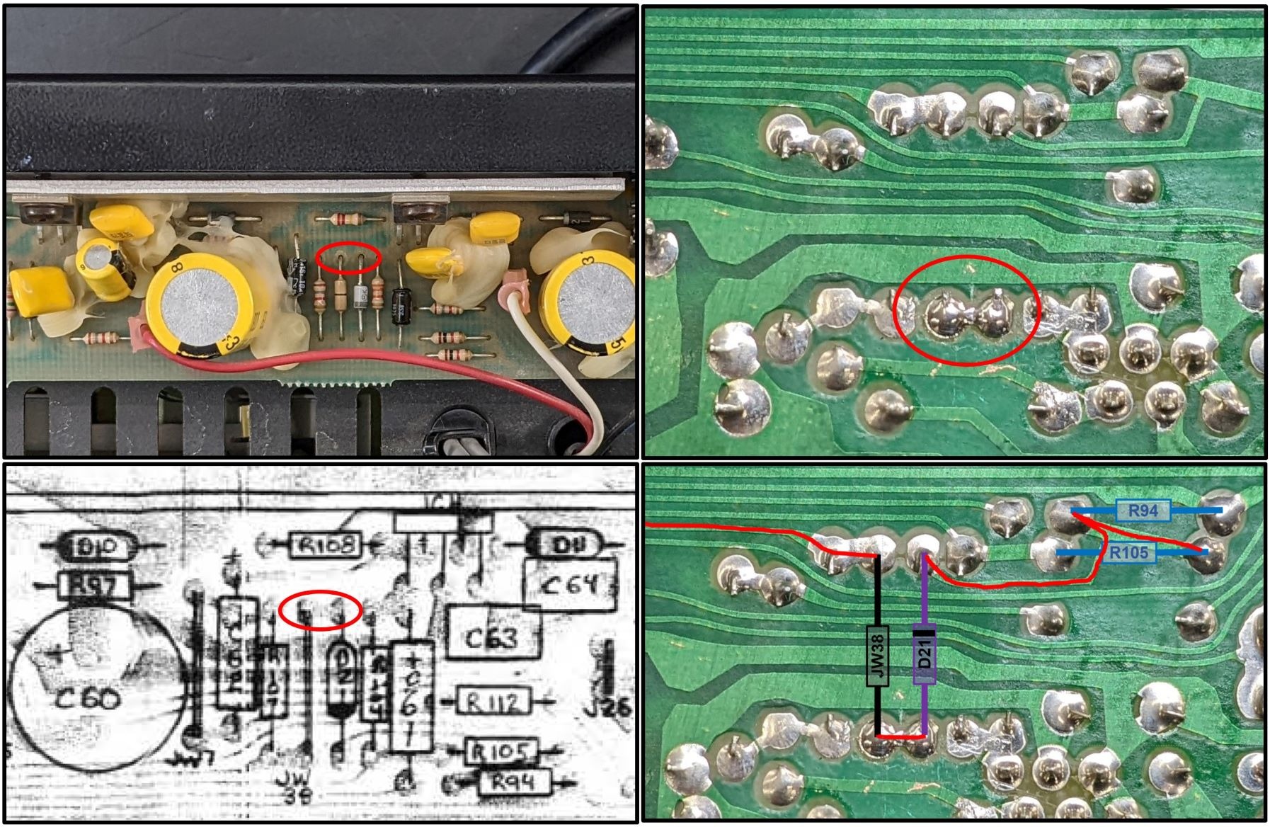

The manual that came with the amp has scaled down schematics, but I found updated versions online here which actually has a diagram of the PCB layout along with the schematics.
Now the fun part: As you can see in the pic below, the layout on my PCB (top) isn't the same as what's shown in the Pictorial Assy layout (bottom).
There are 2 differences I have concerns about:

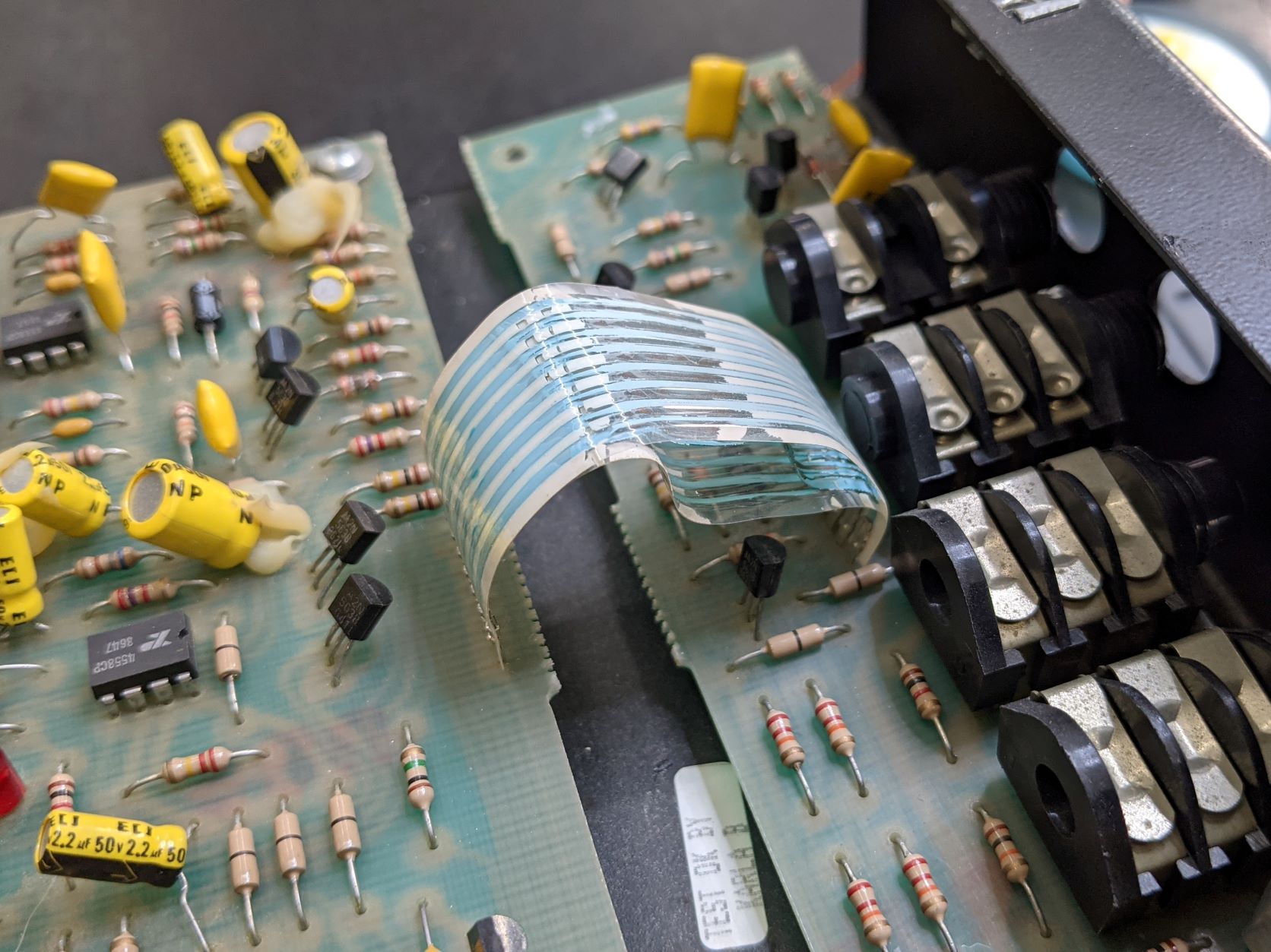

Lastly, one of the ribbon cables connecting the PCBs has started to delaminate.
Does this need to be replaced before I plug it back in and turn it on? If so, will regular computer ribbon cable suffice, or is there something specific I should replace it with?
- The diode and capacitor at the front edge (noted in red) are not in the same location on the board as on the Pictorial Assy. The capacitor (C70) on the board does match the specs in the parts schedule (47/35V). Also, it appears my missing mystery part is a Zener diode (D17, listed as "1N5357A, 21-557-01" in the parts schedule).
- The component (JW36 - noted in blue) at the back edge of the board is supposed to be a jumper wire (like JW9, also noted in blue) but appears to be a resistor. It (JW36) measures 0 ohms on the multimeter, so it's a 0 ohm resistor? Not sure what's going on there.

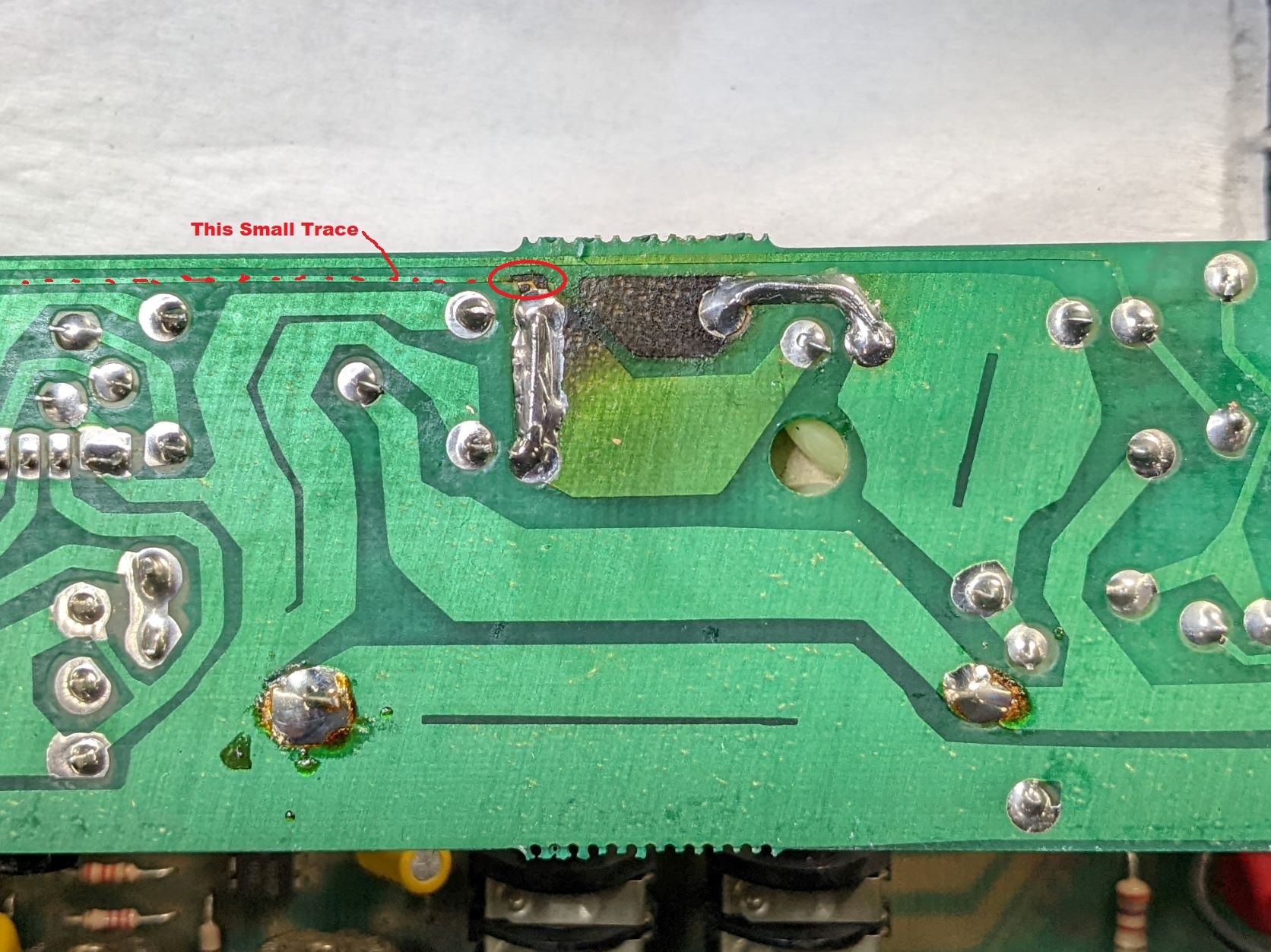

The Zener diode is 20 volt - 5 watt. This puppy was making heat and likely was installed right against the PC board.
What I would end up doing is get a new Zener, allow it to stand off the PC to reduce the over heating on the PC board. And on the overheated solder pads...I would carefully scrape down to bare copper near the holes - and scrape area to solder the leads flat to the traces, and if the device leads are long enough, run them over to the nearest connection on that trace. Hope that makes sense.
The electrolytic is in parallel with the Zener and band end of the Zener would connect to the positive lead of the electrolytic.
The component with one black (zero in color code) band is indeed a "zero ohm resistor". You will see more of those in that amp.
I looked in my files and do not see the service file on this amp.
If you have the schematic - establish the resistors feeding the Zener are close to the indicated value.
That ribbon cable - I have not seen that before in my 50 years of bench service.
If the conductors are sticking ok on a side of the ribbon - and not broken or touching, I would at least try the amp.
Of course establish continuity one board to the next on each conductor...

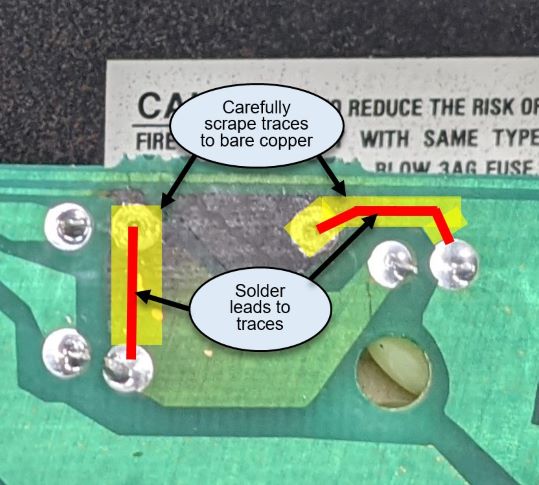

I think I understand.And on the overheated solder pads...I would carefully scrape down to bare copper near the holes - and scrape area to solder the leads flat to the traces, and if the device leads are long enough, run them over to the nearest connection on that trace. Hope that makes sense.
- Carefully scrape the area round the through-holes down to bare copper.
- Find the nearest connection along the trace on each side of the diode and carefully scrape the solder mask down to bare copper along that path.
- Install the diode and bend the diode leads to follow that path.
- Solder the diode leads to the bare copper through holes and path to the nearest connection.
Does that look right?

Your photo with the red lines is exactly what I meant. Yes.
And if the leads reach the other component solder connection - do that.
Any 5 watt, 20 volt zener should be ok.
Have seen scorched PC boards many times.
And what you are doing is what I have done each time.
Leaving air space between the zener and the top of the PC will give some air distance....

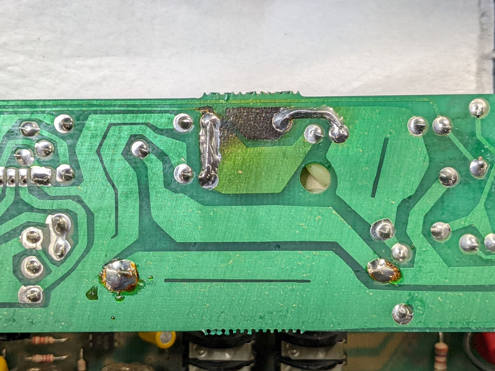

I got the Zener diode installed (1N5357B; 1N5357A's were nowhere to be found). The leads were long enough to make it to the nearest component on each side of the trace.
I checked the delaminated ribbon cable, and it had continuity on each lead.

The way you did the zener on elevation and the bottom of PC connections is exactly as I suggested.

far as the replaced zener, seems like most the burned pathways has been fixed with the jumpers
but there seems to be a small trace leading away from it, that still might not have good connection
