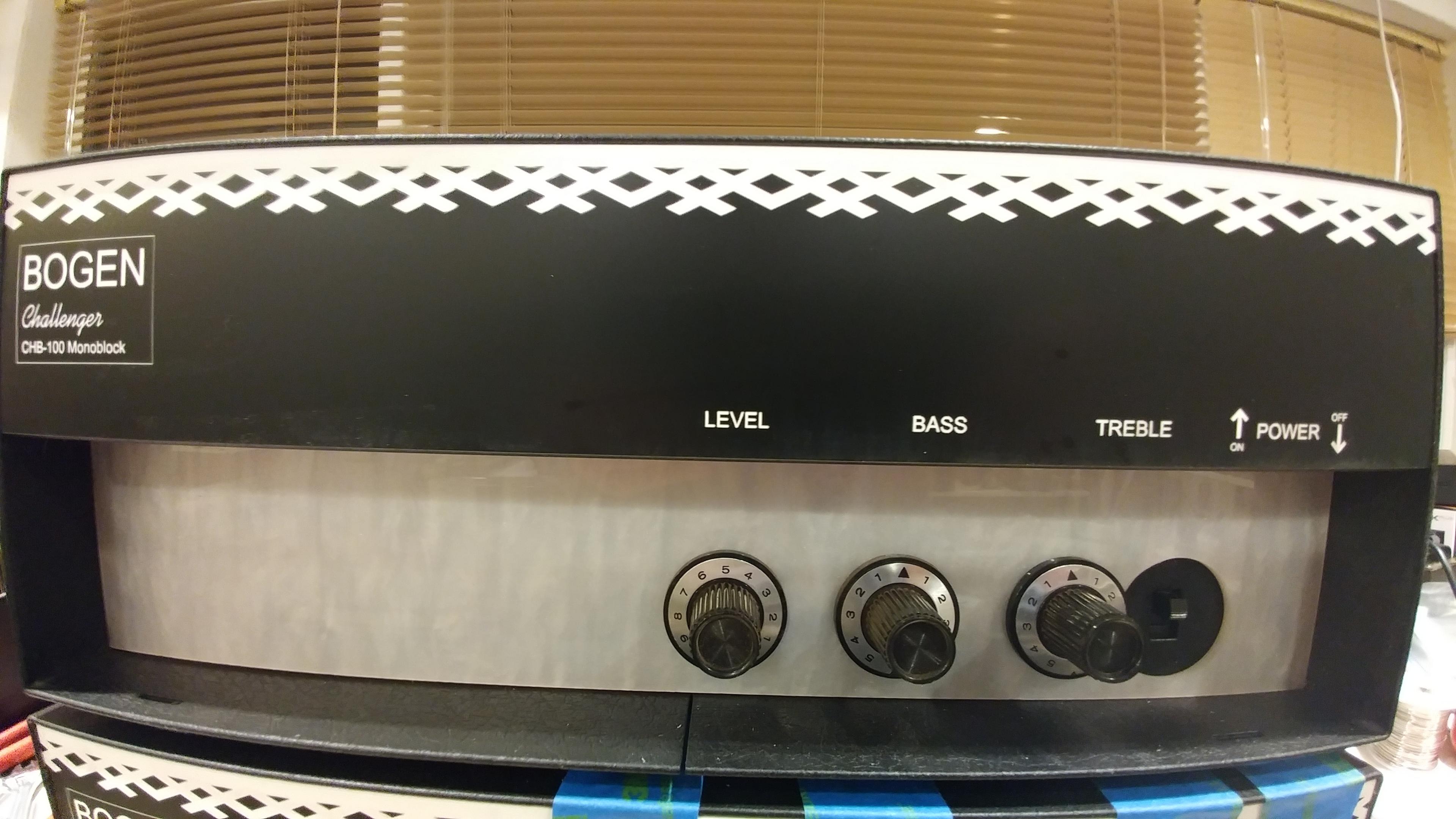

I've been using this Bogen CHB100 as a bass amp for about a year now. The only things I've done to it was replace the old-style microphone jack to a 1/4 inch jack for ease of use, and swap the 12ax7 tube for a newer one I had laying around. I really dig the sound I've been getting from this... it's clean but gives a nice distortion if I set the gain at 7-8 and keep the volume low. I understand people do more modding to these for guitar amps to get a more colored tone, but the clean-ness works well for my bass application.
However, recently I've been getting more and more distortion even with gain set low and regardless of volume position.
It seems the amp has the original 7868 tubes in it, as well as the original filter caps, and from what I've read one of these two could be the problem. I've wanted to replace both for a while now just to keep this amp healthy and avoid any spontaneous failures, so I feel like now is the time to do it, and if it solves my distortion problem, that's grand, and if not I'll address it afterwards.

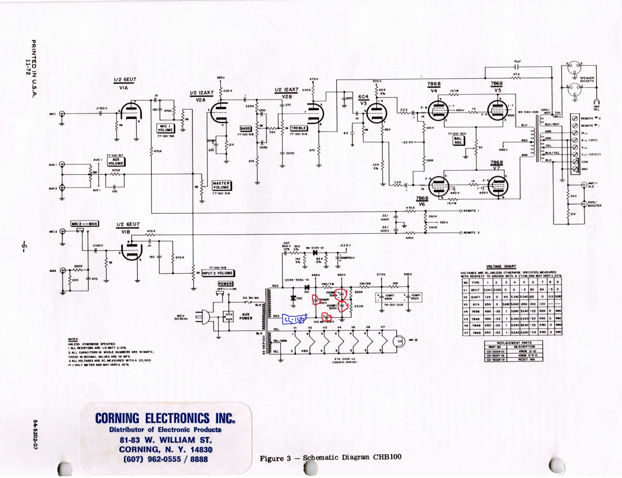

The tube swap will be easy, I'm getting 7868 to 7591 pin adapters and going to buy a matched quad of 7591s to use, and all that makes sense to me. Replacing the filter caps is what I'd like advice on. Attached are pictures of the guts, and a schematic of the CHB100. On the schematic I have circled the four caps that correspond to the large brown caps in the pictures. Are these the only ones that I should be replacing or should the blue caps in the photos also be replaced?

I would replace EVERY SINGLE ELECTROLYTIC in that amp.
dont wait.
Use a good cap from a reputable manufacturer.
You can do better that the Sprague.
Look to Nichicon or Chemicon or such. I have had poor results with the Sprague atom. They have a name that no longer deserves admiration.
Have a look at the coupling caps as well.
Ping Eli duttman.
Let's rotate the schematic, for ease of viewing.
I agree with mctavish; eschew Sprague "Atoms".
FWIW, Panasonic and Nichicon are my most favored 'lytic brands, but other brands can be good too. Definitely select 105o C. rated parts. It may be necessary to employ either snap in or radial lead parts, instead of the OEM axial lead parts. Taking advantage of Sheldon Stokes' idea of mounting a substrate on the power trafo chassis screws frequently eases the burden of switching to the modern 'lytics.
Mouser, DigiKey, etc. will charge you less than an instrument specialty house. Speaking of instruments, if bass meant bass guitar, Instruments and Amps is the correct "board" for this thread.
716P series "Orange Drop" caps. will be highly suitable in the signal path.
The triodes in the 6EU7 are the same as those in a 12AX7. What's special about the 6EU7 is a spiral wound, hum bucking, heater and its pin out. You can get the hum bucking at lower cost by switching to a 7025 equivalent, like the Sovtek 12AX7LPS. Of course, the socket needs rewiring.

Any caps that attach to the plate of one tube and feed the grid of another ought to be pulled out and replaced, and the Orange Drops are a nice choice. Caps in this position are referred to as coupling caps.
It won't hurt anything and it won't cost much to replace the rectifier diodes with some UF4007s.
The first two power supply caps after the rectifier diodes that form the voltage doubler could be much more than 100uF without causing problems, and larger caps may fit a bit better in the space you have. These would be totally fine for replacing the 100uF/300V caps in each amp:
https://www.mouser.com/ProductDetail/CDE-Illinois-Capacitor/107TTA350M/?qs=3tP%252BN51vMXcmcGDbhPL69A%3D%3D
The 0.047uF cap that's part of the bias supply should be replaced as well.

Increasing the value of the PSU 'lytics is a very reasonable idea. However, take out insurance against the power trafo making a clanging noise, at power turn on time. A CL-140 inrush current limiting thermistor inserted in the line that connects the power trafo to the junction of the doubler stack caps. provides the requisite protection.
2X of this part in the doubler stack and 2X of this part after the 750 Ω resistor should work out nicely. The suggested parts are rated for 105o C. and have long service lives.
@audiowize - Is there room to "shoehorn" in something like this inside the enclosure? FWIW, I intensely dislike deriving the negative bias rail in the manner Bogen chose.
Eli, are you talking about right after CR1 on the schematic as the place to insert the thermistor, then from that to the 750Ω resistor and 100uf cap?

Filter caps. or PSU caps., it's 6 of 1 and a 1/2 dozen of the other. The increased capacitance reduces residual hum and may "tighten" bass. Yes, energy storage is increased.
The CL-140 location is shown in blue. Sorry about my twitchy hand on the mouse working with MS Paint.
