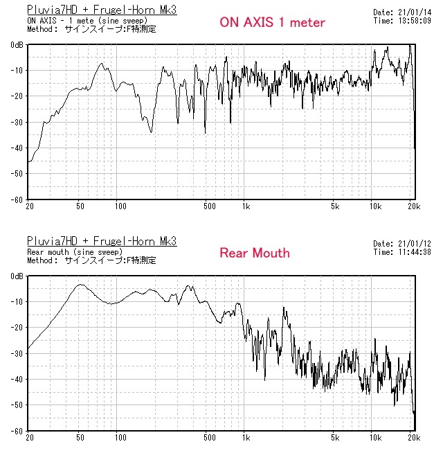

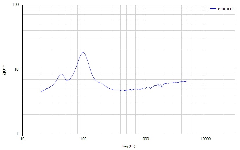

Resonant frequency of the Frugal Horn cabinet.
Here is a graph of FH3+P7HD.
I think it is right at about 50Hz.

Thank you nandappe for the reply, that confirms my thinking. I am going to build a pair using a couple of Peerless drive units that I have, they have an Fo of 50hz so I don't have to alter the dimensions of the horns - though the drive units are a little larger than the 4 inch ones usually used.

According the impedance plot above, the resonance frequency of the combined speaker and driver is about 55Hz - where the minimum dip is between the two peaks. You can also estimate to first order, based on the path length of the horn and the speed of sound - but this is modified depending on taper of the channel and blockage or “mass loading”.
