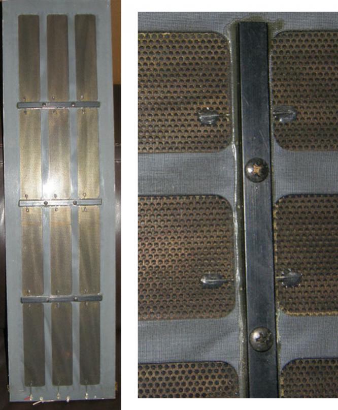

PIO Sound is actually trying to get a patent on using the mesh for damping ESL diaphragm resonance. 🙄
Brochure, review, and patent application attached.

I agree that the vast majority of ESLs have little if any damping. Obviously the Acoustat’s thick felt stator pads provide acoustic damping of the diaphragm resonance, although not in as elegant a manner as with the Quads. Some of the STAX full range ESLs used mesh similar to Quad although the weave wasn’t as tight and the mesh was attached on the outside of both stators. (attached pic of ELS-F81)
But, you are probably talking about current production.
The only other manufacturers that I know of that use damping is JansZen and PIO Sound.
Here are some quotes I pulled from the JansZen website.
“…You might be familiar with see-though ESL's, but these and most other non-JansZen ESL's are similar to one another, in the sense that the membrane motion is not damped. Our membranes, however, have just the right amount of damping….”
“…To prevent natural membrane resonances from coloring the sound, it is important to provide acoustical membrane damping. Many ESL's use a see-though design that increases loudness at the expense of resonant coloration, as well as inviting intermodulation distortion during resonant excitations. In JansZen ESL's, membrane resonances are fully damped…”

Correct. The PIO ESLs use the inverted drive arrangement.
I guess this shouldn't much of a surprise since PIO is the latest company of the FINAL designer.
Quote from the White Paper:
“With the PIOSound ADS technology the converted audio signal is fed to the diaphragm or membrane through a proprietary electrical module which uses a new and innovative transformer technology while a high voltage + and – DC signal is applied on the stator plates.”
aha thought it had more distortion this way.. to work well resistance on foil must be as low as possible?. segmentation is done then on the membrane. hmm well hopefully there coating is better this time 🙂 or they are sold all broken on second hand web pages again.

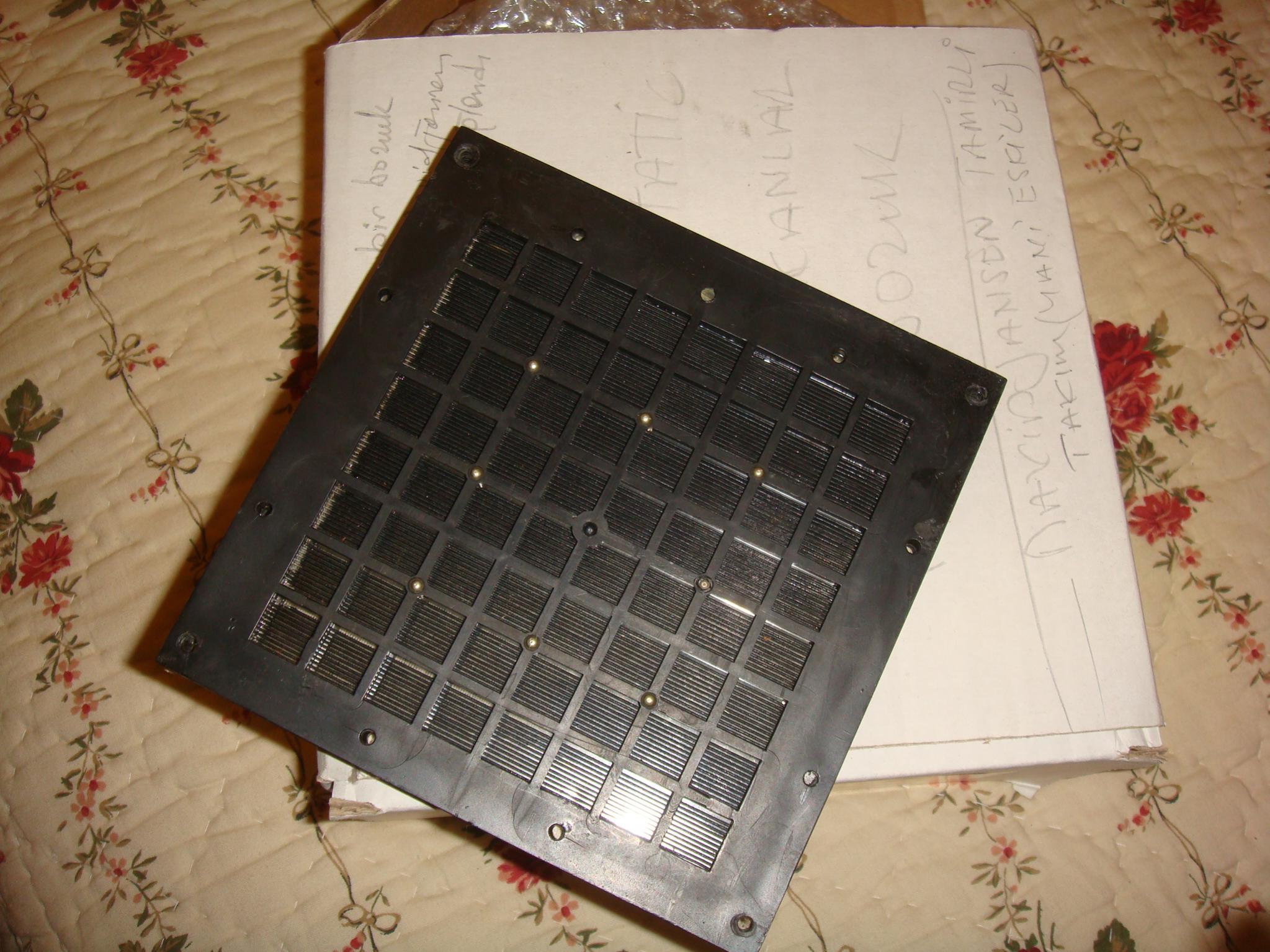

Dennesen tweeters, designed in some partnership with Jansen* of JansZen decades ago, also have some amount of light paper towel stuff pasted behind the rear stator for higher-frequency damping.
These cells are clever devices, 4-inch disks with the stator made by winding a wire round and round. I've always thought the fast-track to making DIY ESLs is to find plastic forms (like fluorescent lamp covers) to serve as the stators.
Ben
*got his training at MIT under Hunt who conceived the basic ESL analysis long ago.
I got these out of the JanZen 130s.....I have 8ea that work here now...anyone need let me know.....
nice panels, they look verry similar to the new ones. 🙂 almost identical. i thought about exactly the same sort panels. when i was fidling around with wires stators. and HPL. until i got side tracked to the Quads and stacked esl......
Those panels (and paired with AR-like boxes), despite being only upper-range, were a striking auditory revelation to many of us at the New York Audio Society in the 60's. And likely remain so today.
