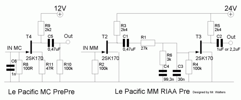

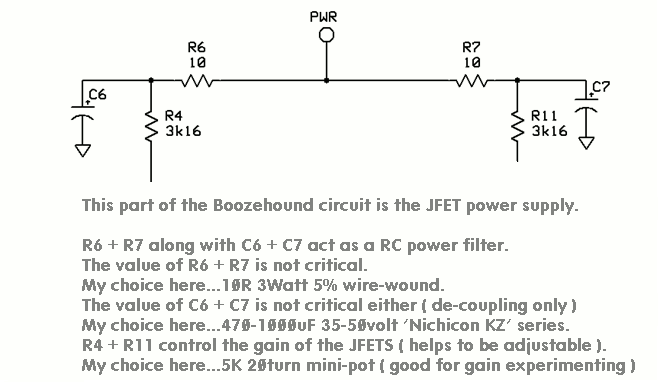

I am building my own point to point (no circuit board) version of the Boozehound labs jfet phono pre. I like all the Russian caps that were selected by BHL for the pre having a great cost to performance ratio. I am using all the stock caps on my build.
My question going out in to the diy community is about resistor selection for best audio quality and lowest noise for the Boozehound jfet phono pre. This is a low voltage solid state design and I would like to choose appropriate resistors for the circuit
Here is the link to the BHL jfet phono web page schematic:
Boozhound Laboratories: Phono Preamp Assembly Manual
Boozehound description of the pre has a comment that the resistors were good quality but not as tweaked out as the capacitor selection was.
Soooo....I have tried a few resistors in my day and I planned to maybe use some Caddock TF020 on the 100ohms in the circuit path and maybe some Mills wirewounds on the 10 ohm and 3.16K on the power supply section.
Any suggestions for the rest of the circuit, including alternate suggestions to my choices above?
I would like to use different brands and types of resistors to stop cumulative buildup of sound qualities, in other words to make the sound interesting and not have the same sheen on every recording.
Also I would like to keep the cost to reasonable under $10 per resistor ($5 and under would even be better), yes I know Vishay nudes are great but they fall apart if you look at them wrong and it gets pricey when you have to keep replacing them. (yes, folks if you have not tried the Vishay nudes BE EXTREMELY CAREFUL when soldering and handling them they are extremely delicate as there is hardly any material holding them together!)
Thanks for any help.

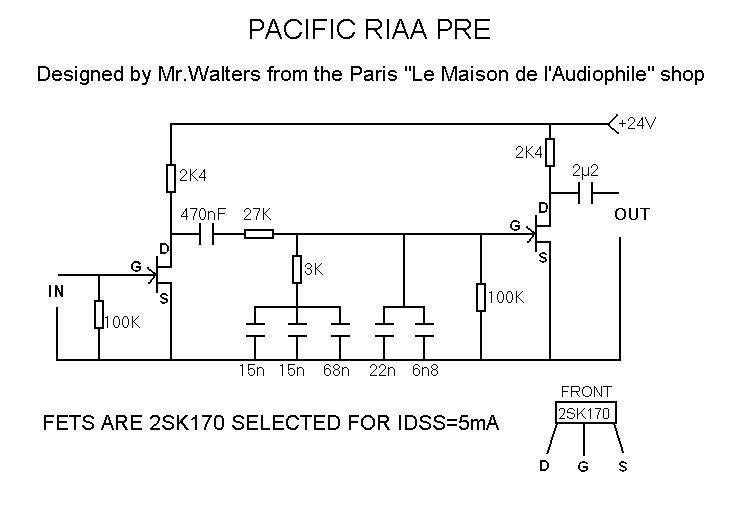

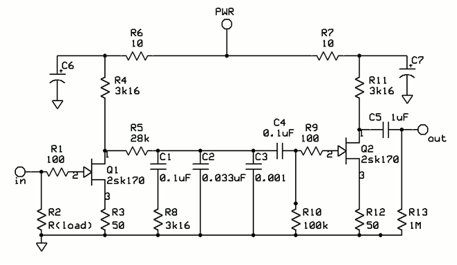

3 Watt Wire-wounds !!!
Bog standard £0.40p + VAT each ( thereabouts ).
Can't easily get 'em at say 47K though.
Could consider 'thick-film' non-inductive planar, for cartridge load ( 47K ).
I think as you say 'L' Pacific' ie. Boozehound, doesn't have a 100R, on input; I don't think you realy need it; if you must...wire-wound 0.1% precision non-inductive.
Good to have the resistors above the JFETS as chunky wire-wounds as well...dead stable.
Save all that dough on fancy name strippy-things...
...and made a DECENT power-supply !...
...you'll need it.
You'll never fully realise the full qualitys of the hyper-minimal 'L' Pacific' without a top-notch PSU...and I do mean top-notch.
Do get a decent wire-wound for the high-value resistor ( about 27K, I think ) in series, before the Passive EQ section.
Matching per position & per channel helps on this design alot.
Don't worry if your wire-wounds are say 5% tolerance...get a bunch...they're cheap...and match them out per channel & per position...
...they'll never go off in this apllication ( no heat / current )...
...as noise-free as it gets...
...as quiet as a grave.
Let the caps you like do 'the sonic thang'...
...and mix and match a few around, on the interstage & output positions...tolerance not that critical here.
Measure the caps on the EQ section...& try and match them if you can ( as the resistors, here ); by adding an apropriate small value polystyrene or silver-mica across them to match the values.
( if you have a C meter that is ).

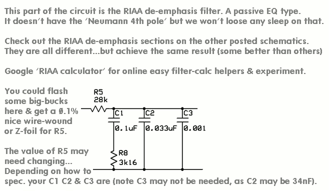

Another good thing to do is to go on-line to 'an RIAA calculator' page, & follow the instructions there; input your known resistor value etc....
...and easily calculate the spot-on cap & R values for the RIAA deemphasis...
...the Boozehound / 'L' Pacific's are only an aproximation here...
...match it yourself & per channel &...BINGO....super-wide detailed soundstage.
Good luck.

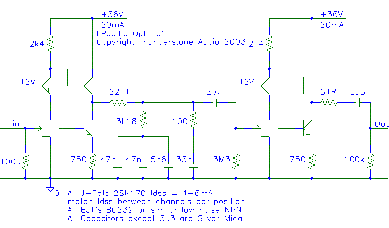

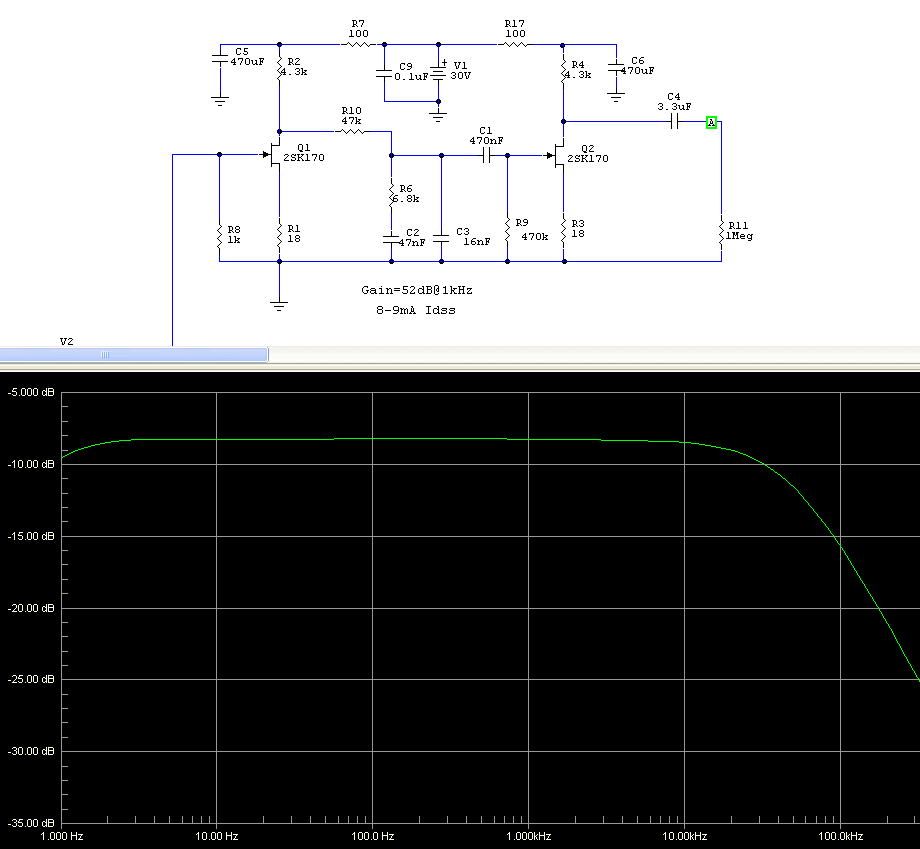

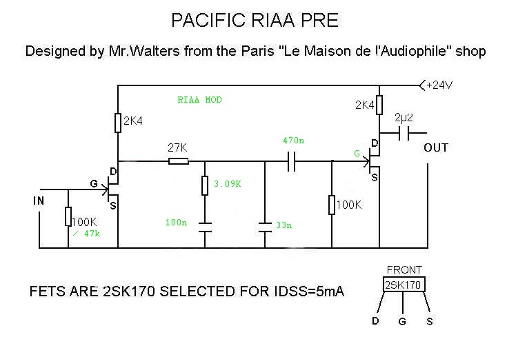

Hi again Audio Mind !
Also...
...check out these 2 threads here on diyAudio ( sorry no links, use search )
Member Mad_K :- " Mad_K's 'L' Pacific' "
A good few pages ( but not TOO long ), a few people build it, tweek it, get the most performance out of it ( pre-Boozehound era. ).
Exellent thread...you will know EVERY worthwhile aspect of this hyper-minimalist design after reading this one...
...WELL worth-it !!!
Also...
Member Thorsten Loesch's thread :- " 'L' Pacific Optime ".
Mods this time; on the original.
Bumps up the VOLTS and the transistor count of the original.
But worth reading to see where you can take it if you wish.
Another good read from the pre Boozehound era.
One issuse that is common...
...I think Boozehound may have tweeked the gain a bit to stop this .....but...
Sometimes with high-output MM carts... the gain from the first stage is too high...
...and can overload the 2nd stage JFET....which likes not much more than about 300mV.
I think Boozehound have reduced the gain a tad to avoid this.
The original & the Thorsten Loesch version by the way, use the GR suffix version of the 2SK170 JFET; the Boozehound uses the BL suffix of this JFET ( I think / assume ). GR suffix not as easy to get hold of, but possible though.
GR = about 4-5 Idss
BL = about 7-9 Idss
V = higher than 10 probably
Fantastic little pre-amp.
Who needs more than 2 transistors ?
Well I'd have 4 myself ....but 'L' Pacific' does just Hunky Dory with TWO !
Cheers
Si.

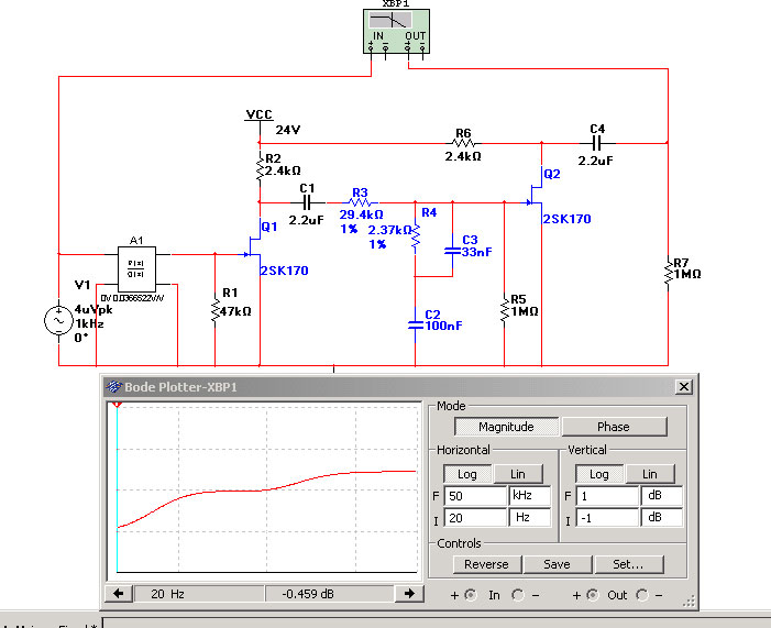

Whew..a simple pre done right can be quite complicated! Have to search a little harder for the thread recommened. Si you mentioned the need for a real good psu. Was thinking of using a discrete regulation, a buddy told me to look in to the Salas shunt type. People who have heard both 3 pin chip and discrete voltage unanimously say the discrete is superior in sound quality and noise. Back to resistors I was wondering about tantalums in a low voltage low current solid state design such as this. Tube guys seem to like them but i wonder if it would be better to stick to metal films and wire wounds?

PS will post some schematics...
...most people who make this basic design only have 1 series resistor...
...Boozehound have thrown in an extra 2 that you could possibly do without.
Some schematics coming up.
Boozehound Break-Down Part 1 - JFET psu & gain control...
Hi again A M
Just another thought...
...This circuit is one that pays dividends...through experimentation...so...
Buying in costly & fancy parts from the get-go...might well back-fire...
...and you end up finding they need value changes to optimise.😱
The gain resistors, for example, can be replaced with a fixed value...later...
...But in the mean while, a 5K 20 turn mini-pot would be a smart move !🙄
Measure & set it to the schematic value to begin with...
...can optimise later...depending on cartridge output & JFET current draw.😎
A good thing to do first off as well...is measure the current draw of your JFETS to see if they are any good...ie well matched...if not 😡...you might want to get some more & test them as well.
About 99% more important than a $1M resistor !
Si.

My $25 000 000 phono-pre with 0.01% accurate RIAA equaliser ( yeah...right ! )
Here's the RIAA equaliser section.
A million-dollar series resistor...😱
Capacitors ( need to measure them ) 😕
Could be...
PIO
Teflon
Polypropylene
Values can be 'bumped-up' to the desired value by soldering small value...
Polystyrene ( NOT 'syroflex' TM ( TRASH ))
or
Silver Mica...
...across the main big capacitor.
Tip Here...😛
...measure the big ones first ( optimise with online RIAA calculator )...
...then order your Polystyrene or Silver Mica's in whatever smal pF or small nF values are needed to make up the correct value.
Si.

Yes...
...Mr Walter's original 'L' Pacific' is VERY minimalist.
Less resistors = Less NOISE...
...whether in practice, rather than theory, you will notice this is another matter...
...well worth bearing in MIND though.
As you see...
...the 100R series & the ones from JFET's to ground are not in the original...
...However...
...The ones from JFET's to ground could be a good move...
...I would loosen the purse-strings here and spend $0.50c on a pair of 100R 3watt 5% wire-wounds, for least theoretical circuit noise & super theoretical stability.
5% tolerance is fine...not a critical value really...Match per position per channel if possible though.
Just to say you did it, if nothing else !
Conrad Johnson...eat yer heart out !
Si.

As you see...
...However...
Si.
Another EQ scheme coming up...
...this time a ZERO CAPACITOR option...Very Expensive...Very 'Audiophile'

I don't mind adding the resistor to ground off the jfet if needed.
You mentioned a zero capacitor design, does it use a +- supply? I would like to see that schematic.
