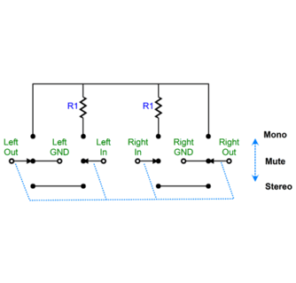

I am wiring up a phono stage and want to add this mono/stereo switch.
There is a place for two resistors. Suggestions for resistor values (or how to calculate)?

A rotary switch for phono playback that presents three positions: mono, mute, and stereo.

A mono/stereo switch in a preamp could in some cases be simply a SPDT which either connects the two channels at a suitable point or not. It was unclear to me why someone might need a separate PCB for such a trivial role. The fact that it is a phono preamp tells us nothing much at all.
In this case it appears to be a more complicated setup meant to go after a preamp. The resistors are just there to avoid shorting the output - although a good design of preamp would probably already incorporate these internally. The value is not too critical: a little higher than the output impedance, a lot lower than the load impedance. The type does not matter too much; by design they do not do very much so they cannot do much harm either.

They should be high enough to "not hurt" the sound when in action. Your plan shows opamps with 47r resistor build-out; we can pencil this as 48 Ohms. However depending on the opamp it may not drive large level into 2k or 300r without rising THD or outright clipping.
The worst-case is out-of-phase L and R signals; however this is a rare event (sounds funny on most speakers; however this may be the case where mono is better).
The LOAD matters too. If you have one of those low-low-Z power amps with 1K input (there are a few) then 1K in series significantly hurts level. OTOH a 500K input hardly cares.
Taking an assumption that the preamp can drive 1K fine, and the power amp or line amp is 20k or more, 1k is a fine value. But if your preferred toasted-poppy-stem or OF-Zircon resistors only come in 789r or 1.567k, that will do too. If I had an overstock of 1k3 5% carbon-film, that's what I'd use.

Still don´t know the circuit schematic but guessing the MONO position links both Op Amp outputs together and amplifier has 50k input impedance, an excellent compromise is using 2 x 4k7 resistors.

Yes, don't use carbon comp. When I said that type does not matter too much I meant you could choose any decent resistor type - not CC! A few hundred ohms will be about right; it is only there to avoid damaging a poorly-designed preamp.
The ones installed on the image appear to be Brown-Black-Black-Red-Brown so 10k 1%?
In Mute, the switch is open circuit Lin//Lout & Rin//Rout
In Stereo, the switch is closed Lin=Lout & Rin=Rout
In Mono, the resistors are connected Lin=R1=Lout=Rout=R1=Rin

But assuming 10k, and 50k amps, in Mono the signal level drops 1.6dB. Enough to notice. I would tend to a smaller value.

Most opamps can drive 2k without struggling and rising distortion, so two 2k2 resistors sounds about right, and is low enough to keep noise under reasonable control.
