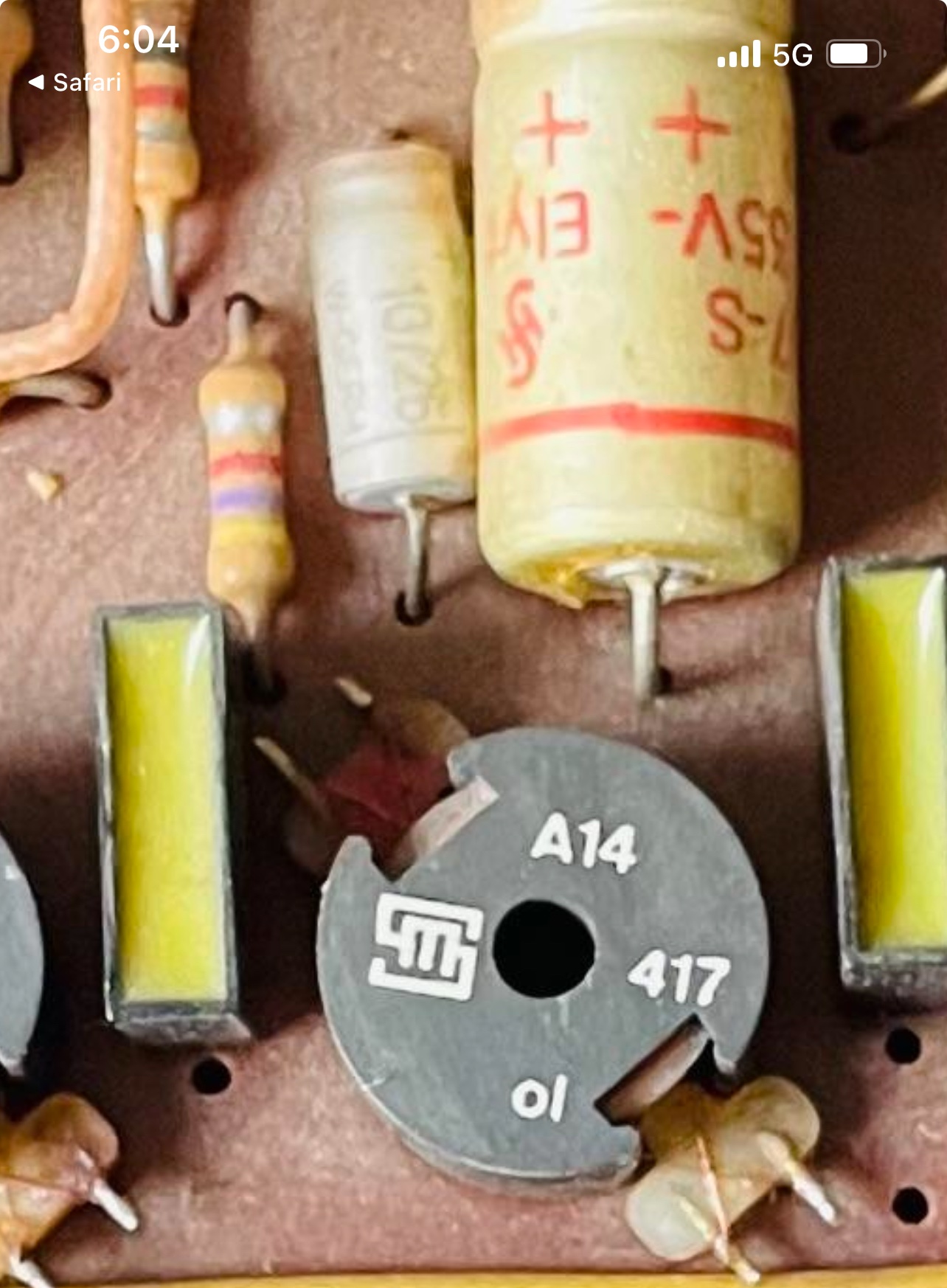

The saturable reactors in the device are two-winding P14/8 pot core transformers:
Someone else measured these saturable reactors; the power winding (the “in circuit” winding) is 2.2mH with a DCR of 65 ohms. The schematic itself does not denote the inductance; all it states is that the total resistance of the power windings in series is 800 ohms (800/18 =~ 44 ohms each).

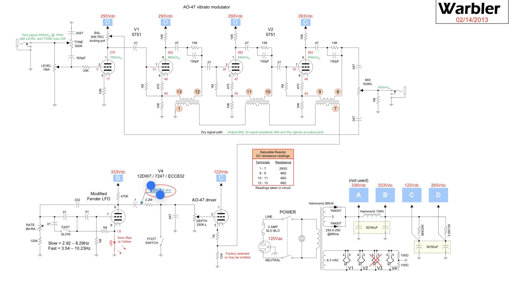

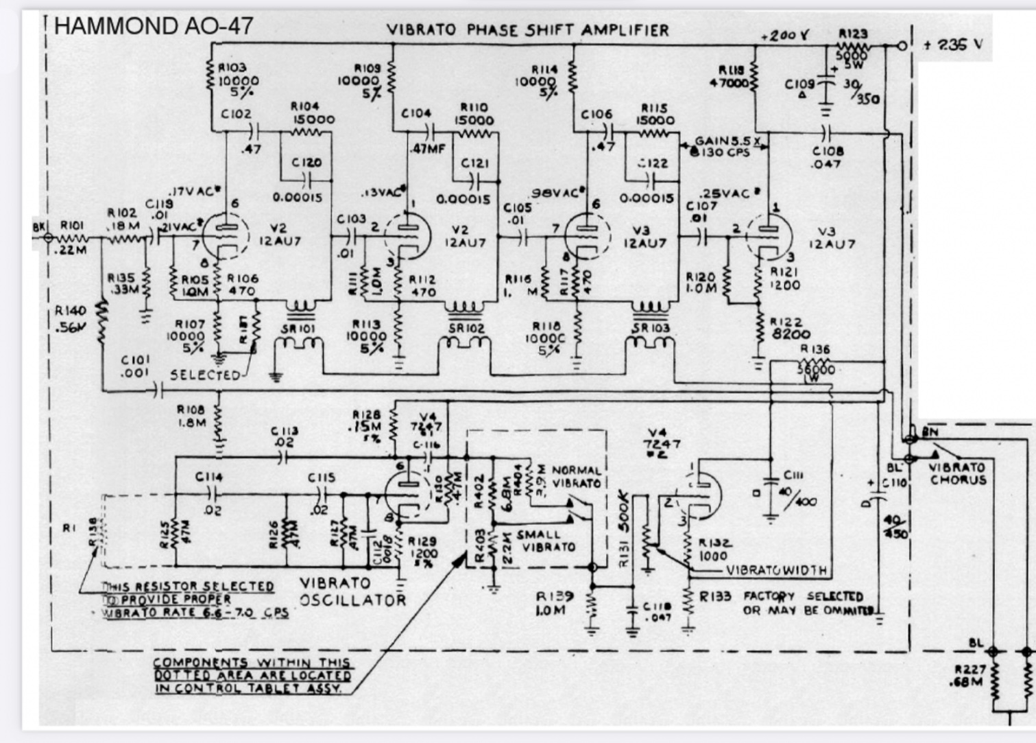

For contrast, here is the schematic to one of the Hammond units from which I have salvaged a pair of saturable reactors:
