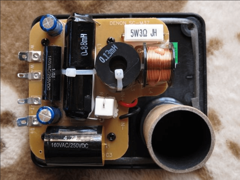

Hey guys, wonder if you can help a newbie here. My first post, so please be gentle.
Speaker : Denon SC-M37
Type : Ported
Impedance : 6 ohm
Nominal / Max input : 60 / 120W
Problem : Muffled bass with no treble (tweeter seems bad)

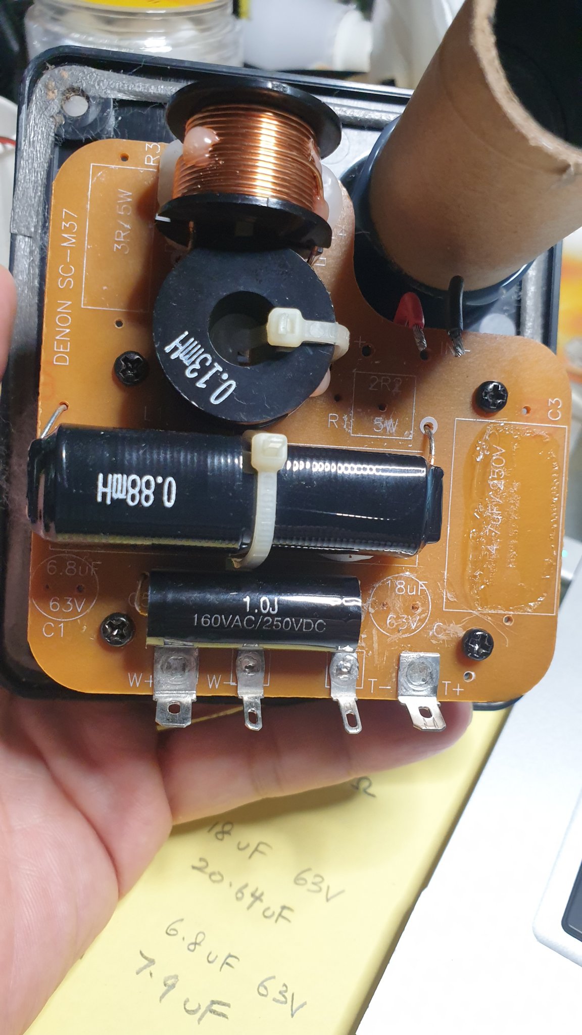

So I investigated a little, took out the crossover parts for measurement and got the following results :
Resistor 1
Rated 5W 2R2
Measured 2.82 ohms
Overall : 0.62 ohm increase or almost 1.3 times original value
Resistor 2
Rated 5W 3ohms
Measured 3.61 ohms
Overall : 0.61 ohm increase or 1.2 times original value
Electrolytic Cap 1
Rated 18uF 63V
Measured 20.64 uF
Overall : 2.64 uF increase or 1.15 times original value
Electrolytic Cap 2
Rated 6.8uF 63V
Measured 7.9 uF
Overall : 1.1 uF increase or 1.16 times original value
Barrel Cap (don't know the name for this type of caps!)
Rated 4.7 uF - 160VAC/250VDC
Measured 1.18 uF
Overall : 3.52 uF decrease or 0.25 times original value
I am unsure what type of tolerance makes these parts acceptable for use so am asking for your expert opinions on this. Thanks.

You should verify that tweeter is bad by attempting to measure dcr across its terminal, driver being out of the circuit.
Tweeter has been separated from circuit and measures 6.3 ohms.
Also did a measure on the woofer and it comes up to 5.5 ohms.
Short your capacitors before measuring or re-measuring them.
Yup. Did that before taking measurements.

4.7 uF seems well out of spec.
Possibly if the tweeter uses ferrofluid and it ten years or older maybe the ferrofluid has dried out or thickened reducing tweeter output, I take it both speakers have very little treble output?
Yes Indeed! Both speakers have the same problem. Very little to no treble output. Ferrofluid in tweeters is a first for me. Is it replaceable or am I better off replacing the tweeters?
Do you think changing the 4.7uF cap will likely solve the issue? What alternatives do I have when it comes to capacitor selection for tweeters? Your input is much appreciated. Thank you.
Replacing the 4.7uf is an unknown in terms of it fixing the tweeter problem.
We do not have a circuit diagram to work with. But, if in fact the original 4.7uf (now 1.18uF ) is the first capacitor in the tweeter circuit it could explain the loss of level.
Do you have any sound from the tweeters, do you get a crackle as you momentarily connect a 1.5V battery across their terminals ?
If the tweeters actually produce a crackle you can either trace out the circuit diagram for us to look at or go and buy a pair of polypropylene 4.7uF and give it a try.
If funds are short it would be better to try and trace the circuit to allow a better understanding of where each component is used.

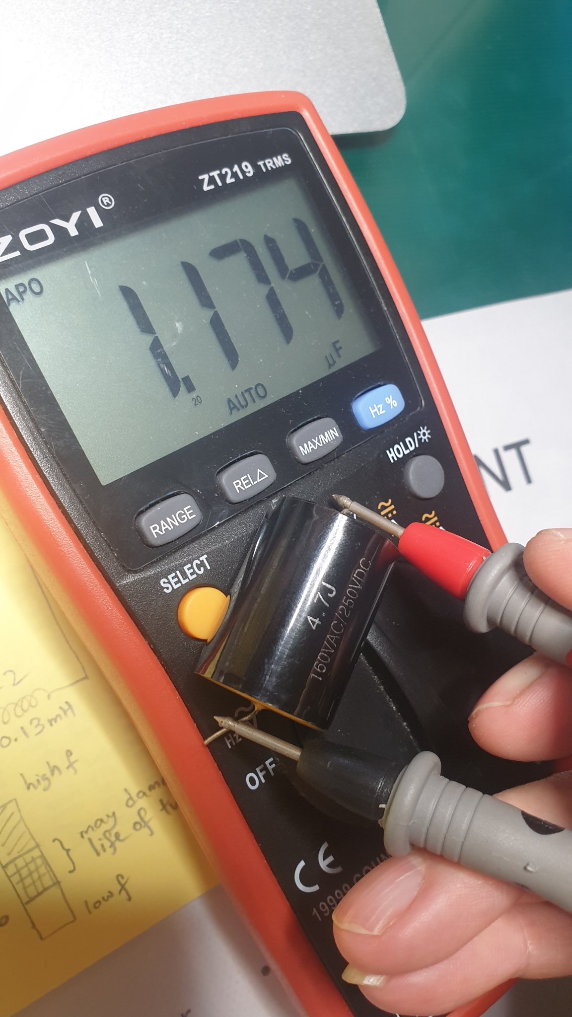

What is really strange is that the bigger 4.7 uF cap seem to have a capacitance way off its nominal value. Film caps are very stable, so my first thought is an error in measurement. Are you sure your multimeter measures correctly?

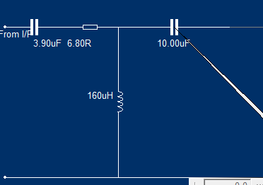

Just took a crash course in learning how to use a circuit diagram drawing program. I'm not 100% sure of the correctness of what I drew but this is what I've got after using my multimeter to trace the connections. The 4.7uF cap is labelled as C1 in the diagram.
Also, I've attached a pic of the film cap measurement. Am I doing anything wrong here?
As for the multimeter resistance, Allen is absolutely right! It measures 0.6 ohms which makes the cement resistors spot-on in values.

Good that you are trying to fix this yourself.
The circuit diagram is taking some, understanding, but that could be I just need a bit longer to decode it.
Maybe you can break it down to individual circuits, for bass and treble. Even though they probably both share the same negative part of the circuit.
For the bass i would expect your biggest inductor possibly the 0.8mH in series, and maybe a Capacitor with resistor in the shunt leg, . You have drawn a capacitor, inductor resistor, which also works and may provide a bit of a frequency notch as well, So i think the lower LHS block of your drawing is probably correct, for the woofer.
The tweeter leg shows a resistor, followed by the capacitor, followed by another paralleled pair of capacitors, which is strange.
Something less strange would be a shunt inductor between the two, which would make it a third order crossover to the tweeter. eg resistor followed by 4.7 uf capacitor followed by a shunt inductor, followed by the two capacitors going to the tweeter.

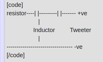

resistor----| |---------| |------- +ve
Inductor Tweeter
--------------------------------- -ve
I have just tried to save the drawing for you, but unfortunately it removes the spaces. The inductor fits between the two capacitors, if that makes sense
The inductor is connected between positive and negative, I just couldn't draw it easily with the keyboard
The crossover you are showing doesn't make much sense. There at least two things that reveal it can't be correct:
1) a cap in series with a two paralleled caps - in your case this is equivalent to a single cap with a capacitance of 2.93 uF. This value is not standard, but can be easily obtained paralleling 2.7 and 0.22 uF caps, and doing this way will cost far less than with the 4.7, 6.8 and 1.0 uF caps
2) the L2 inductor can't be in both woofer and tweeter circuits
Time to retrace the crossover. BTW you don't need a multimeter, only your eyes in following what is the first component after the + input, then what follows, keeping an eye when there are two components after one (a node).
As for the 4.7 uF cap, if your multimeter measures it more or less at 1 uF, then there are only two options:
1) the meter doesn't work correctly - measure something else that you know for sure, for example a never used cap
2) you removed the cap using too much heat, which partially destroyed the cap

You may prefer the toolbar option on the wysiwyg post editor, it gives you a box with a monospace font in which to draft it. Just click the 3 dots beside the underline button. Or, if you're like me and stay in tag mode then use the tags.
By the way, the toolbar goes away in tag mode but that's listed for a future fix.
