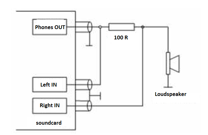

I've got an old pair of Niles MP650 in-wall speakers and was wondering if I could put them into an enclosure to make some book shelf speakers? I've read a few posts on various sites that say they would sound horrible because that was not their intended purpose. I was curious if anyone has had success doing this? is there a formula that could be used to determine enclosure dimensions? Any ideas or suggestions would be appreciated.

Certainly, it can be made to work properly in an enclosure. You should download a free and great software measurement suite from ARTA labs and within LIMP module measure impedance and TS parameters, then load these to a box simulation program which already has implemented formula to calculate needed volume for a certain cut-off frequency. You'll need a soundcard to do that measurement. After that share the findings with us. It's an easy job. We can talk about the sound once it is in the cabinet for then it will be obvious if any modifications will be needed. Usually when you change from an in-wall system to an enclosure design, the baffle step reinforcement of the frequencies will make midrange band somewhat louder and if that will be the case, we will worry about it then.
