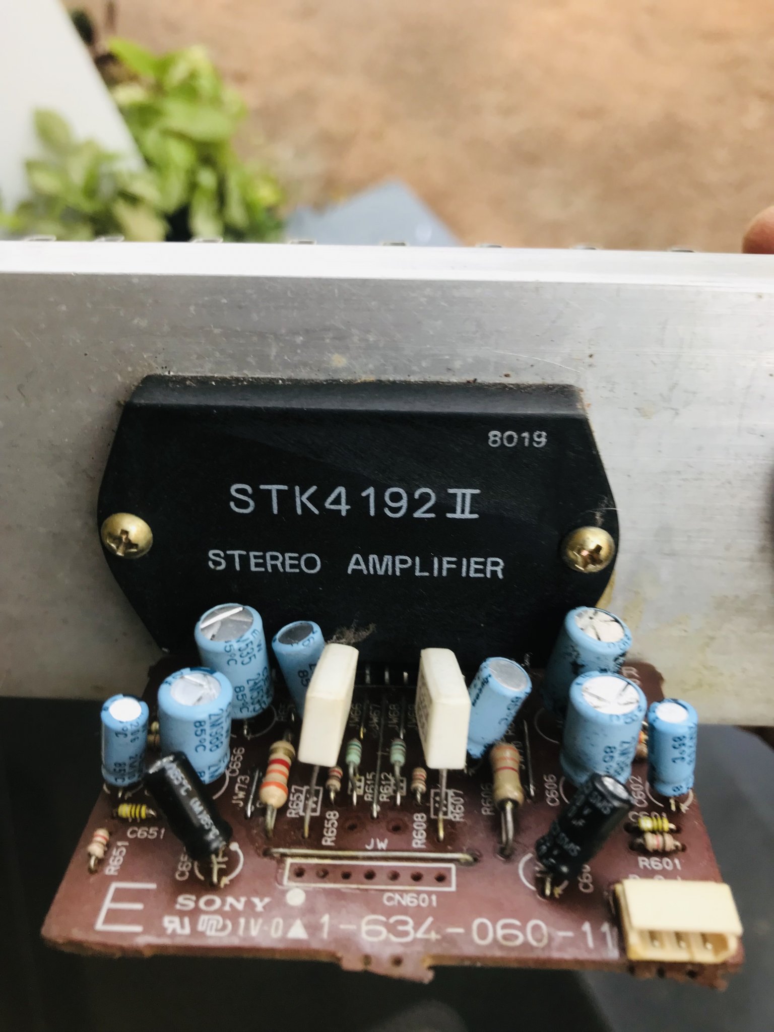

Hi, recently my sony str av320 receivers' speakers were not outputting anything, and protect mode was turned on, so I checked the mainboard and one current detection transistor in the protection section was faulty. Do I replaced it and the protect mode was gone, but still no sound from the speakers. So it looks like the power amplifier chip which it uses ie STK 4192II was no more working.
When I checked locally there are no original ones available now, and all of them in the market were low-quality Chinese clones.
I was looking for a replacement power amp that has a low THD and good performance, can you guys please help me find one?

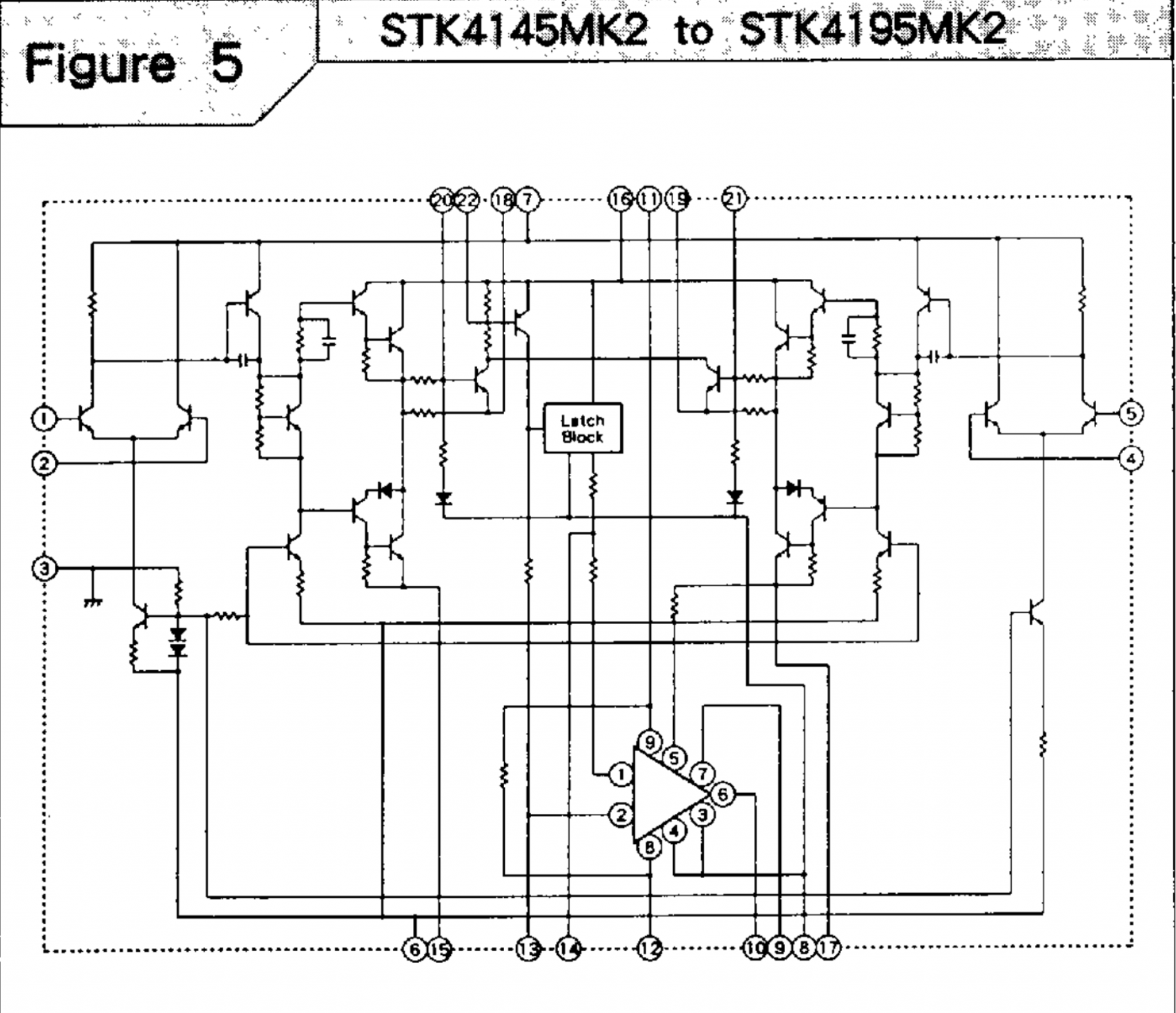

STK 4192II is specified as 50+50W, Max. +/- 52.5 V, for 8 Ohms: +/- 35.0V, and for 4 Ohms : +/- 31.0 V
Sony would have been using +/- 27 V or so... so 1875 / 3875 / 3886 can be used, or Mosfet kits.

I think you realize you can´t just fit a 7294 there (just checking) but you are lucky your STK is mounted on its own board, so you can fully dispose of it and bolt a new amp board to existing heatsink.

I did a quick research and hope my stks are not down but something else went wrong. The basic diagnostic of the chip went well. Lemme check the otputs directly from the power amplifier module.

Thanks for the detailed info @NareshBrd. However the issue was not stk chip, it was the faulty connectors to the speaker selection boards and faulty speaker selction switches. I replaced them and now its working like a charm.Oh, if you want a complete amp also there are 80W Mosfet amps sold for 4500 - $60 - range here, with the usual FM/USB/Bluetooth kit.
