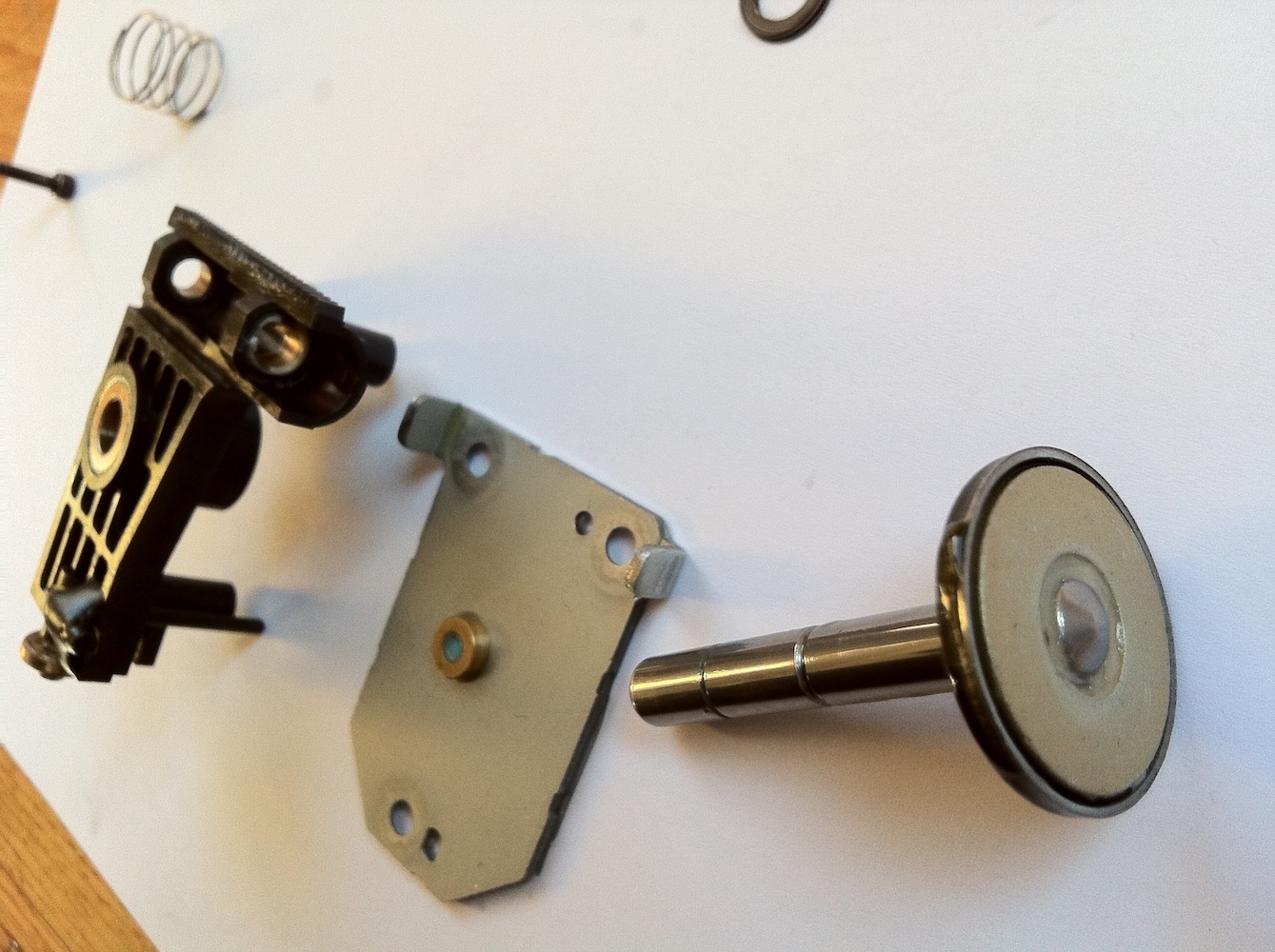

Replacing a Brushed Motor with a Brushless Motor - Advice needed.
In many, many traverse mechanisms, this motor is used as a spindle motor:
RF-300FA
Used in Sony, Philips, Sanyo Mechanisms.
A cheapo, i. e not suitable for heavy clamps. At least not durable
for decades. (For years, yes)
As far as i know, brushless motors are more reliable and sturdy. Never seen one with shafts thinner than 3mm. They were always the first
choice in first CD-Players and also first generation ROM drives before the companies cut corners.
Replacing a brushed motor with a brushless is not an easy task.
But I would like to give it a try.

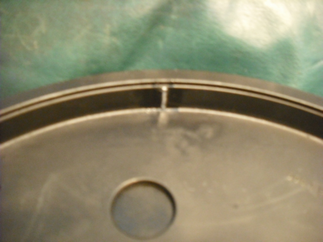

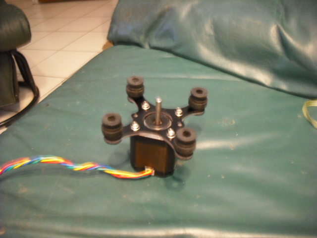

I just finished replacing the worn out motor of my Garrard 35 and it is in a beta test right now. After tried some different motors I decided to see if I can replace it using a stepper motor and a micro. I am using a reflecting sensor, a small reflecting metal strip glued to the platen as a marker and an stepper motor. Used the micro to read the index marker every time the platen do a revolution and calculate the rpm of the platen and display it. Mounting it a bracket used to mount a camera in a Drone Helicopter. I used it to eliminated any vibration coming from the stepper motor. At beginning since the spindle was about 1/4 inches the stepper motor was whining due the high frequency 1000 kHz. Replacing the spindle with a larger pulley I was able to dropped the frequency to 622 KHZ and the whining when away. Now the system it is running very good and it is easy to implement it in any turntable. Attached are some pictures showing the implementation. The only problem it is that you need to know how to program the micro. The software it is in basic using the Zbasic micro. Total cost of the project it is about $75 dollars.

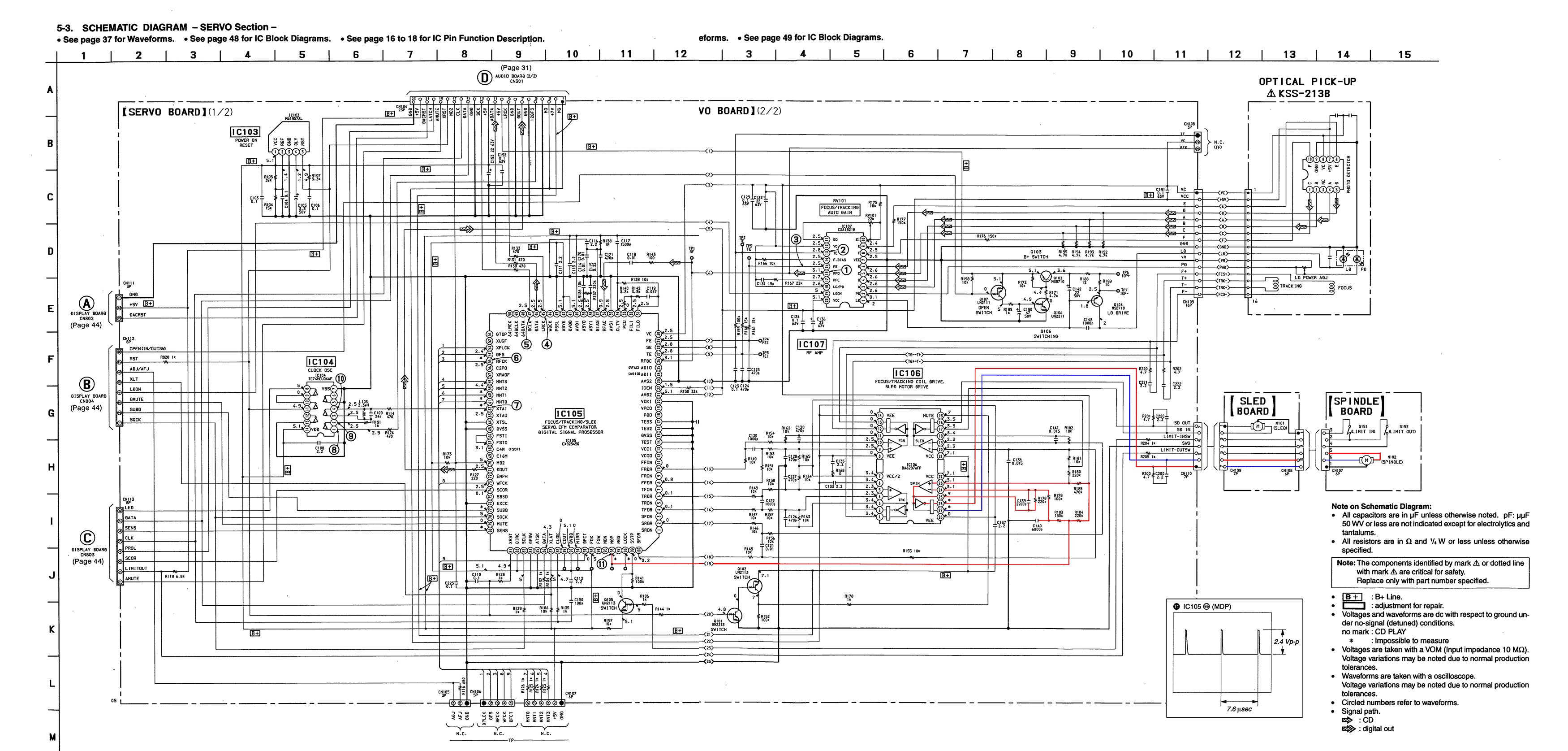

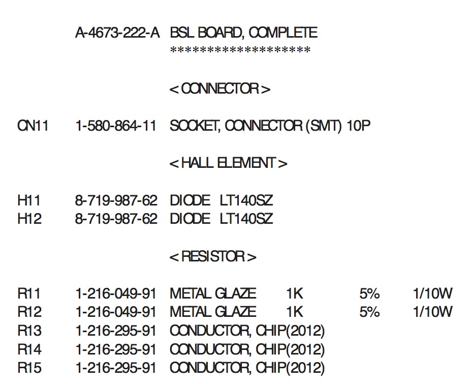

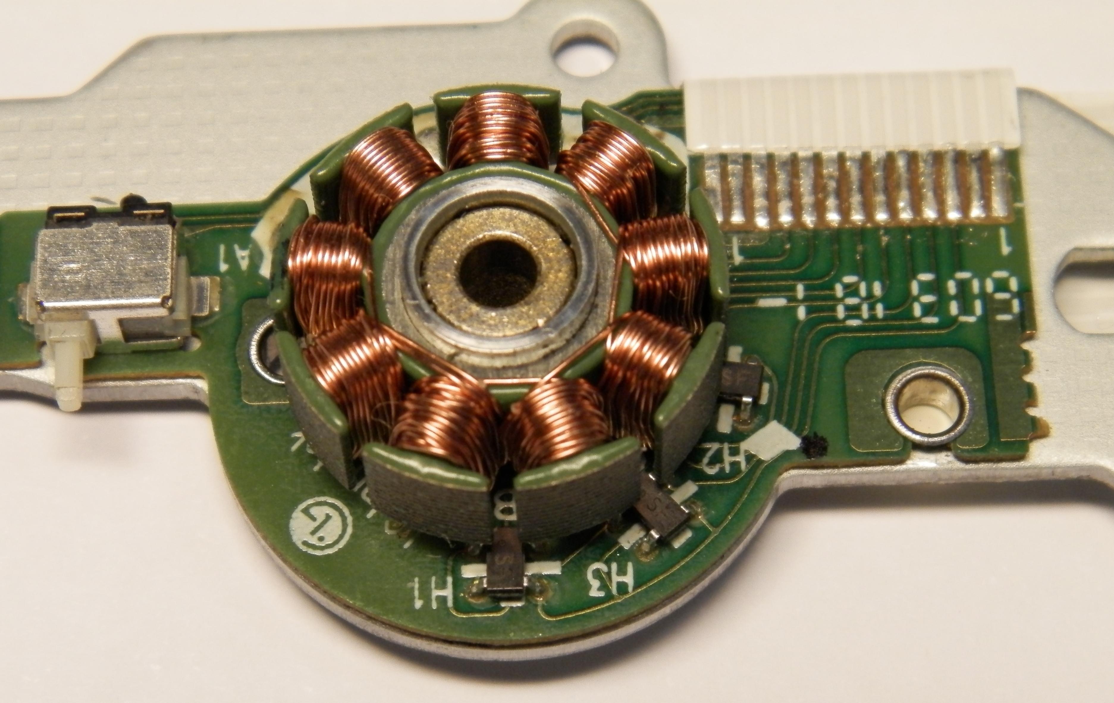

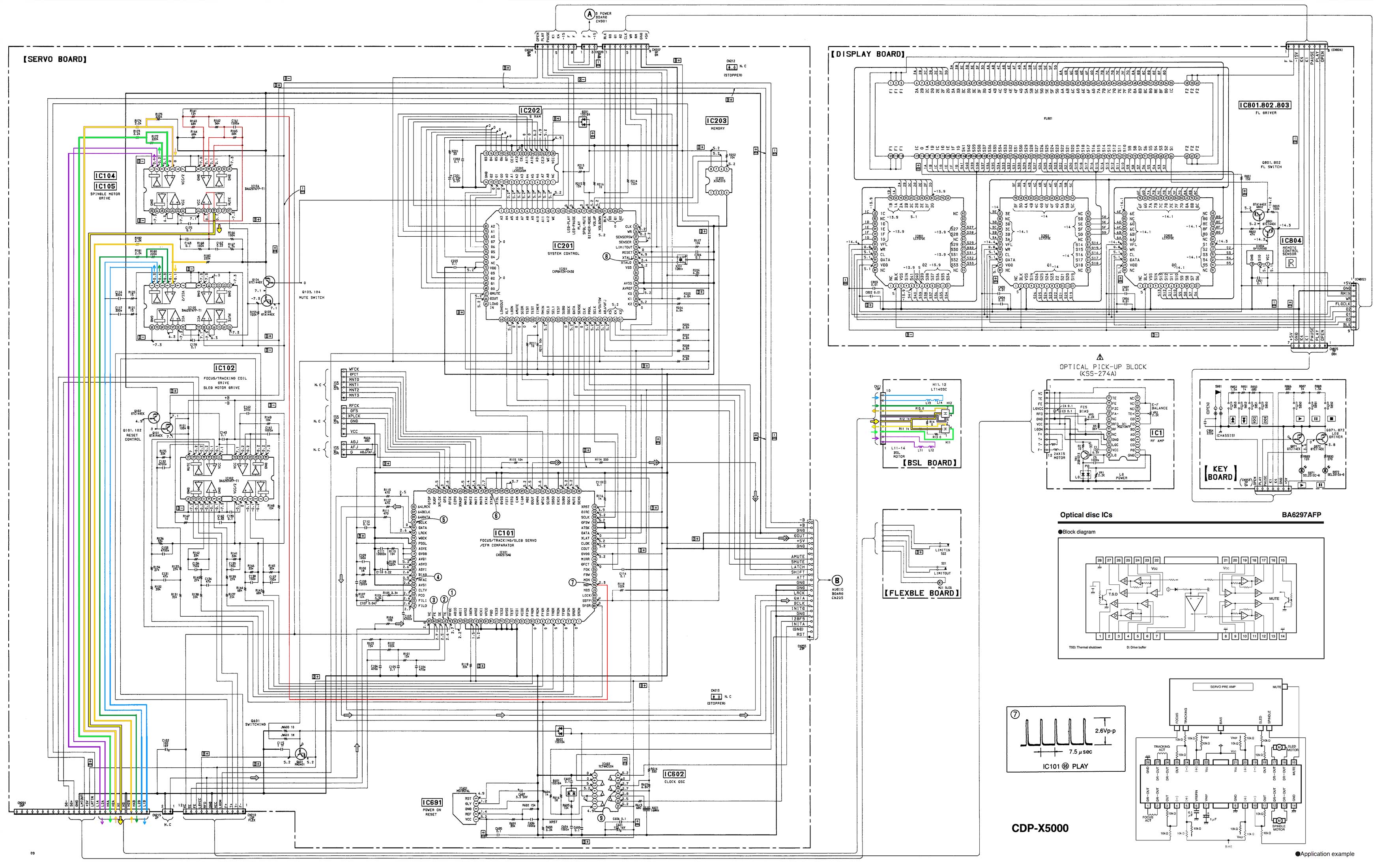

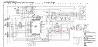

I made a comparison between the Sony CDP-X5000 and CDP-X3000.
The X5000 uses a brushless spindle motor, the X3000 a brushed one.
Could anyone explain the differences in the circuitry? The used almost the same IC´s. Hope I got the signal directions correct. I do not understand the
function of the hall elements LT140SZ. Unfortunately I did not find any datasheets...

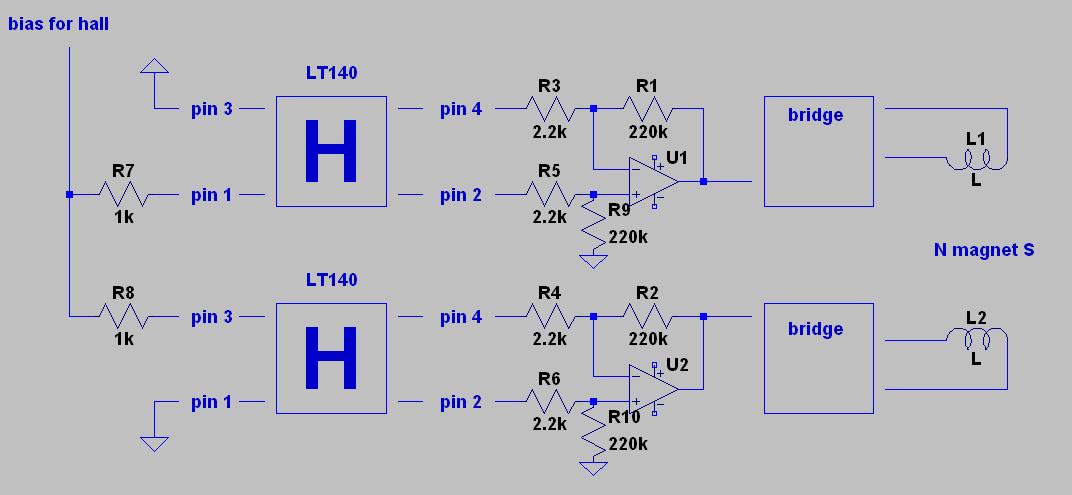

datasheetcatalog.com sharp LT140 data is available
Hall elements sensing position of spindel magnet and circuit switches between coils. Whole motor circuit is too complicated to copy.
Better option is to use one IC solution.

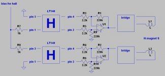

Yes, 5000.
I tried to explain,but.. as I see circuit.
My scetch is only about power stage of spindel motor.
Look inner stages of BA6297. There is H-bridge output.

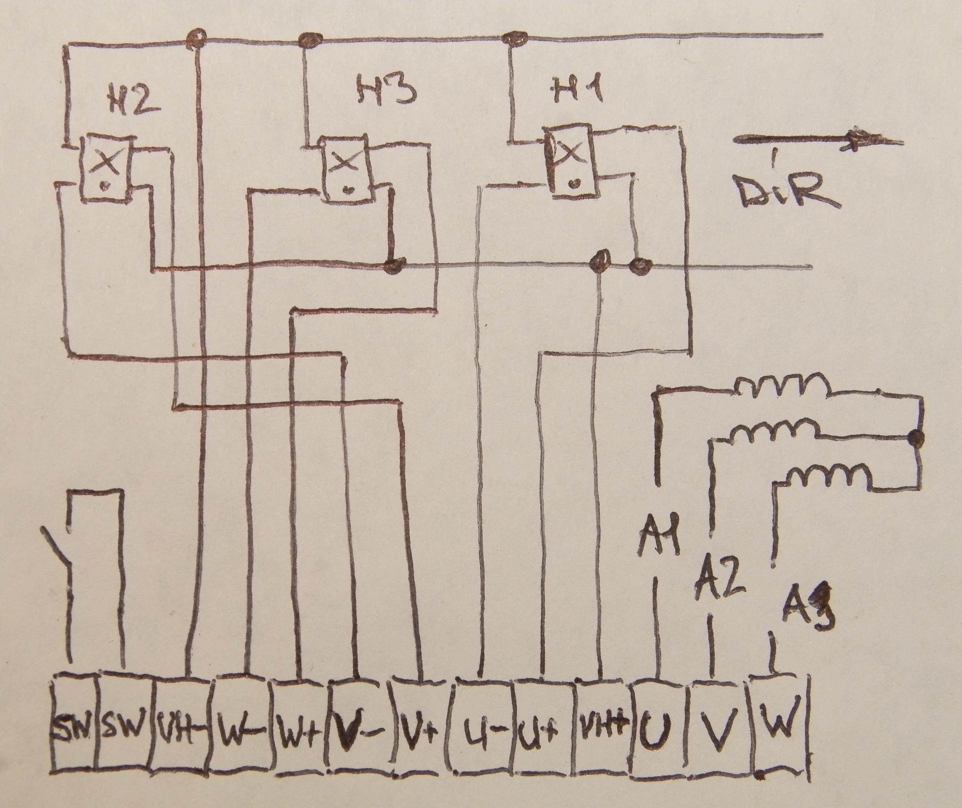

I'm playing with a three-phase BLDC from old dvd rom.
You intend to use motor from 5000 ?

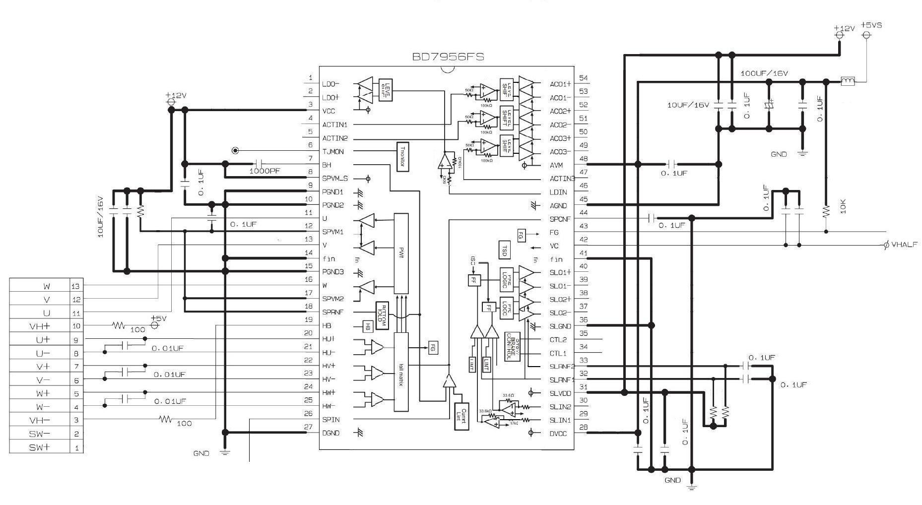

Hello artegagt,
with bridge you mean the driver buffer @outputs 1/2 I guess?
I also have some CD-Rom brushless Motors to play with but the goal is to find a
brushless replacement for common circuitries used today. Again, the Mabuchi RF-300 Motor is used in spindle drives of many players. Here is one example
of a very common servoboard used in many Players from small manufacturers. It can be used with Sanyo and Sony mechanisms, both have RF-300 Motor. Also the Philips CD-Pro2 uses RF-300 and I assume, also the Shigaclones...
