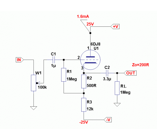

I've got a surplus stash of 6GM8 / ECC86 tubes and thought a re-working of the attached circuit might make a decent junk box linestage.
Can anyone assist with changing resistor & capacitor values if we were to have 24vDC B+ and 6.3v DC H+?

Clever change to the Aikido circuit but it's never going to get to a unity gain like the circuit in post #4 above? Ideally this circuit (below again for ease of reference) could simply have a 6GM8 / ECC86 subbed in without any changes?
