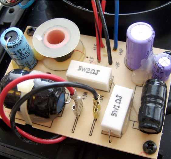

Hey, thanks for your help so far.
It seems the problem is not with the tweeter itself. I swapped tweeters, and the working tweater on the problematic speaker was still having issues (sounded muffled/garbled, fading in and out). Must be something with the electronics in the speaker itself. Bad capacitor, maybe?
I swapped the left and right lines, so it's not something in the receiver.
Just need to figure out how to get the rest of the speaker disassembled...
You would have great difficulty replacing this tweeter, as the way it was designed was to mate specifically from the rear into the back of the baffle molding. It was also quite high sensitivity, again making it difficult to find a match. I should know...I designed it...
Anyway, from your investigations it would seem that it is not the tweeter that is at fault. It could well be one of the capacitors in the xover. You should try getting spare capacitors and put them in parallel with each existing capacitor in turn to see if the signal returns.
