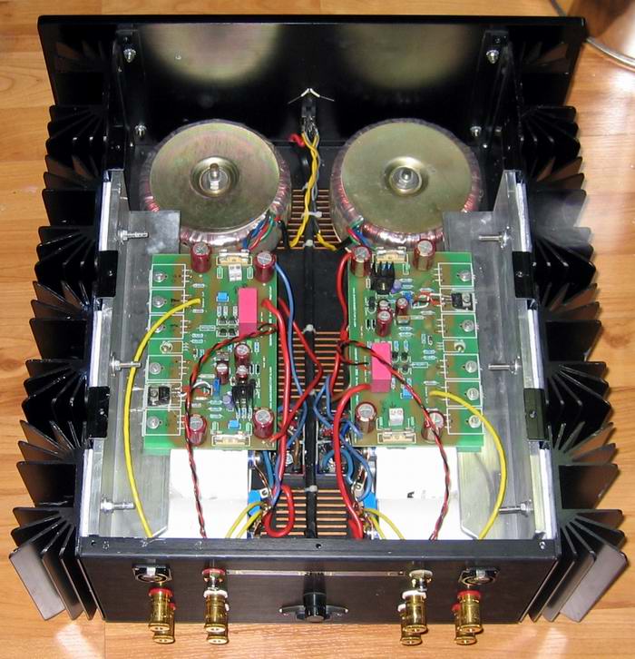

You might have a slight problem replacing the IRF610 in the phase splitter with a 630 due to increased gate capacitances of the IRF630. I doubt it would be anything serious, perhaps a somewhat higher THD at HF, as it's really only Cgd that counts here (as millet cap) because Cgs is largely compensated by the gm of the 630 being about as much higher as the Cgs compared to the 610.
I do have some reservations about some things in that amp. For starters, so the drain resistors of the bottom bank of MOSFETs actually do anything useful? Seems to me they should be in the sources, not drains. The 330 ohm series ressitor in the gate circuit of the bottom bank is also slightly odd, and the bias current source using a modified Maida regulator is bit on the complex side 🙂
N-Channel
Mine is in everyday use (24/7)
Arne K

richie00boy said:
I did wonder about the bottom MOSFETs and their resistors myself, it just doesn't add up for thermal stability as the stage is operating in a completely different way to the usual CFP trick where a faked p-channel is made. However, I think some people have built the amp and it didn't blow up?
I did not imply it was thermally unstable, just that the resistors in the drains of the bottom bak do not contribute any to thermal stability, what ever it is.
Thanks! And about the 2SC3289 -> 2SC4159, is that allright?
As I read somewhere, the 0.33 resistors were not in the design initially, but they were added later to make sure the IRFP240 equally share the load/current.
experience...
It had a tough birth...It did not like +/- 75V and a tough load...
So I changed to dual 38v ac (+/- 60-65V) 650va trafos, 4 x 22000uF Rifa pr channel, and a THICK cooling-angle.
- All components are hand-matched...
It sounds very good, I have compared it to several amps, with new price up to over $ 8000 before it was surpassed...
That is performance that I'm happy with :cloud9:
Arne K

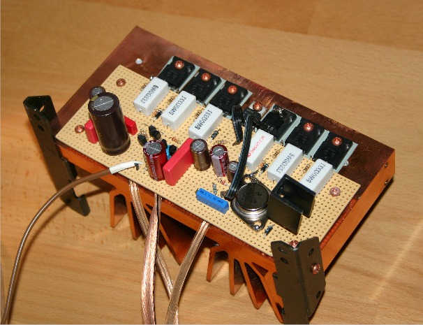

The n-channel Amp is finished and working (see attachement). I made a hard-wired version on a pertinax board. Apart from a hum problem the sound quality is very good: bass is very well controlled en midrange very very detailed and spatially accurate. Also the high midrange/high frequencies sounds very controlled, no rough edges, but to my taste slightly on the dark side. But allthough the amp hasn't been fully played in yet, I already noticed quite some improvements after an hour of listening.
My compliments to Anthony for the design.
I have a few final questions:
1. Does anyone have suggestions concerning my hum problems? I think I made a decent ground point, but I am not experienced in this field.
2. I'm having a not very slight DC at the output of the amp: around 100mV. What exactly is causing this? Can I remove it by placing a potmeter/adjusing a resistor value somewhere (for example in the preamp or phase splitter section)? And, if yes, would it be possible to remove the capacitors in the feedback part (C1 and E1) and still adjust the output DC voltage to zero?
