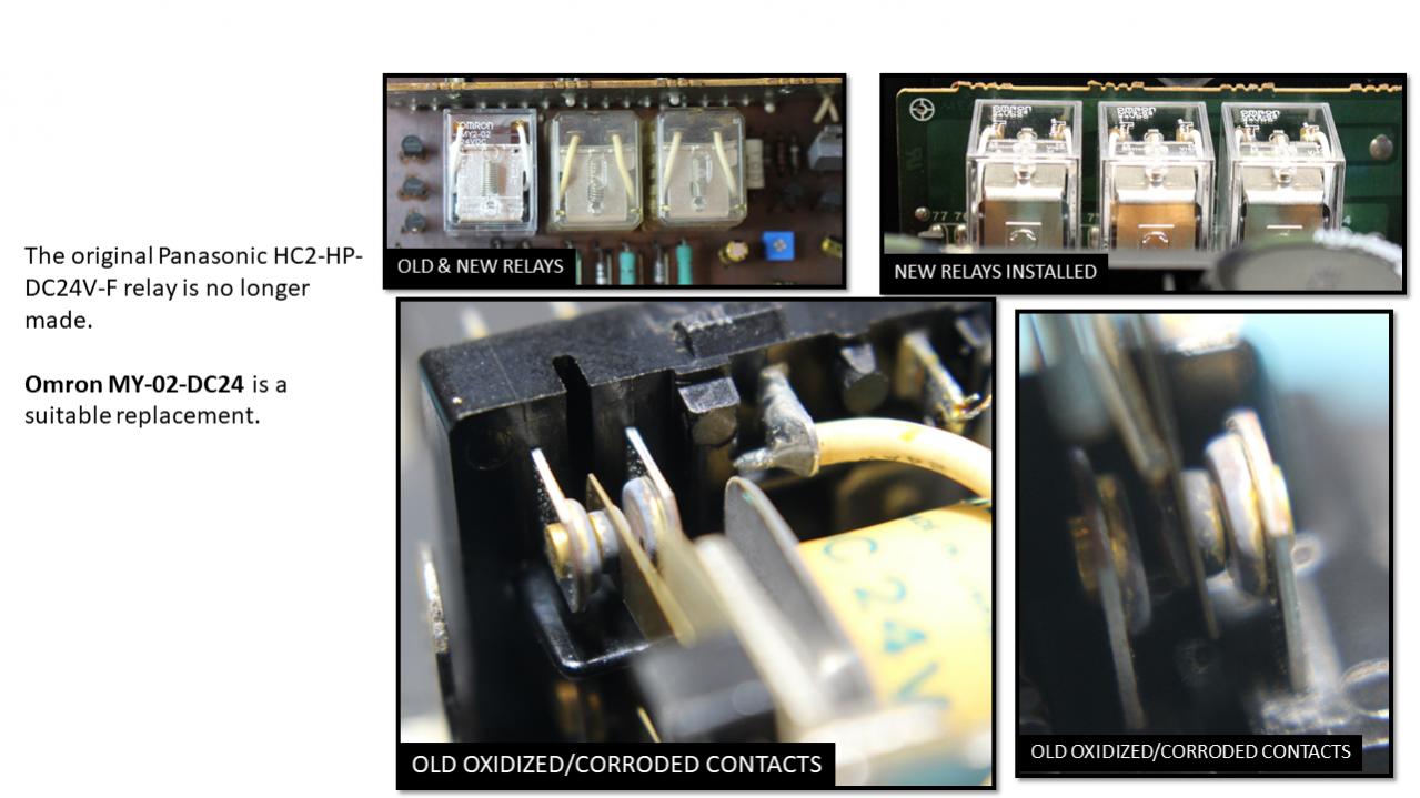

Hi MaccAu,
I know this is an old post but I came across it googling replacements for the Panasonic HC2 relay.
I believe Omron's MY2-02-DC24 would be a suitable replacement for it.
MY2-02-DC24 Omron Automation and Safety | Mouser
I am going to be ordering some for my SE-9060's and we'll see how it goes.
Figured I'd post here in case someone else was googling!
