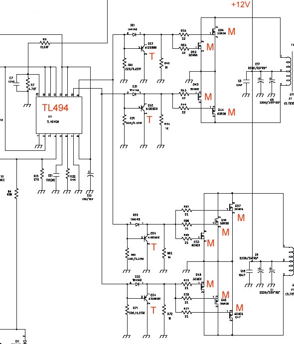

a question that i forgot: Is the Gate resistor ok with 22 Ohms?
See the attached pic for gate circuit details
:edit: picture removed at member's request
i see u got no driver transistors , the pnp transistor is there to forse the mosfet to shot down only . if u got 10 mosfets then u need a buffer between the pwm chip and the power transistors

So, in addition to the post with the picture:
I replaced the 1266 transistors with BC640 ( http://www.semiconductors.philips.com/acrobat_download/datasheets/BC636_638_640_5.pdf )
can that stay that way? are these ok for the job? 1266s are not available here.

I have built a few SMPS's and a car amp (200W, 500W) and that circuit is similar to the one I used.
I don't think 22R is too small. I used 100R and others use 47R. with the drivers I used in my schematic (www.djquan.angelcities.com/smps.html)the 220R resistors are 1k and gate resistors are 100R. the PNP transistors are 2N3906. I was able to drive three pairs of power mosfets for the 500W SMPS. the MOSFETS I used are 90A each(2 pairs for 200W amps, and 110A each(three pairs for 500W amp).
they are ok. just make sure the gate-source capacitance is not too large in comparison to the originals.

here's more from the psu:
M = mosfet, T= the blown transistors i replaced with BC639.

a buffer is the PNP transistor. it enables the output of the TL494 to drive the gates.
you don't need those since the circuit already has them.
are you sure te replacement has the same pinouts to the originals?
from what I know, 2SA transistors are ECB and BC series are CBE.
The BC 640 is a special one that has ECB. I had to do with it days ago and i remembered it had the Base on the side, so that was the first fitting trans. i had in mind.
