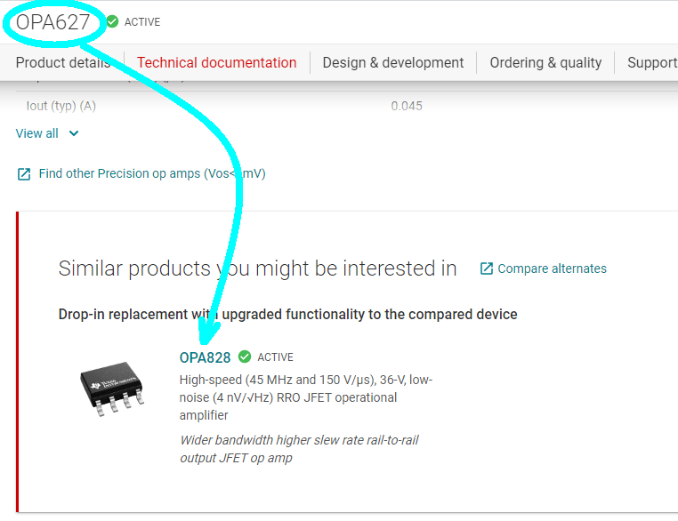

The OPA627 Product Details page on Texas Instruments' website suggests a compatible replacement, see below. T.I. also provide a side-by-side comparison table (here) . If you prefer to use an actual OPA627 in SMD package, but are unwilling or unable to solder an SOIC-to-DIP adapter yourself, I would be happy to solder it for you, free of charge. You only pay the round trip shipping fees. Send me the ICs, the SOIC-to-DIP adapter PCBs, and the thru-hole "legs" which fit your adapter boards. I'll solder them together and test them to verify they work, then send back to you. Send PM when you've got everything together and ready to ship.

I may be stupid here , but TI states that the OPA827 has rail to rail output ?The OPA627 Product Details page on Texas Instruments' website suggests a compatible replacement, see below. T.I. also provide a side-by-side comparison table (here) . If you prefer to use an actual OPA627 in SMD package, but are unwilling or unable to solder an SOIC-to-DIP adapter yourself, I would be happy to solder it for you, free of charge. You only pay the round trip shipping fees. Send me the ICs, the SOIC-to-DIP adapter PCBs, and the thru-hole "legs" which fit your adapter boards. I'll solder them together and test them to verify they work, then send back to you. Send PM when you've got everything together and ready to ship.
_
https://www.ti.com/compare-products...ernate-gpn&partList=OPA627,OPA828&sticky=true
Figure 6-18 & 6-19 , says no. But I maybe wrong .
https://www.ti.com/lit/ds/symlink/o...l=https%3A%2F%2Fwww.ti.com%2Fproduct%2FOPA828
Feel free to make your own substitutions if you don't like the ones suggested by Texas Instruments.
OPA627 doesn't have rail to rail either. It is not about liking it, TI's suggestion is valid , but I just wonder about them writing rail output.

Yes sorry , I meant the OPA828 of course . With 627 and 828 and there is an 827 too , an easy error. Now I kinda understand Mark J's post.
But in the TI comparison is an error too . OPA 828 is not rail to rail . That is why I kept it on 2 x 15 V instead of 2 x 12V to keep the chip cooler.

An opamp cannot possibly do rail to rail. There are at least voltage drops in the drivers, Vce(sat) in the output pair, and a further drop in the emitter resistors of the output pair. So you ultimately be limited to at least 2V between voltage rails and peak output voltage. So for example if the rails are +/-15V the maximum output swing will be +/-13V or very close.
