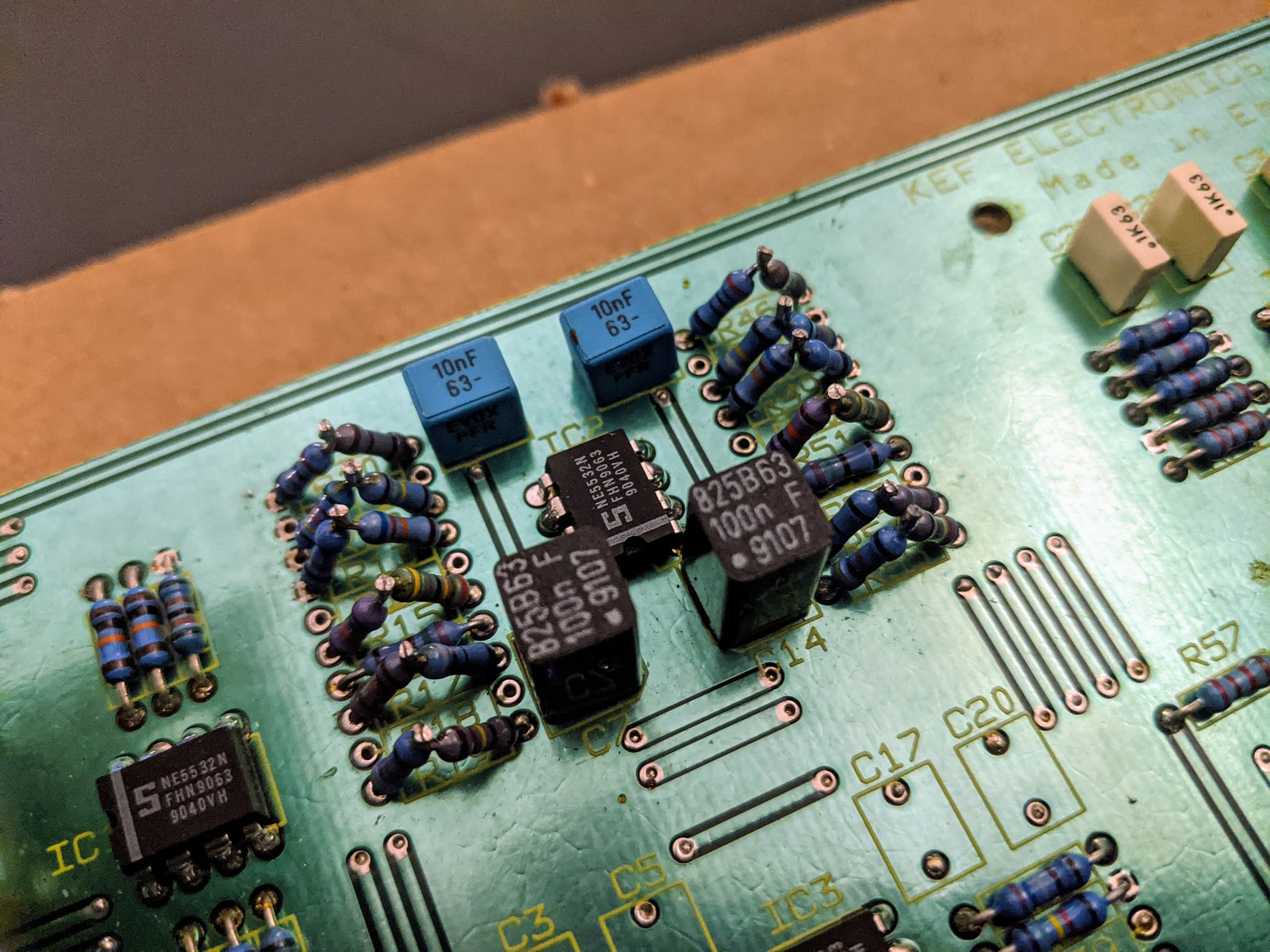

I am currently building clones of the KEF KUBE 200 equaliser
I want to find replacement OpAmps that are exact replacements for the now obsolete NE5532N or NE5532AN that can be sourced from Mouser or Digikey, not AliExpress

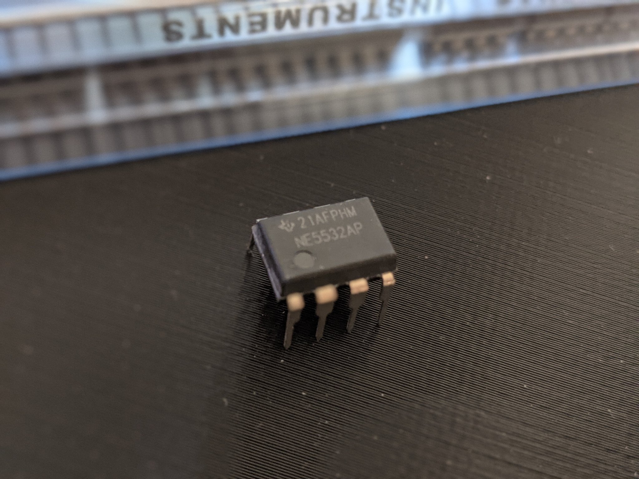

NE5532P or NE5532AP (which has slightly less noise than the NE5532P).

https://www.mouser.com/ProductDetail/Texas-Instruments/NE5532P?qs=3pnr37ZAbK%2Bre0OAHDmGsw==
Mouser seems to have a few in stock. 17,342 of them in the DIP package. They cost $.59 each in onesies! You might want to buy a few and perhaps some other assorted parts you will be needing to justify the shipping.

Thank you everyone for your replies. It is appreciated. I know there are better OpAmps than the old 5532 but I will keep that one for the first "proof of concept" prototypes. I want a 100% original design to start.

Also, I'll be soldering sockets. Therefore that leaves a window for others for testing different OpAmps. In my situation, I don't want to change the sound from the initial design. I'll produce a faithfull copy of the KUBE 200, and a hybrid version with KUBE 107/2 Bass Extension Curve, but KUBE 200 Contour corrections.

NE5532 is still an active (i.e., current production) part at TI. They sell the National Semiconductor version.
It's actually a remarkably good part, especially for its age. You can find modern opamps that'll provide better performance and drop right into the socket. The LM4562NA springs to mind. But there's nothing wrong with the NE5532.
