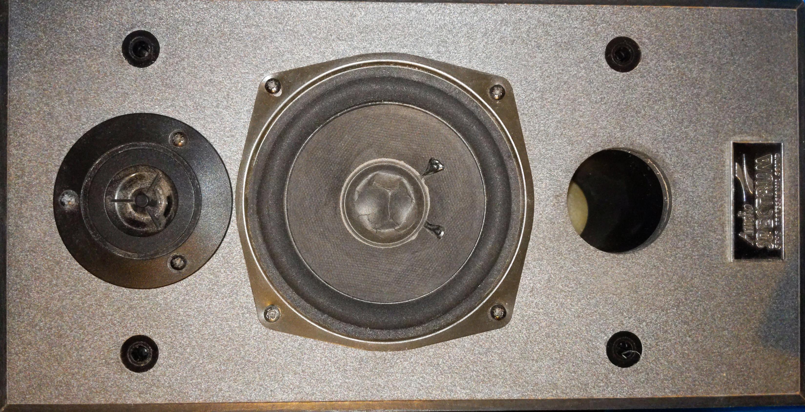

I am currently "renovating" some hand made speakers from the 70s or 80s.
Seems the tweeters and the capacitors are dead.
Looking for a good replacement for the ERO MKT1813 4.4µF (4.4uF) 250V 5%.
Seems they are not produced any more.
Can anyone suggest some proper replacement for them?

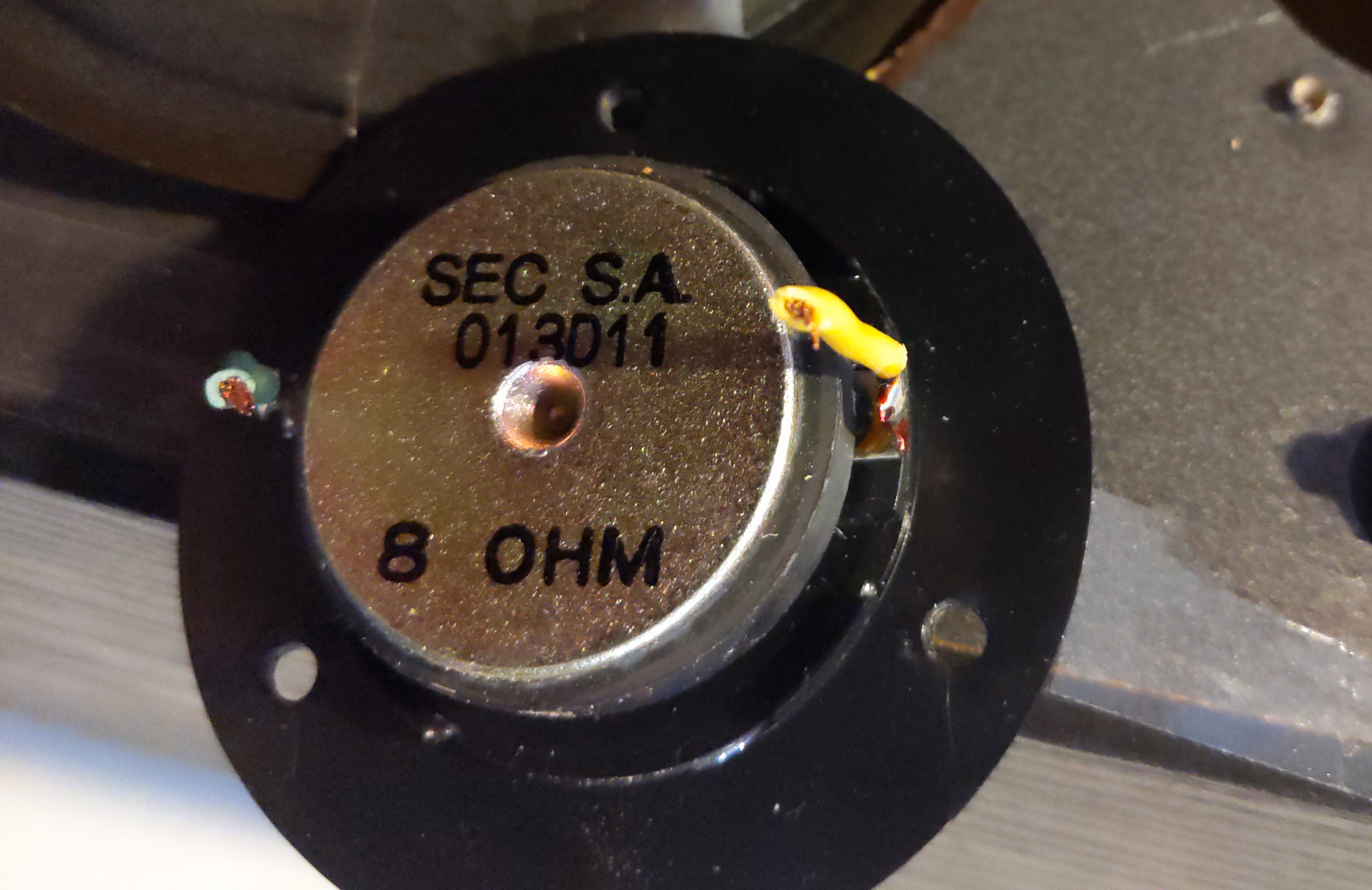

Now it's just the tweeters that need replacing. Sadly, the company Audio Spectrum seems to be out of business. It's been a greek company.
The tweeters are made by them. They are labeled:
SEC S.A.
013D11
8 OHM
SEC probably stands for Spectrum Electronics
They are 1 inch in size.
The speakers are named CM-100.
I am having difficulties to find information on the speakers. The only info I could find is from this prospect someone scanned on a greek AV forum:
Hi, excuse my delay, I was distracted the last weeks.
Here is some pics of the tweeter I am looking to replace.
It seems they originate from a Korean Company, but I can not find any source or info on the company nor on their tweeters.
Any recommendations?

Hi, sorry for my delay, I was distracted the last weeks.
Here is some images I made of the tweeter.
I read somewhere that the company SEC S.A. is supposedly Taiwanese. Or was. Seems not to exist anymore, I can not find any source or info.
