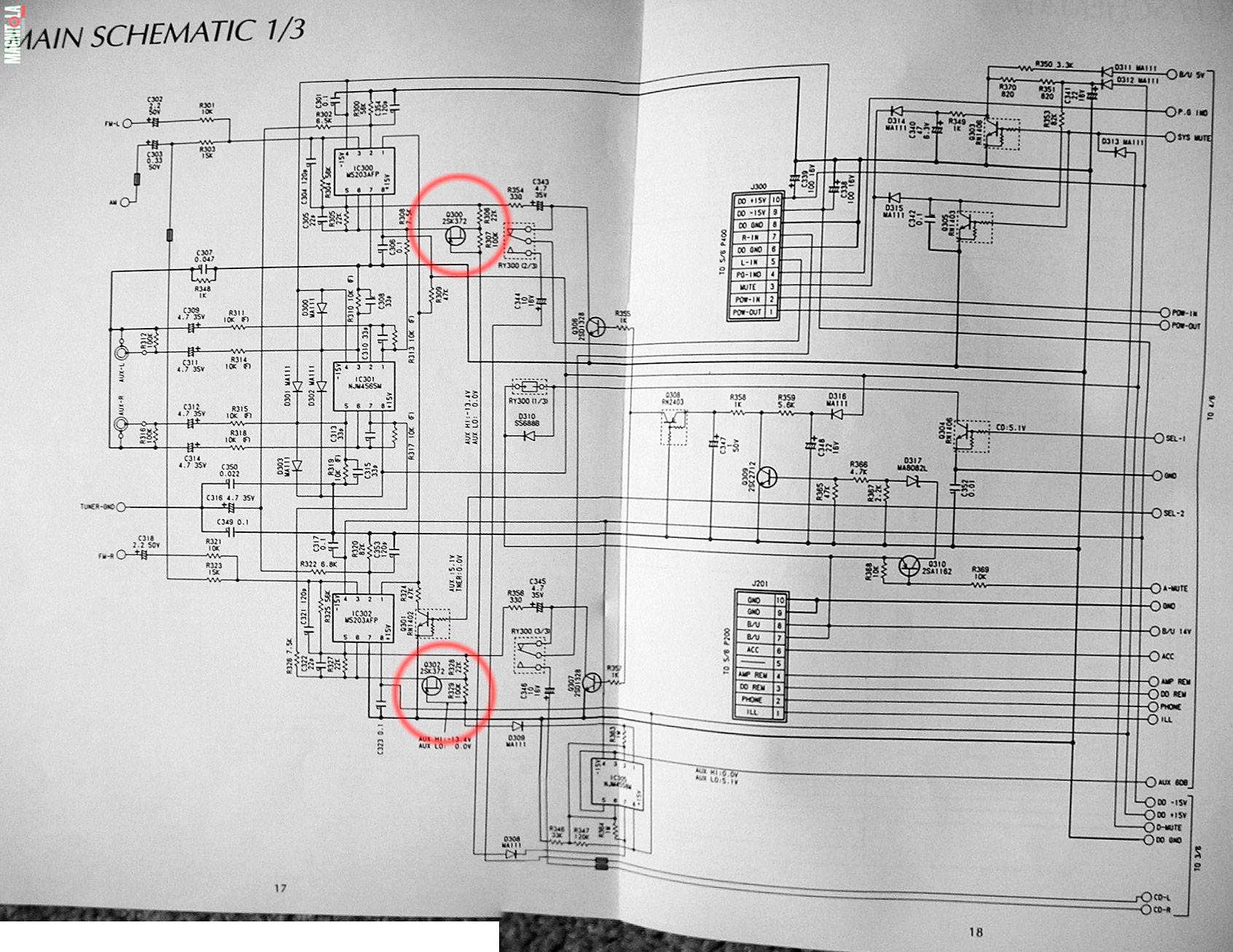

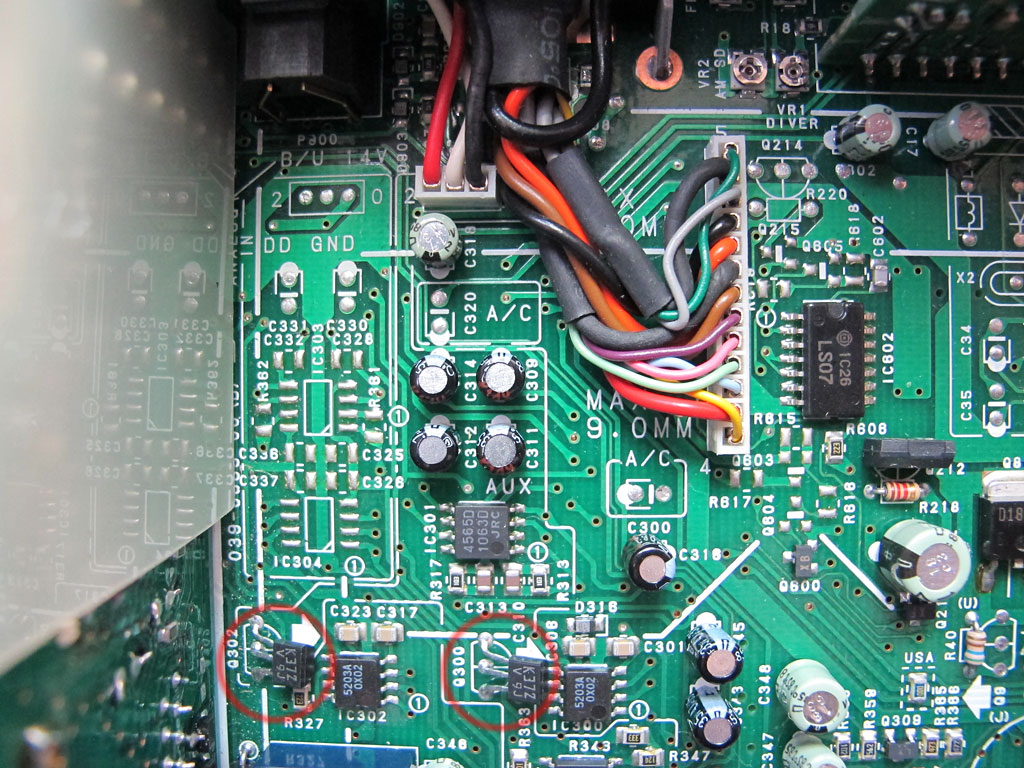

Device needs to be TO-92 as it fits in a very confined space. Pin config ideally needs to be the same too. Here is the datasheet for it. They are part of the aux input on a McIntosh MX406. Here is where they are in the circuit diagram. (Q300/302)
Can anyone tell me if 2SK170 is suitable to use? (I know its also obsolete but mouser have quite a few of both the GRF and BLF versions)

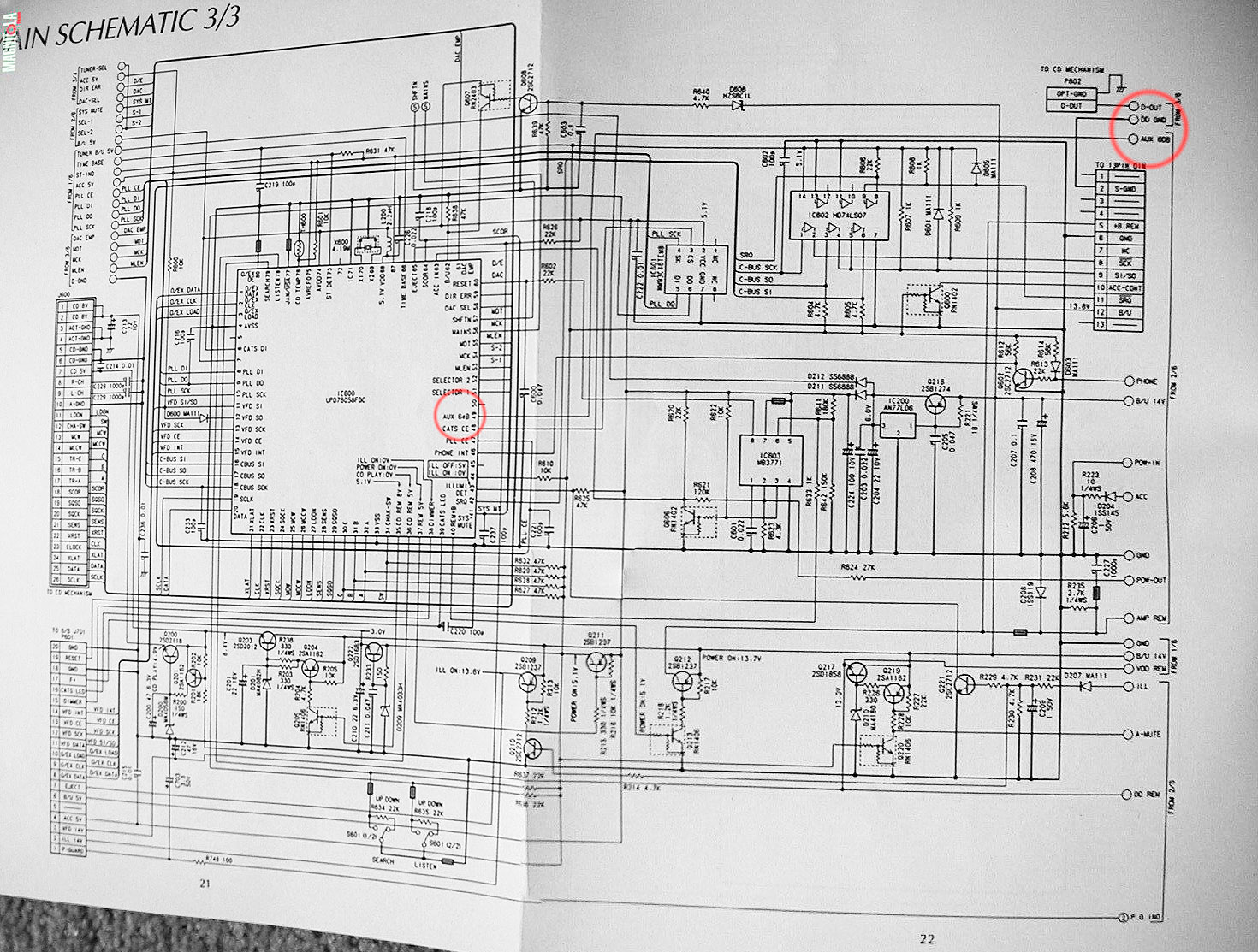

I've attached some additional circuit diagrams to help show where these components go and what they are supposed to do.
