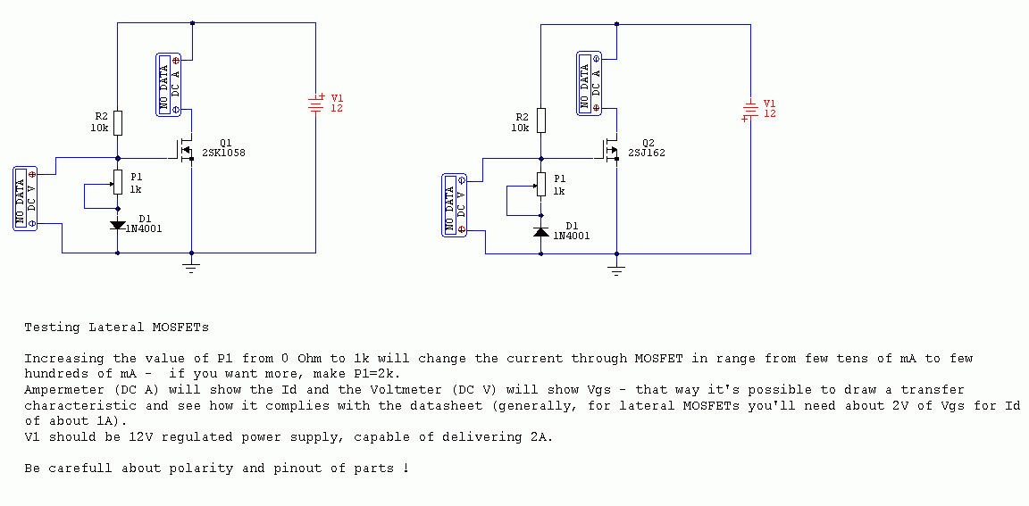

Ugs or Vgs (voltage between gate and source) controls the current between the drain and source of the mosfet (Id or Ids). Matching is the process that you perform in order to select parts which have same Id when same Vgs is applied.
If you parallel unmatched parts without source resistors, one of the paralleled mosfets will always conduct more current than the other and it has noticeable impact on amp's performance. You'll have to either match the mosfets or modify the circuit by introducing source resistors (which will also noticeably change the amp's performance).

Because I had DC voltage at the speaker terminals I "assumed" one or more of the channel transistor had shorted. I put them on my B&K 520 transistor tester "assuming" it would identify the NPN vs PNP, shorts etc. When it came up not being able to determine conclusively which type it was (this model you hook up all three leads randomly and cycle a swicth and it identifies the various pins you are connected to) but since it showed on two setting where normal there would be only one, and on each setting showed a current leakage, I "assumed" it was bad. At least 3 of the 4.
Turns out - a totally inappropriate test for a mosfet. Now I understand the multimeter approach (e.g. building a quick charge up on the gate, seeing it on the drain, and come to find the two 2SK134's seem to be fine and it's the two SJ49 (one of which I "assumed was fine" that are bad. I did some other comparative reading with the old transistor tester with the good channel ones (both types) and now pretty convinced my problem lies with the SJ49s alone. What doesn't makes sense to me is since they don't show a short (unless it is happening at some high voltage) how I could have DC voltage out the speaker terminals?
