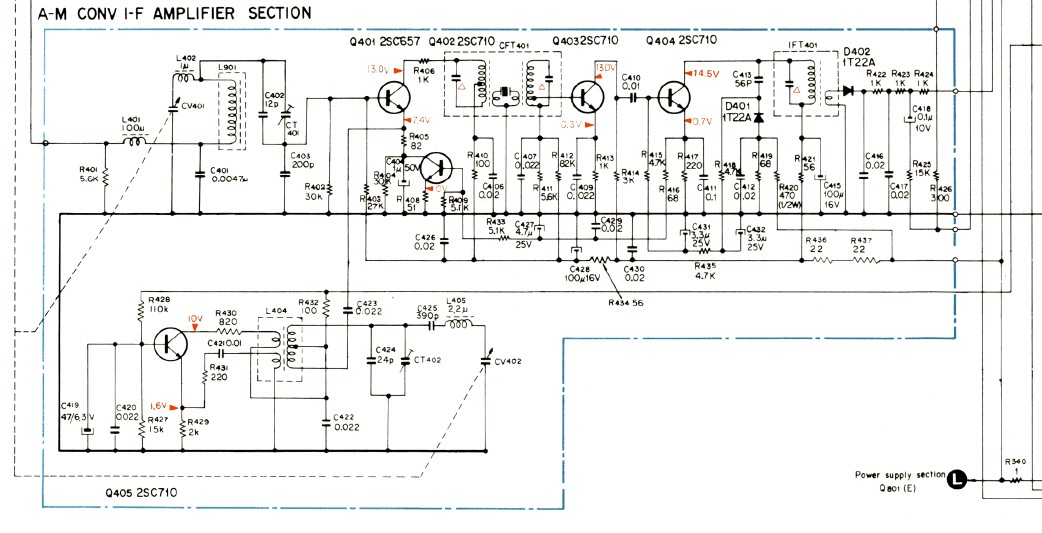

If a transistor is used in RF circuitry then substitution can (but not always) be more tricky. The ratings in the data sheet are max values so a device with higher values for voltage, power and current is fine. The real problems come from things such as junction capacitance and gain vs freq. Often you just have to try a suitable device and see how it behaves. You may also have to perform some realignment of any stage the transistor is used in due to differing device characteristics. That could in some cases even apply if you swap like for like.
Q401 looks to be used as a "mixer" taking the input signal and the output from a local oscillator Q405 to produce a fixed IF or intermediate frequency output. It's what is called a "Heterodyne" or more correctly Super Heterodyne receiver.
I think the BF199 has to be worth a try and the only trimmer I would adjust initially would be CT40.

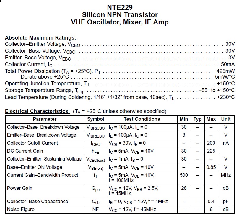

I found another good possibility:
NTE229
Silicon NPN Transistor
VHF Oscillator, Mixer, IF Amp
It's not one I am familiar with but seems OK at first glance. This is a case where you are going to have to try them and see.
No one can second guess substitutions like this as the circuit is originally designed around a very specific part, and with it operating at relatively high frequency the device characteristics influence the result even if it can be compensated for via realignment.
That probably sounds a lot worse than it is... try them and tweek just the trimmer CT40.
