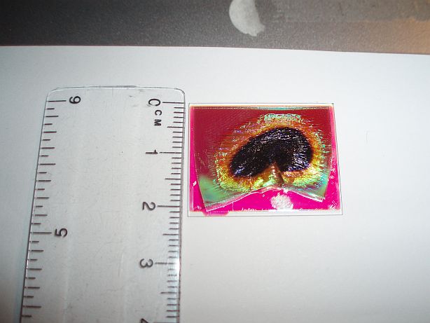

Anyway having fired it up i noticed the image was totally lacking red apart from a strange 'halo' effect, some investigating later it turns out the red colour filter/polariser has been burnt badly and needs replacing. Anyone here know of anywhere i can buy such a thing, or has anyone got one from a dead projector?

I found i could lift the burnt polariser away from the red filter itself unfortunately in trying to clean the large amount of residual glue i cracked the filter. One step forward 2 steps back yet again.
Anyone know where i can get a filter or any way to fabricate/botch/generally fit one such that the image will have an element of red?

When you say red filter are you talking about the red part of a colour wheel in a DLP projector, I don't know if its possible to buy replacements but maybe you could try finding an old broken DLP and salvaging the filter from that.

The XU30 is actually a 3LCD type projector with a colour filter for each lcd to generate the image, obviously without the red filter the image would have no red component. The filter was a very thin piece of glass and was a diachroic type, it is possible to have replacements made.
