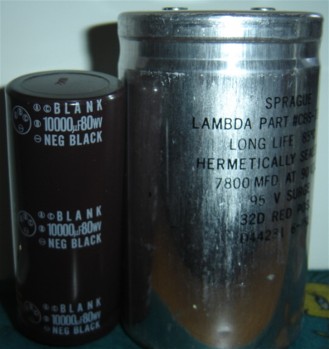

hi having just replaced a blown channel in my nakamichi amplifier 1, i quite fancy replacing the big power caps which are nichicon great supply negative 10000uf 63v, these i gather are no longer avalible has anyone an idea of sutible replacements, also can i raise the value of the caps without any problems?

10 mF / 63 Volt is a quite standard value. Don't raise caps value if you don't know the detail of the entire PSU circuit (especially rectifiers and power transformers data.

But to be truthful I,ve never ever until yesterday heard of a millifarad.... farad,micro,pico,nano. and always assumed mf=uf hell just look in a Allied or Newark catalog they use them as the same. I guess your never to old to learn something🙂
