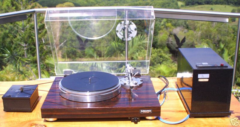

I need a new belt for my Micro Seiki RX2000.
Does anybody know a good addresse.
The length is not critical, because of the seperat motor. But at least a diameter of 500mm
I found this RX2000 picture at vinylengine.com

Try a thread -- particularly if the motor pulley has a groove in the center, a thread is potentially an improvement. Micro Seiki used to sell Kevlar thread for this, but I use plain old sewing thread, and it has lasted for about a decade now. And sounds much better than the belt.
