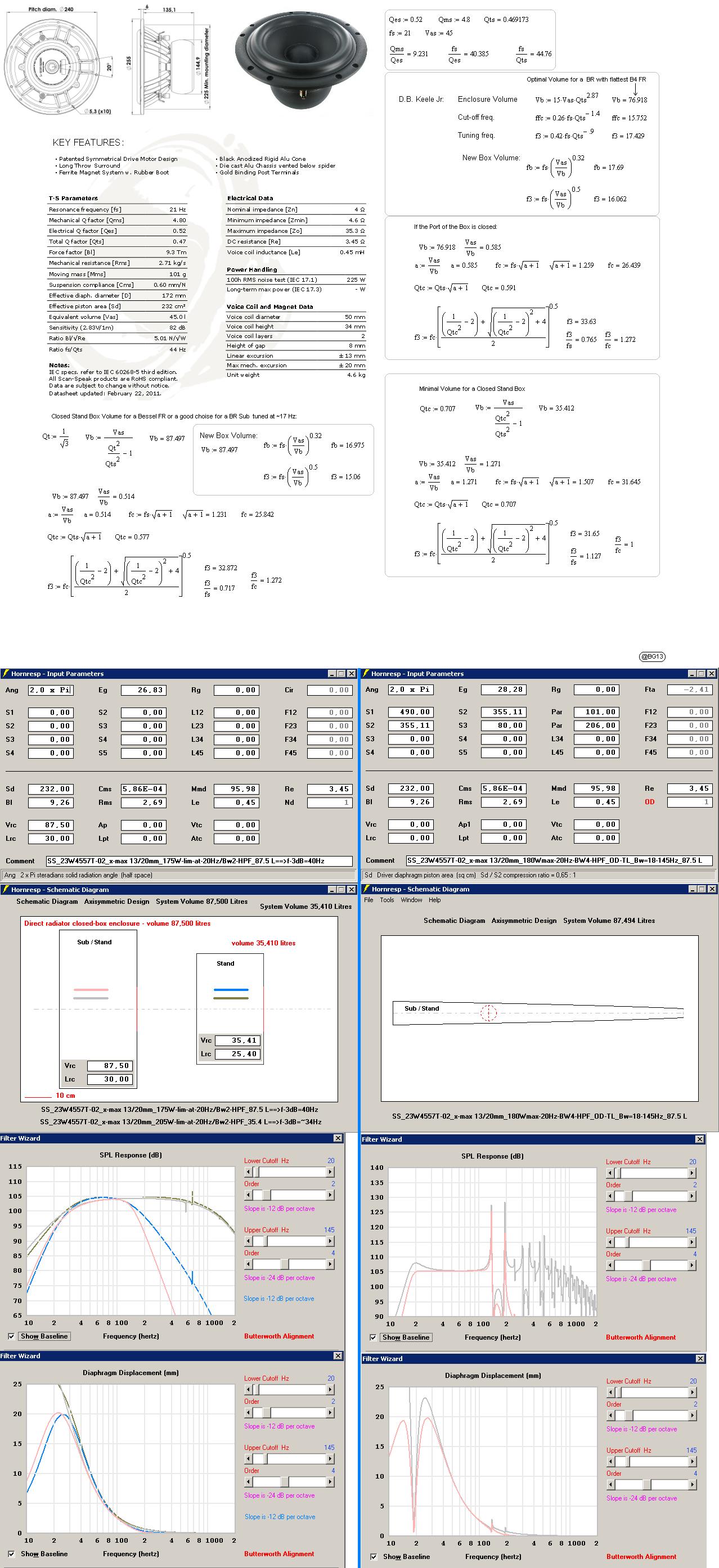

I would like to say (to) buy a good driver or that brand/model, but you said "no" ( - I'm not buying a 200/300 USD driver, kind of...). Let's find a bargain then... let's shopping! 😀
ScanSpeak 22W/4534G00 Discovery 8" Woofer 4 ohm The Madisound Speaker Store
For the enclosure you have a certain configuration. You can make a BR configuration for a better low frequency extension, that is what you are looking for, besides the sub<100 USD...
You have available about 30/28L of net space/volume (internal) depending of the ply you are using... but, that's not enough for this driver (disregard the volumes given by the spreadsheet/Madisound in this case. You will need to double (or make as much space/volume available above your starting volume of ~30L/net) this volume so make it higher of dipper then you can have an acceptable project. This is an acceptable conservative alignment using this same driver with a low Q, good LF extension, and all for an acceptable price. Use 2 drivers and 2 subs. You can turn the subs face/front to the sides. Make (extra) space internal for vents/ports and driver displacement/volume.
VB = 56.0 L, FB = 30.0 Hz
Port diameter = 4in
Port length = 16 or 17in (Check final net/internal volume/frequency alignment)
Other possible drivers (enclosures >50L):
SB Acoustics SB23NRXS45-8, 8" Woofer
SEAS Prestige CA22RNX (H1288) 8" Woofer
Morel MW266 8" Woofer (This driver is good in a sealed enclosure)
SEAS Prestige L22RN4X/P (H1208) 8" Alu Woofer (This driver behaves very well in a 45L BR with a good (and long: length 25/26") 4" port and firing to the side.
Madisound Approx 8" Woofers

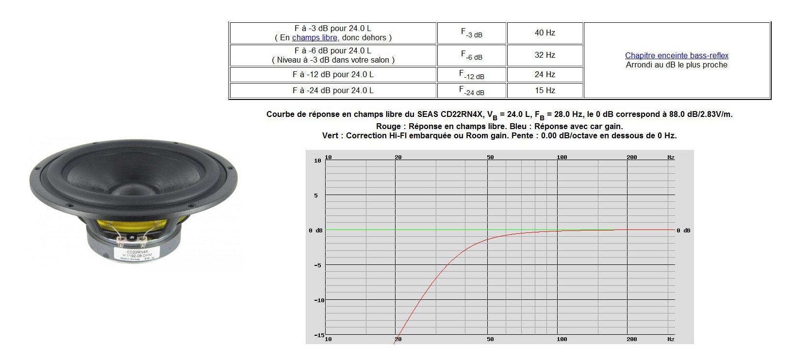

And finally.. 🙂 I found a driver that matches exactly what you have in the first post.
Conditions #1 price: is a "bargain" (not a sale/special) at todays date (Madisound Price: $118.40 (each)) is exactly what you need spec wise for volume/net available, good Q (perfect) with low extension and power.
condition #2 specs: it fits in your available space (net) VB = 24/25 L with good sensitivity (88 dB), with a good frequency response that you can fit in the front baffle and a quality driver by Seas.
condition #3 power: it deliveries a good SPL (~100 dB@2m) with a 8 Ohm 60/100W power amp.
Seas Prestige 8" Woofer CD22RN4X H1192
SEAS CD22RN4X, VB = 25.0 L, FB = 30.0 Hz (pic below)
Port diameter = 3in
Port length = 26/27in to the back because of port air noise (at max. SPL only).
Dilbret, you are a very lucky man... have a good diy build and have fun (post pics). 😉
