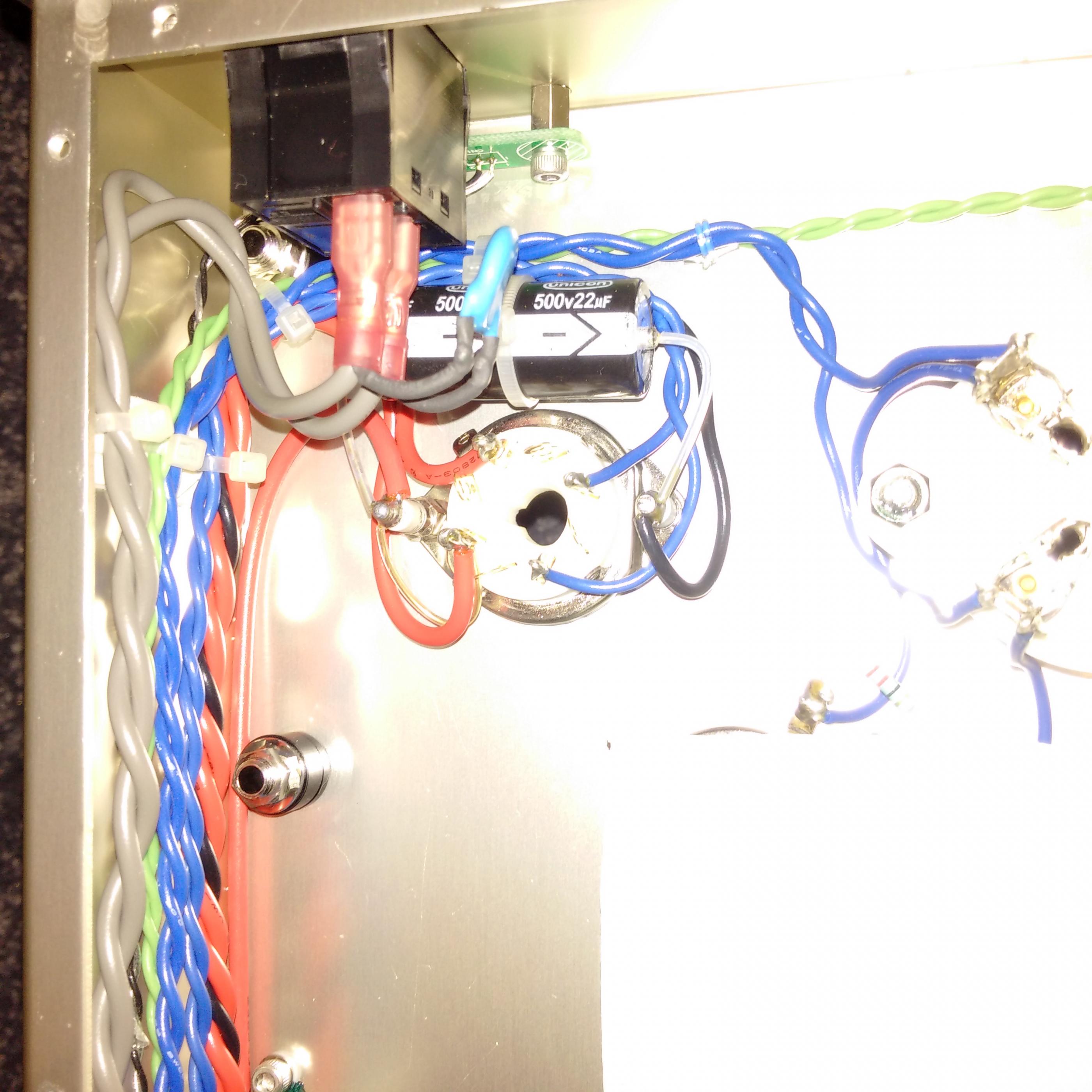

Hi, can I change 5R4GA to WE274B? Or what do I need to change in order to replace it with WE274B.
Amp is 2A3. Thank you
Look here:
https://frank.pocnet.net/sheets/136/2/274A.pdf
https://frank.pocnet.net/sheets/127/5/5R4GYA.pdf
https://frank.pocnet.net/sheets/021/5/5Z3.pdf
Now you have the information to do it.
