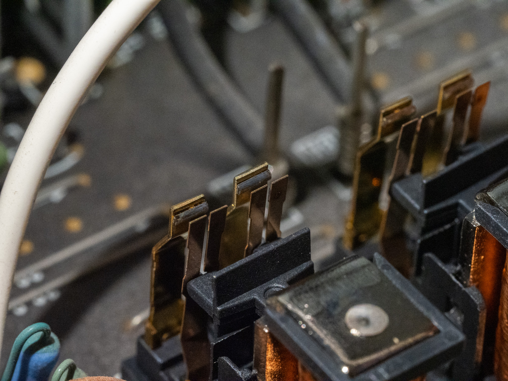

I have not been able to attribute the issue to a specific input ou output channel. It keeps coming back no matter the source (turntable/PC), the input or the output. I already tried cleaning the output switch as it was tripping (same issue as in this thread) but the problem persists. All of this led me to think that there is a faulty electronic component that I should replace.

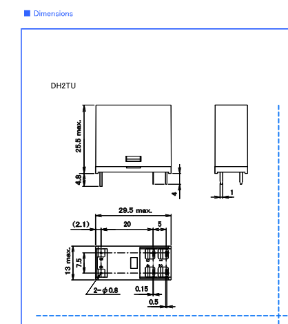

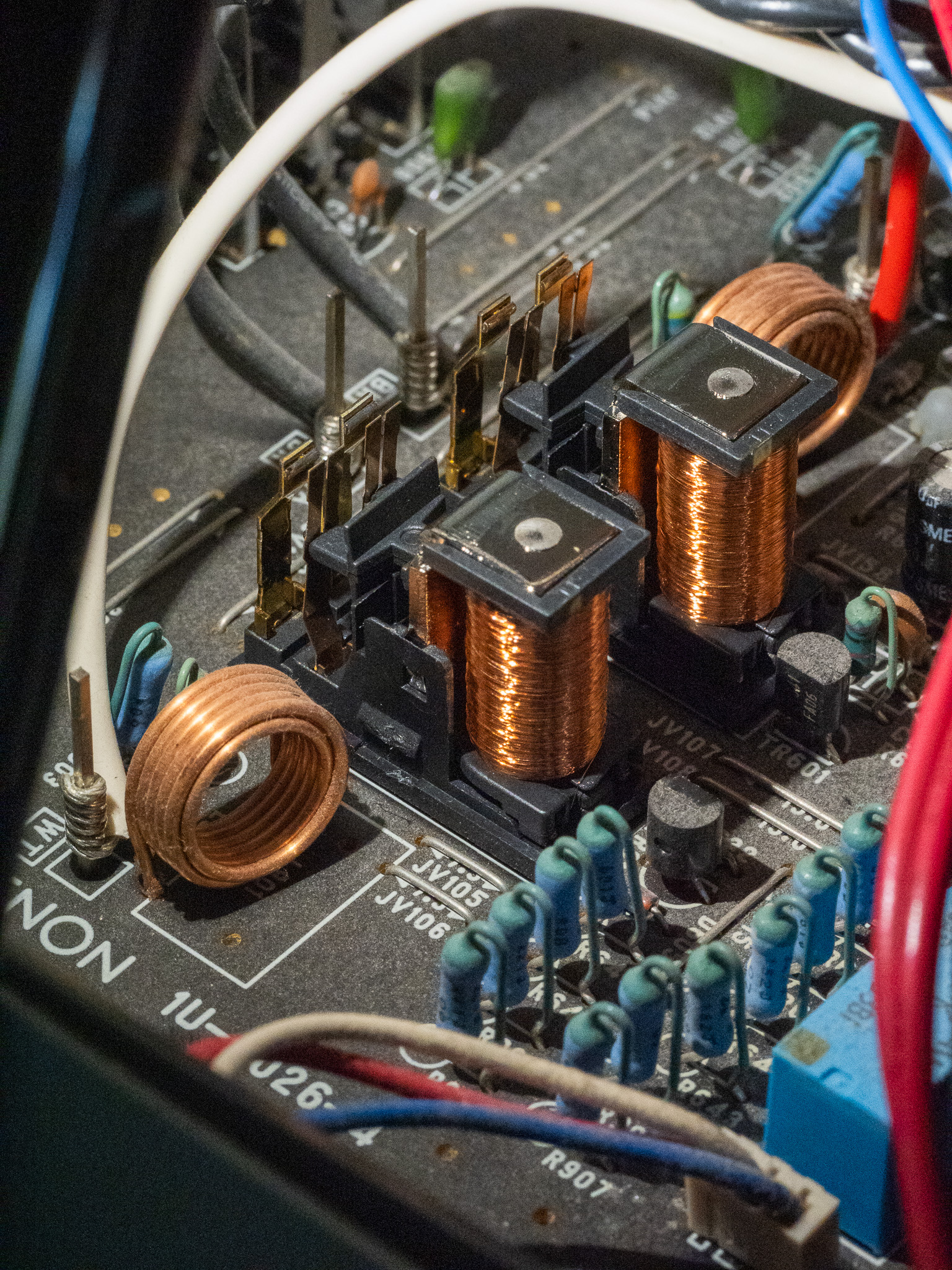

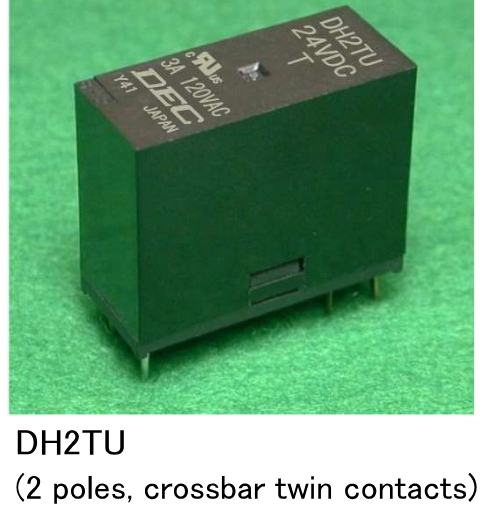

Ther person behind this great website helped me and it seems that the output relays could be responsible (specs are : HEC DHT2TU type, 24VDC, 3A120V AC). I don't know which relay I should buy to replace them.
Should I look for the same specs ? If yes should it be a coil tension of 24V ~120V AC or DC ?

You have to refer to the schematic.The relays are RL601 and RL602, with description DH2TU.
They may be 24V coils, since there are series resistors on the coils and a 50V rail.
Look at the relays for the mfr name and part number. You have to get relays that fit the board properly.
