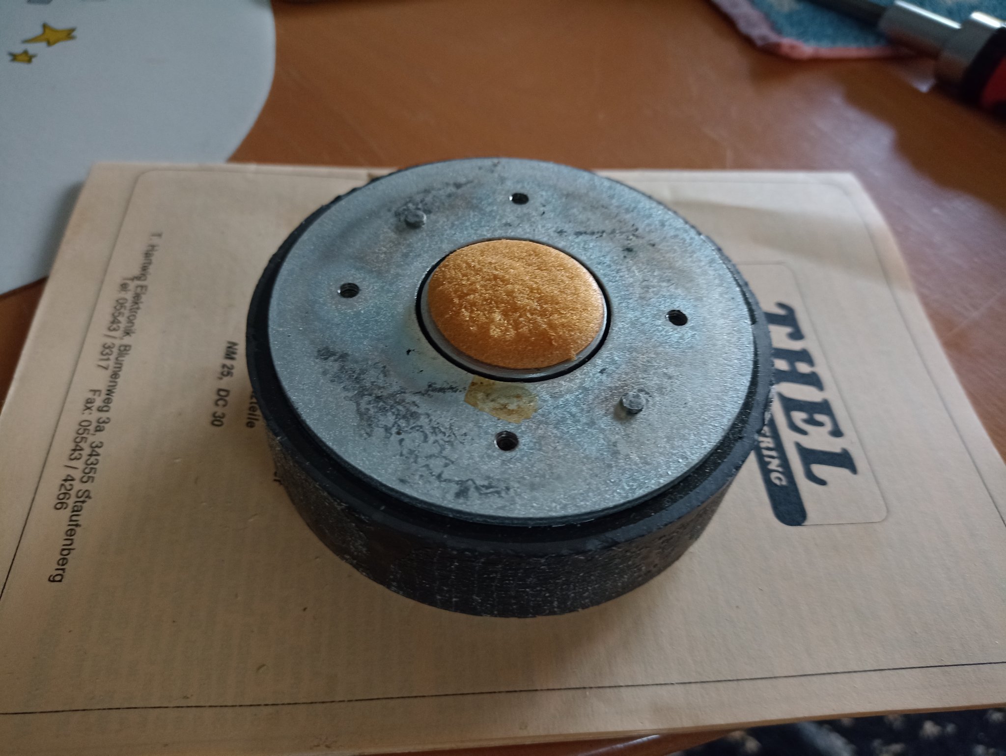

Using DATS3 , I found out that a lot of them, mostly domes, but also a few paper cone midwoofers were out of spec, I started by taking the domes apart, a lot of them had old ferrofluid in them, that stuck like glue to the coils, removing the fluid, cured most of the wrong specs....but what to do, fill the gaps with new ferrofluid, what type, where to buy, etc.

I doubt the grade matters much... probably a matter of taste. SEAS uses a thin or light one, others may differ.
I have used this cheaper ferrofluid from Blue Aran near Southampton.
You clean out the old stuff with a penetrating oil and kitchen roll on the magnet. Only about 0.1mL required. It also centres the voicecoil apparently.

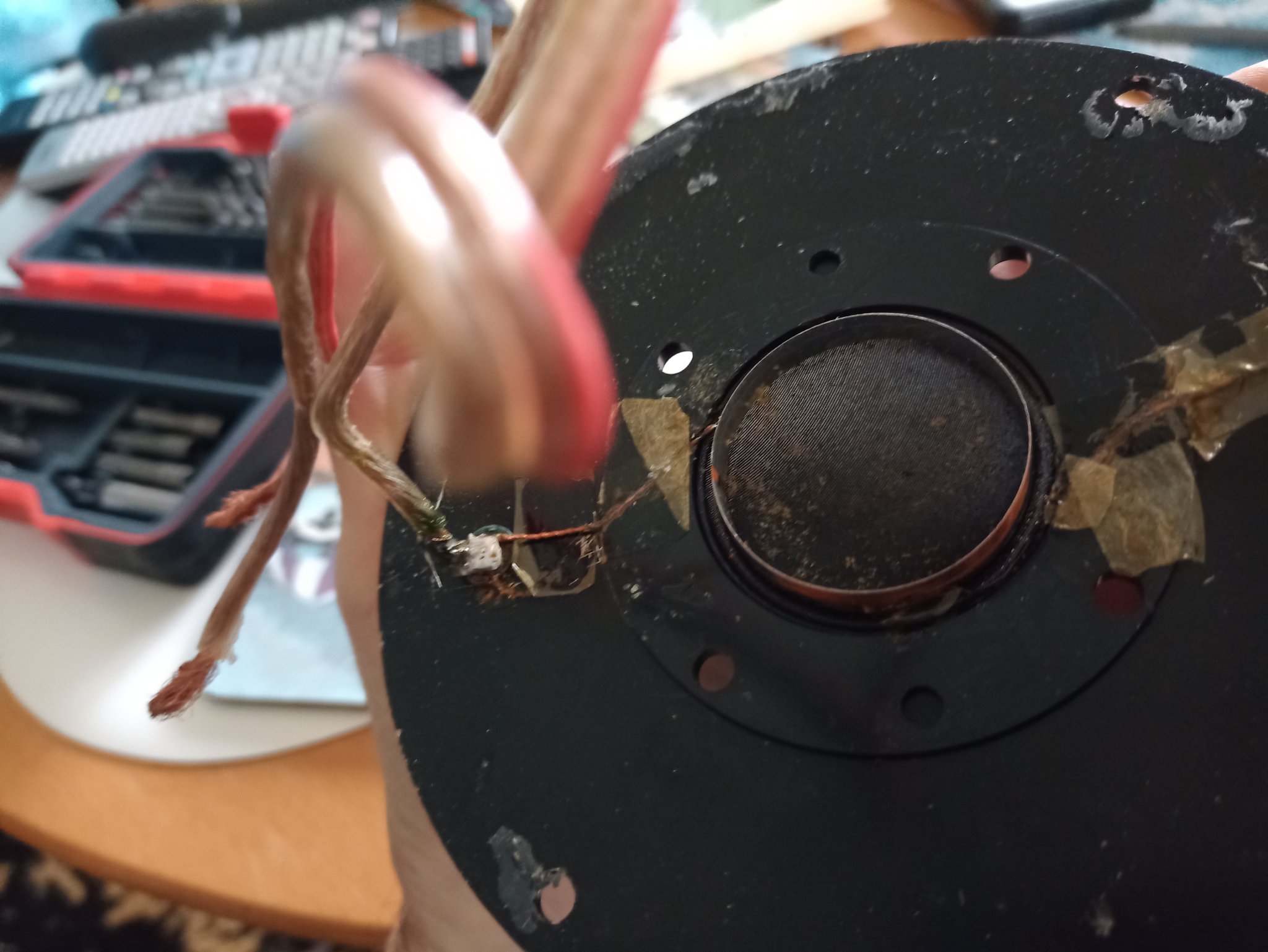

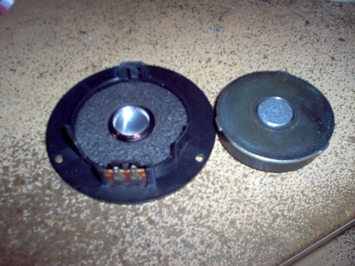

Hi
Thanks for the answering, another dome, an Audax from 1982, I took apart and there the foam behind the dome was breaking up and parts were on the coil and so disturbing the coilmovement, what can that be replaced with, any suggestions?
Cheers, Tom.

Just removing ferrofluid is no problem at all. I have literally done it dozens of times without any adverse effects. There is hardly any reason to renew ferrofluid.
Simply wipe the old fluid out with a a folded piece of envelope paper and repeat the wiping until the paper stays clean and no longer shows bits of ff.
Reactions: tojoko
I possibly misunderstood your question: if the voice coil assembly of the Audax has attracted pieces of foam, you can clean the vc assembly with alcohol, using e.g. one of those cloth or soft felt (whatever it is ) ear cleaners on a stick.(=wattenstaafje)

Sounds like the soft sponge or felt pad actually touches the Dome:
http://www.troelsgravesen.dk/large_domes.htm
Trial and error indicated here I think...
You could try a bit of that white BAF wadding you find in speakers and air-conditioning filters.
Or trim some felt to fit without touching the dome.

Answered before I saw your post...the Visatons (25 and 50 mm titanium domes) also had bad foam, with parts on the coils, cleaned those, removed ferrofluid and put basotect in the chambers behind the magnet, I will have to try them out, to see, hear, if they sound ok now
