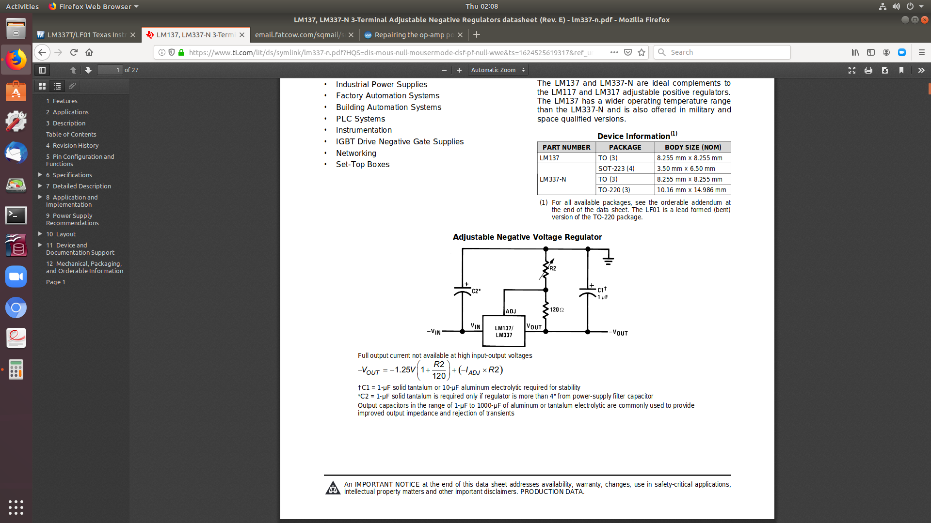

I assumed they were tantalum because that's what the datasheet for the regulator recommends, but based on the construction they are likely ceramic.

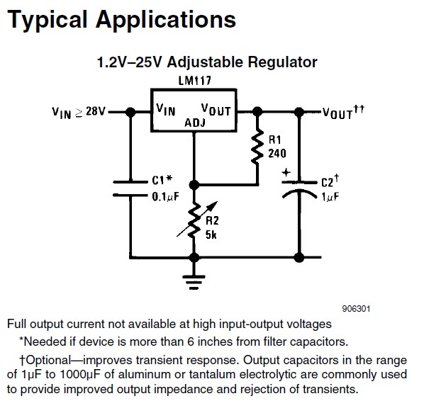

The data sheet I have doesn't specify a type for the one at the reg input. It is shown as 0.1uF and these are typically to ensure stability of the regulator.
The output caps are specified as optional and either tant or electrolytic. You will find in practice that they are not critical as long as 'something' is there. The output caps are more important for applications where transient current demands are high, something that isn't the case with a preamp. If the circuit were supplying a load of say 50 milliamps and the load could randomly spike to 800 milliamps for a couple of milliseconds then a tant would be the best choice.

The data sheet I was looking at was for the TI regulators. The installed regulators are National Semiconductor, but i couldn't find a datasheet for those.
The caps in the amp now don't have any markings at all and aren't polarized. The have the metal sides/contacts that go the whole height of the capacitor whereas the tantalums look to just have the contact near the bottom.
