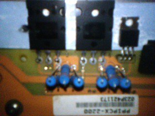

ok , without removing the MJL transistors I get .099 ohms across the 2 outside legs and .000 ohms on the large resisitors , sorry for the camera pics they are blurry but maybe you will recognize the layout im hopeing, between the RCA's and gain you will see the burnt area and what looks like a place where a large resistor was, and there are 4 small resisitors beneath the gain that are burnt and unrecognizeable by far , and the pic by the torroid is where they replaced the 2 A06, and A92 parts , on the other side it looks to be factory installed still no tampering and those 2 are A92 and A06. if you meant for me to remove the transistors to get the ohm readings I will rmove them just tested them while still soldered to the board. again sorry if the pics are too bad , I will try to get better.
OK last pic first:
Those are supposed to be A06 and A56 pairs there.
Output pic next :
on the outside pins you should read 99 to 100 ohms to as low as 22 ohms across the outside pins No lower.
Lower means Shorted transistors, are your readings 0.099 K ohms ?? that 99 ohms and OK.
across the big resistor groups, they are connected together in groups. to test these you must lift one end of each and test < i suggest the wire side, not the body side.

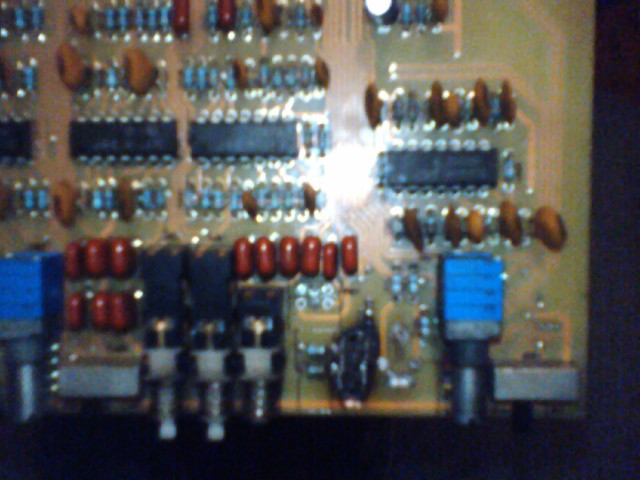

In this model those usually burn black or ash colored and darken the board when they fail, so they look Ok . I would check them later.
first pics:

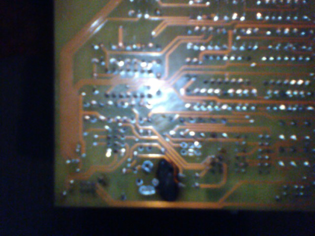

WOW ! your board has been flashed bad. All that burnt looking stuff is carbonized circuit board, and in my opinion it must be removed back to unburnt fiberglass so there will not be any short circuit through the blackened board areas. I believe you have vaporized some traces also.
This is not good, as there will be no board left to mount components back to unless you rebuild the fiberglass board. I have a friend that does this and it is time consuming at best, and requires that you use some fiberglass repair chemicals .
You know this amp may not be worth repairing at this point. Unless i can get a replacement board or repair the existing board to spec, I normally tell my clients to buy a new amp.
You amp was repair by someone that was either guessing or was using whatever he had on hand to try and fix this amp before. I say this because of the wrong transistors in the Fet driver circuitry near the toroids. And the poor soldering I can see even with a blurry picture.
The damage up front is extensive, and requires sharper pics of both sides for me to be able to help more in this area, You also need a pic without the front endplate removed if possible, end on. this is so a judgment call can be made about weather it will be worthwhile to attempt repairing this section of that board.
Ohm out the fets in the power supply section. Nothing should read shorted <below 200 to 300 ohms. everything should read higher.
You are going to have a lot of work tied up in this before it comes back to life. I say this to you so you will not be falsely lead into thinking this is a easy repair, as it is not

If you're using this amp to learn, I believe it's salvageable but it may take some work. If you're trying to repair it for profit, now would be a good time to return it to its owner.
The badly burned resistors (some of the later models used 47 ohm resistors) near the RCAs concern me. Assuming that they're the resistors that connect the RCA shields to the secondary center-tap of the transformer, I would think that it would require more than 12 volts to do the damage shown in the photo. It's possible that the transformer is shorted. Measure the resistance from the secondary center tap of the transformer to the primary center tap of the transformer. If you read something near zero ohms, the transformer is likely shorted. Even if there is no short now, it could be intermittent and may not show up until the amp is repaired.
Is there a second burned area that's not visible (under the shaft of the pot)?
Is there a burned 270 ohm resistor near the transformer?
The area that's badly burned is likely conductive and needs to be cut away. If there are no other traces over the burned area, it's no big deal to cut out the charred board. Many high quality amps use point to point wiring. It won't hurt to wire these resistors point to point. You'll simply have to follow the traces back until you get to good copper or a suitable connection point.
It's reasonable to believe that the a92s are the originals. While I don't understand why they used 300 volt transistors in that location, they are generally comparable to the a56s that are more commonly used. Only you can tell if the solder connections are the original flow-soldered connections.
You said that the meter read 0.000 ohms across the emitter resistors in the audio section. It seems like the meter may have been set to diode check or continuity. A meter that can resolve 3 places beyond the decimal point should have read higher than 0.000 ohms.
What meter are you using?
Pull the outputs and check them out of the board.
For the smaller burned resistors, try to get a better photo. Someone here may have one of these amps. If you ask nicely, they may be willing to check the values for you.

I verified by looking at my doc's and the other 7 PPI amps awaiting pickup on my shelf the gate drivers are supposed to be MPSA06 and MPSA56.
In your pic it appears that someone has been soldering around in that area. And I would say they threw in what they felt was compatible instead of using all original parts.

I <might> have a spare input board floating around in storage. If you remove it and post a couple more pics I might be able to find you a replacement <Maybe> as PPI does not support these products anymore.

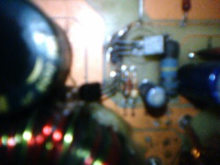

I am trying to get my digital camera back form a friend , but I looked at the board and the other side of the toroid , it is A92 and A06 and the solders are deffinately factory , I will get pics of it today in fact , if the A56 will work I will use those instead.
Yeah the A56 will work just fine. its used in all the rest I have seen over the past 19 years or so.🙂

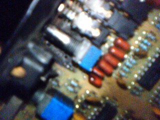

well sorry this took so long , my camera on my phone takes a better pic than my camera I got back 🙁 any way this is the best I could do , sorry for the pics , but here are 2 seperate pics 1 of the top area I took out the gain and the rca's you can see where the 2 small resisitors are at under where the gain goes and I cleaned them off so the values I am able to get , BUT there is a spot that looks like a larger resistor sat there and I would need to know the value of that 1 , the burnt area is not so bad that i cannot repair it or the traces I just need to know on the bottom side where the traces go , I believe I am only missing 1 trace on the bottom I know the pic is blurry but where the RCA solders in on the bottom at the burnt spot and as you look directly up from there you will see where a small resistor soldes in I believe there was a trace connecting the 2 but not sure, as far as bad grounds go the person that burnt the amp up I do believe TO-3 is correct it sourced a ground through the rca's but I checked all of the other components on the board for lose connections and bad traces , the amp works fine but yes the little standoff boards start to get hot but I believe when I repair the A56 and A06 and the area around the RCA's things may go back to normal as there are no bad parts on the board other than these , I checked all transistors , only bad parts are again the A56 and A06 problem, I am going to replace ALL resistors around the area of the gain and RCA's even if they dont need replaced just to give me peace of mind that I tried all I could. anyway if anyone has this amp and could tell me the value of that 1 missing resistor and the missing traces I would greatly appreciate it.

Those resistors are 2.250K ohm 2% 1/8th watt. I have pics of my spare parts unit I can post later. Or you can e-mail me if you want the whole thing. I have complete pics on my camera. If that's what you interested in I need a shipping zip for correct postage rates🙂
