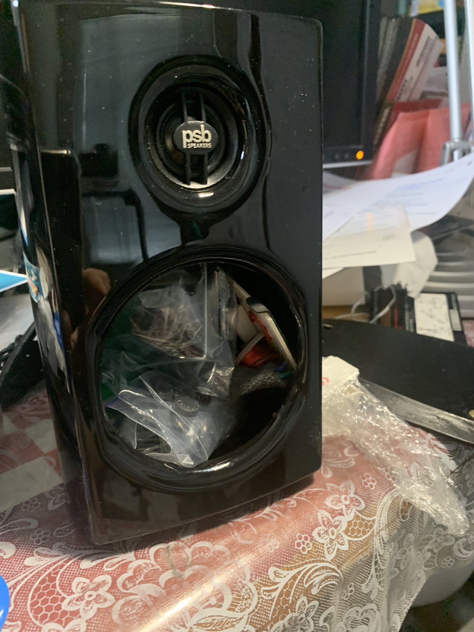

I have a blown set of PSB Alpha PS1 powered bookshelf speakers. They popped and died one day when I touched the aluminum volume knob after walking across the carpet with socks in winter. Oof.
They're nothing wildly special, but I like the way they look, and as a tinkerer, I'm thinking it might be fun to get them to make noise again. Most internet folks say it's a lost cause with powered speakers. There's either not enough technical information about the components, making it hard to pair the drivers and crossovers with a proper amp, etc, or the juice just isn't worth the squeeze. I'm not sure. Not having opened them up yet, I don't know what I'll find in there (not exactly easy to open), but could I feasibly turn these into passive speakers, or (possibly) repair the onboard amp and give them new life?

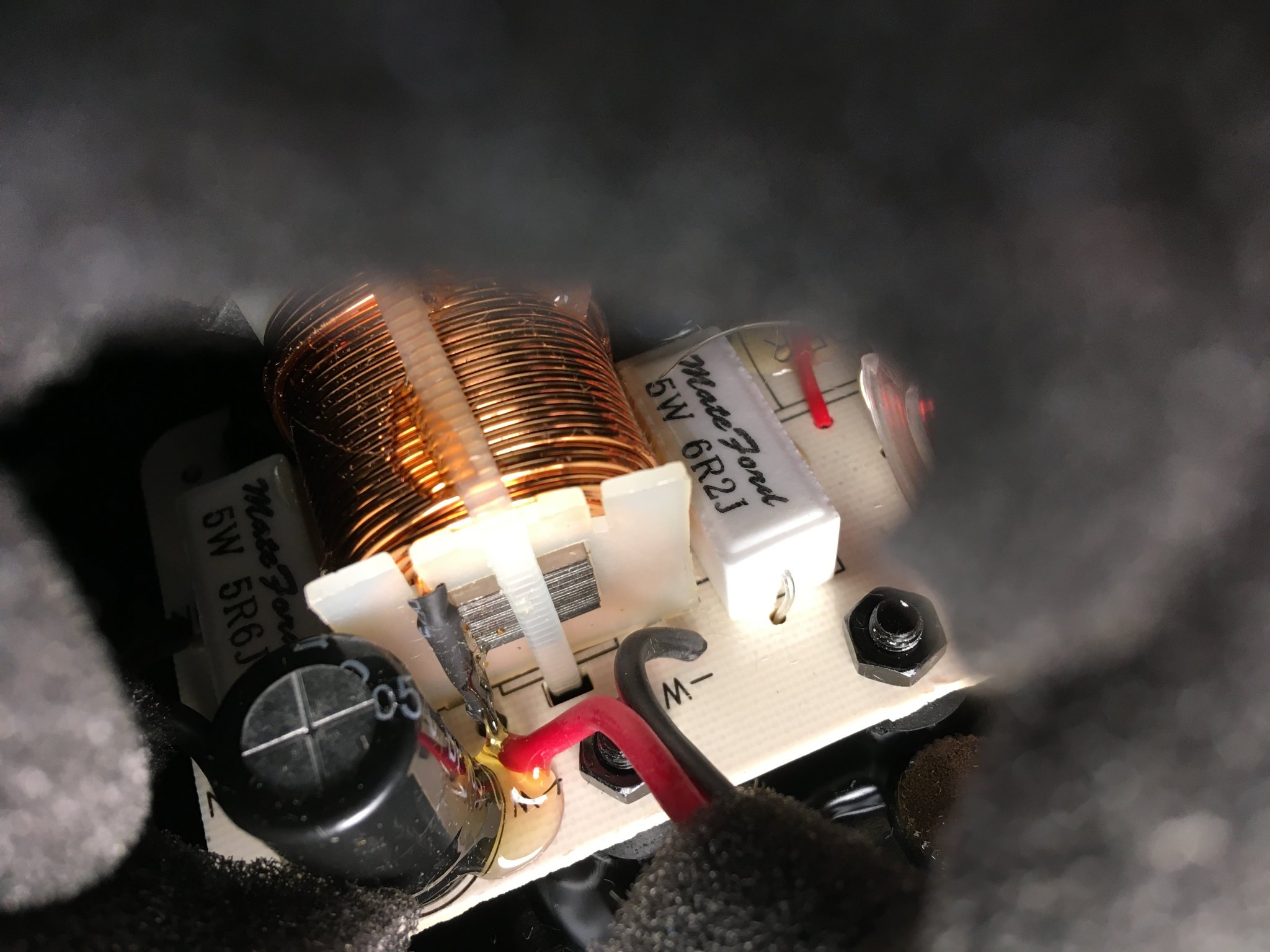

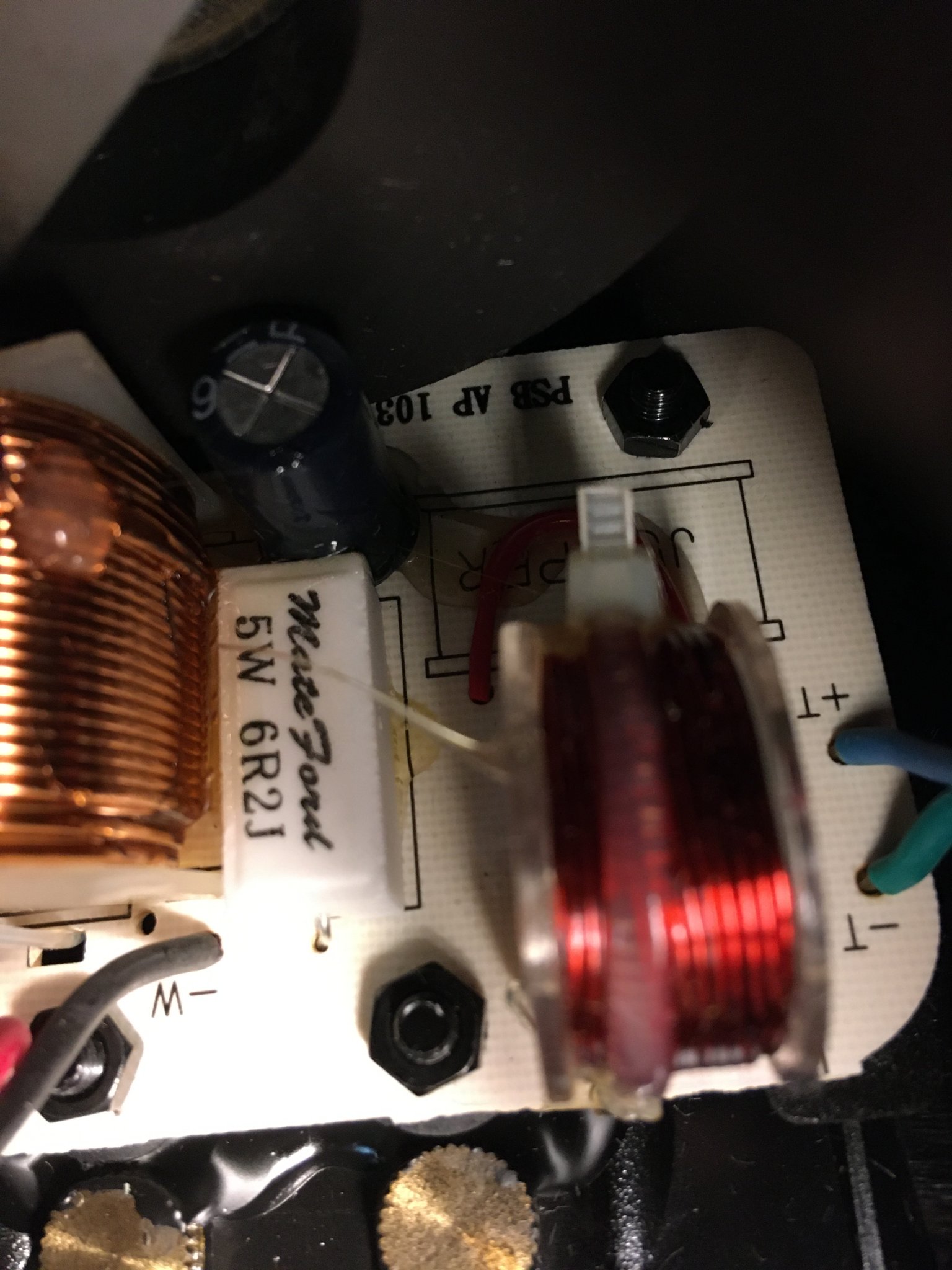

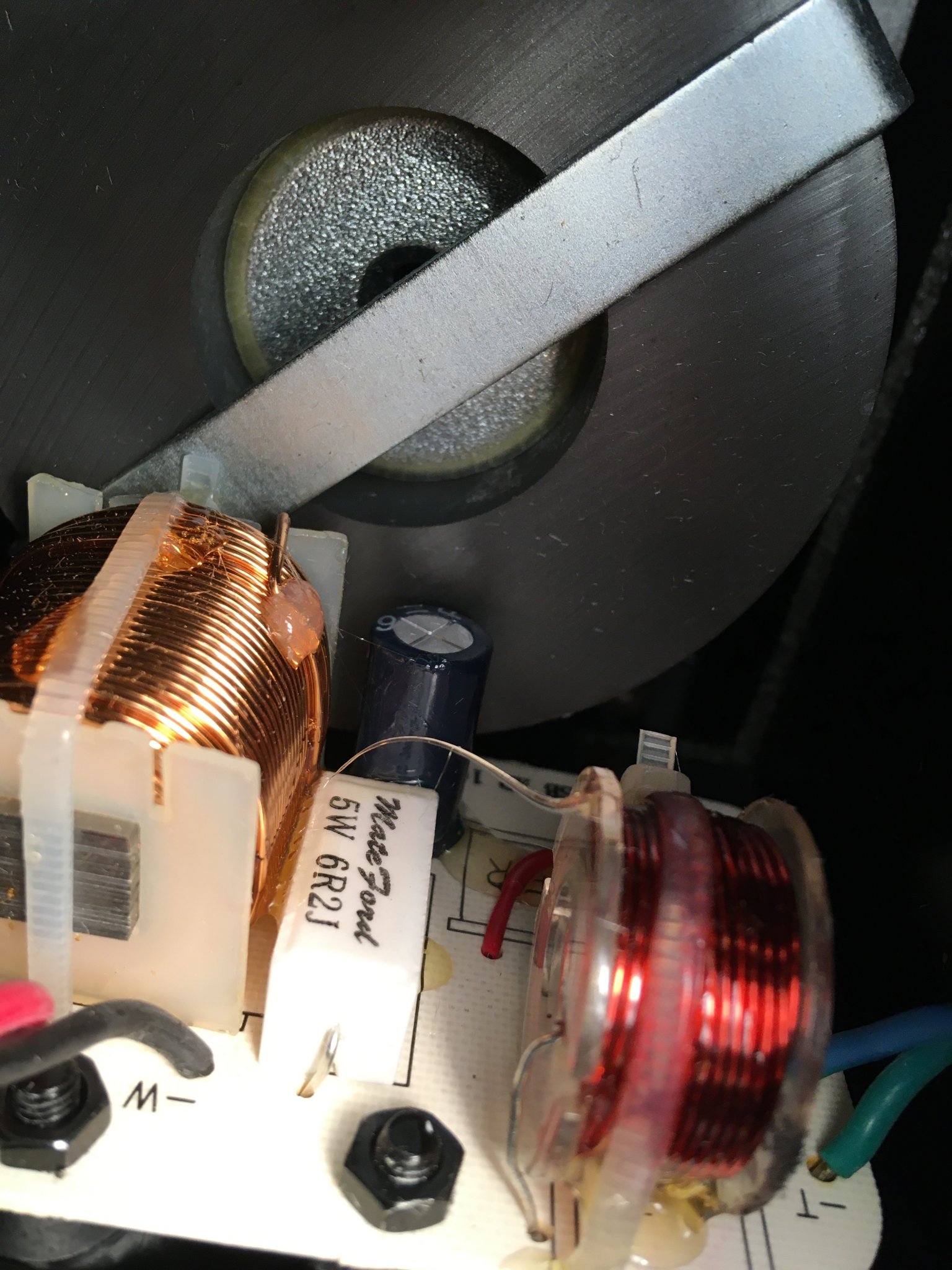

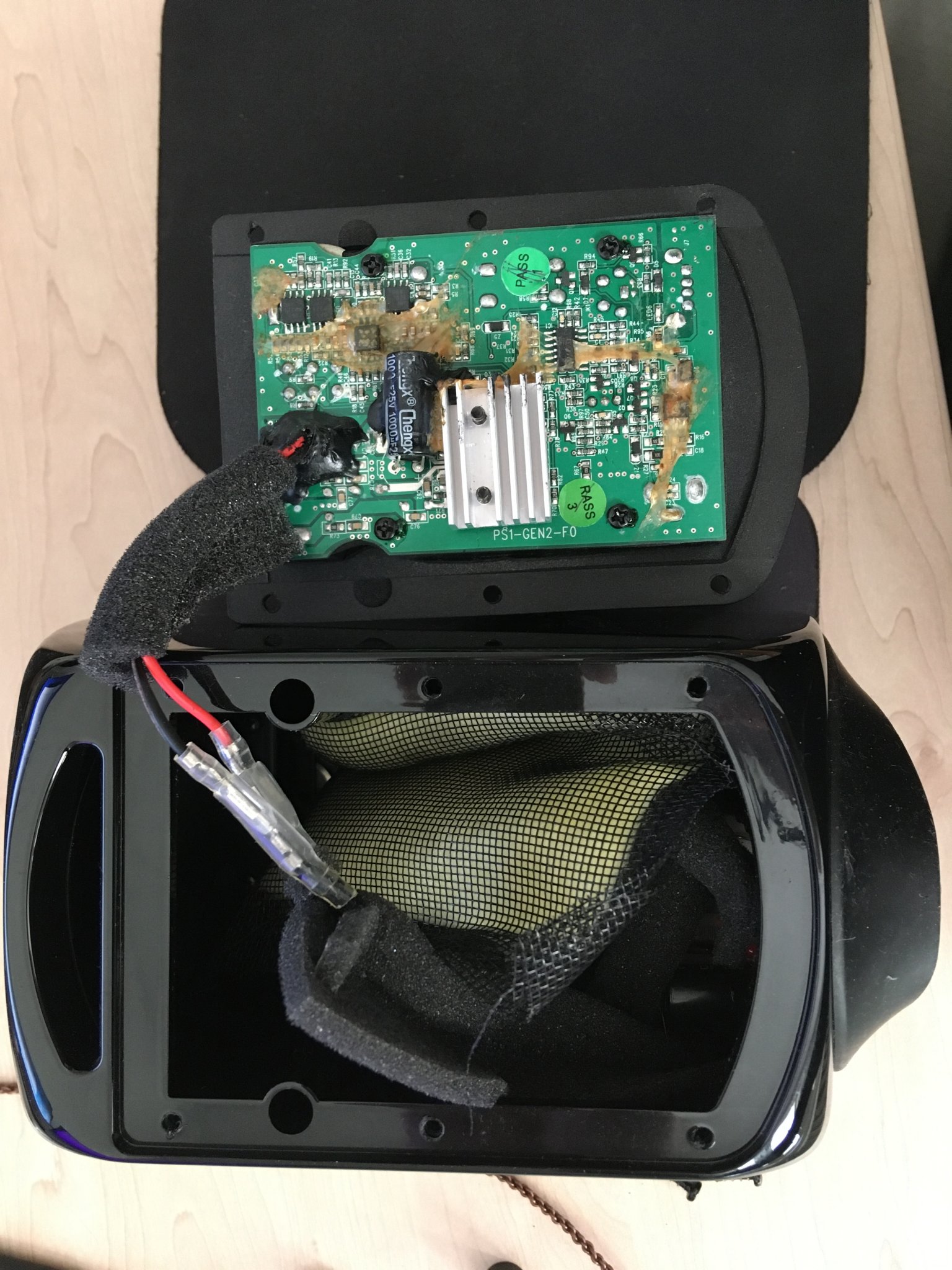

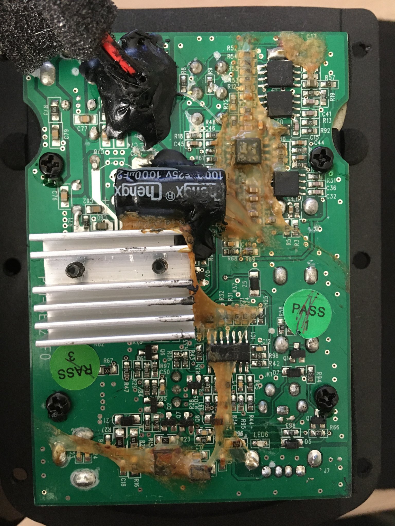

So apparently they're super easy to open. I had tried once after they blew, but after removing the back panel screws, it seemed they were glued or fused to the plastic cabinet, and I gave up for a while. Today the panel just popped right off when the screws were out.
I've only a foggy idea of what I'm looking at here, but if anyone can decipher the printed circuit board or the crossovers, I'd love to know what you find. PSB website says this is a 20w RMS amp.
Could I theoretically bypass the stock amp and connect wire terminals to the crossovers of each speaker and power these with a stand-alone 20w mini stereo amp?

Have both speakers gone dead or just one?
It's difficult diagnosing things like this at a distance... you would need first of all to check that the supply voltage is present. Assuming that is OK then most likely the main power amp chip has failed.
Whatever lives under that small metal heatsink will be the main power amp and I think I can see some coils on the main PCB (not those on the crossover) which suggests the power amp is a Class D 'switching' type of amp. Replacing that is probably something you couldn't do without familiarity and practice. Perhaps worth a look for curiosity though.
You can use an ordinary amp with the crossover. Just locate the two wires that go from the crossover to the main board and feed the audio into there,
Yes, as Mooly describes.
I can now see that the active speaker contains a passive crossover.
The secondary speaker is passive, so I'm assuming it's unharmed. The only input to that speaker is the proprietary speaker cable (looks very similar to the power cable) that runs from the "master" speaker. Not sure what this type of cable is called, but it exits the master speaker from the terminal at the top right corner in the last image of the circuit board (to the right of the volume pot). The power cable enters from the terminal in the bottom right (to the right of the USB port).
Hopefully. Speakers get damaged when the power amp puts a high DC voltage across the speaker. It's probably OK but easy to check.The secondary speaker is passive, so I'm assuming it's unharmed.

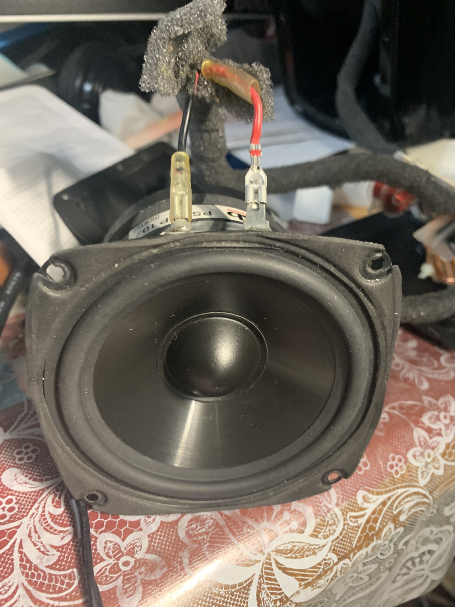

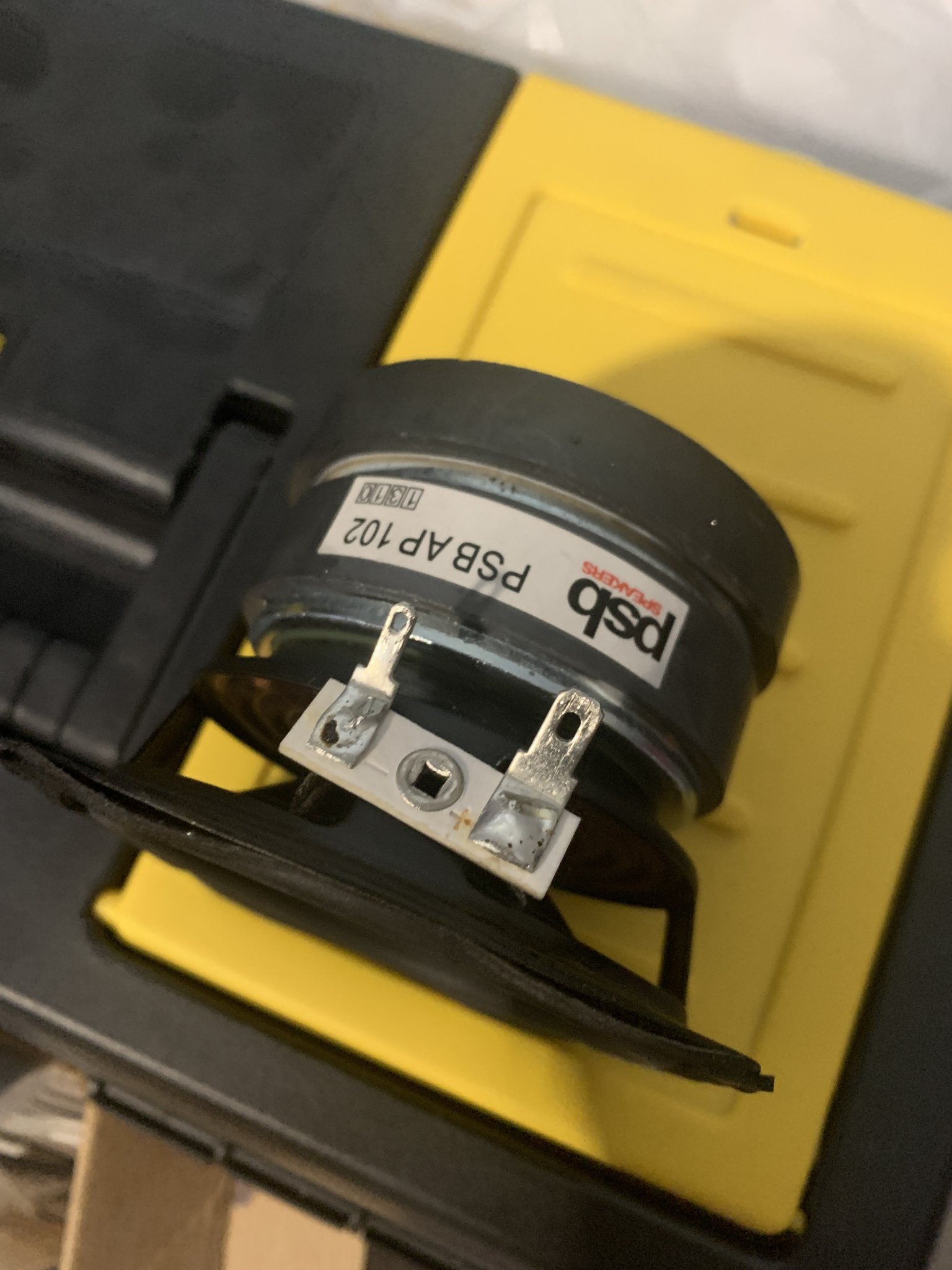

I have the PSB Alpha PS-1 with a blown woofer 3.5". Needing help where I can buy the replacement part.
The replacement woofer appears to be PSB AL 82-IT (as used in the passive Alpha B1). Can you verify the model number?
You may have to search for a second hand woofer as illustrated below, but a Canadian listing would be your best bet.
https://reverb.com/item/34970318-ps...-5-al82-for-alpha-b1-black-bookshelf-speakers
However, check the diameter. Is yours really a 3.5" woofer?
