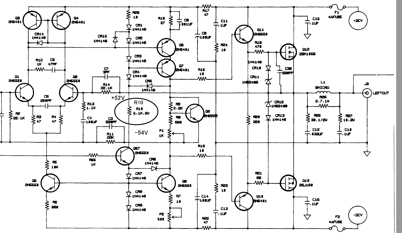

I'm building hafler HD120 I found a problem in the schematic the transistors Q6 eQ7 are NPN, on the component list are of the 2n 5401 PNP I assume that component list and schematic is original hafler

You are correct. Go by the parts list.
An option is to download the Hafler Pro1200 manual, Same basic schematic improved.
The schematic is corrected.
Also note that R10 was increased to a 5 watt resistor. It gets hot!
Good Luck!

This may have been answered, but what was the reasoning for R10 5.1K.
A departure from the basic DH-220 schematic. V drop across that thing is close to 100VDC. Started out as a 2W part and then bumped up to a 5W wirewound.
I think when I did mine I replaced it with about a 5W 1% resistor I had on hand...
The old 2W parts did a very good job of cooking the PCBs.

I replaced all the trimmer pots. with Bourns from Mouser and reset them duplicating the original resistance.
I also ended up paralleling 2 10K 2W resistors to upgrade R10.
