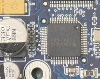

The TSB41AB1 FireWire receiver seems to be the only damaged part in the board. I have ordered a couple that will hopefully arrive tomorrow. The problem is that they are encapsulated in a 48-pins SMD package that probably will be extremely hard to solder.
I have looked around and it seems there are three ways to go: "Magical" solder flux, a hot-air soldering station and SMD ovens, but I'm pretty disoriented in what to choose. I need to solder a single-chip and this will probably be all my SMD work for years so I'm not considering expensive equipment. The board is already populated.
What would you suggest to desolder the bad one and solder the good one?

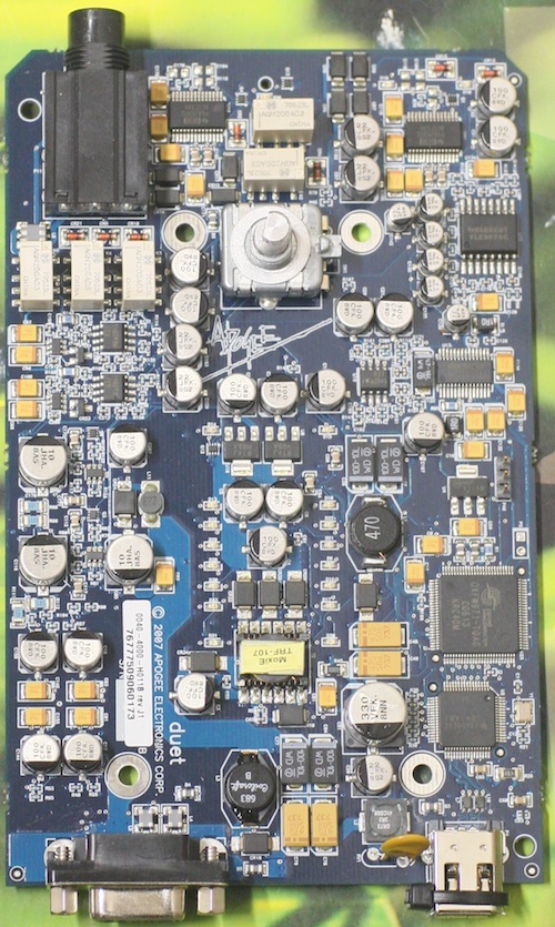

I attach a picture of the Apogee board and a picture of the chip that needs to be replaced.

I found this by googling. But I will ask my questions after giving you my opinion. I suspect your chance of replacing a 48 pin chip on your first try at surface mount board work is close to zero.
The chances of pulling up a pad, shorting pins, and open circuits is very high even after several trys on board work.
Get a good magnifing glass. Also, I usually just clip the pins off the old component, pry it off if superglues, wipe down pads with solder wick and a 12 watt needle tip, tin the pads if possible, tin the pins, and then start soldering it in.
I sweat the whole time like George Bush shopping at a market in Kabul. Even with SOIC8 chips.
My recommendation is to get the replacement part and take it to a professional for repair.

Now my question. How did you get the controller knob off to get the boards out? I pulled mine apart to add magnetic shielding to the case, and a little mechanical dampening. Want to replace the LM833 opamps. Thinking of putting LM4562 in for the I/V opamps and OPA2107 for the output stage. And maybe bypass whatever type of ceramic SM caps they are using to block DC on the output. With single rail supplies, they are unavoidable.
But I got scared at getting the knob loose to start working over the boards.

I got it done at the university lab by an expert as I suspected my chances where close to zero. Fortunately the guy agreed to help and did only ask for a couple of beers. Now it works like if it was new : ).
I pulled the knob and when I put it in place again it was still firm. I don't know if it will resist many replacements without becoming loose but it worked the first time.
The capacitors inside the apogee duet look anything but audiophile quality, really, but I believe this board has more layers than a motherboard and I'm not taking the risk.
