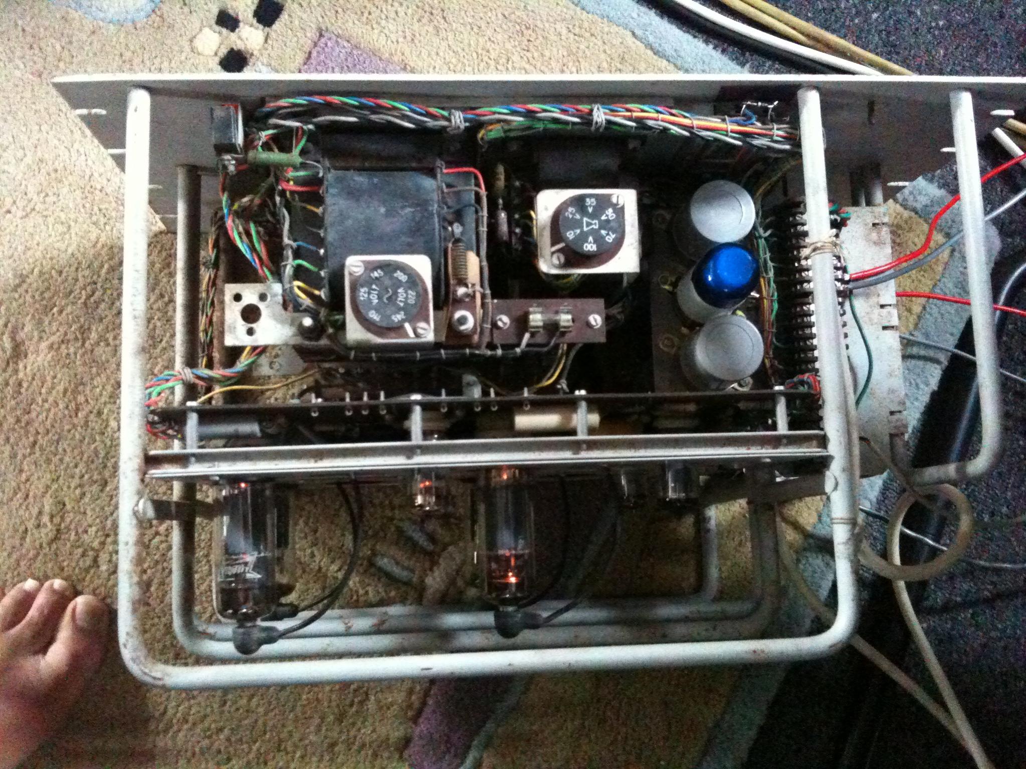

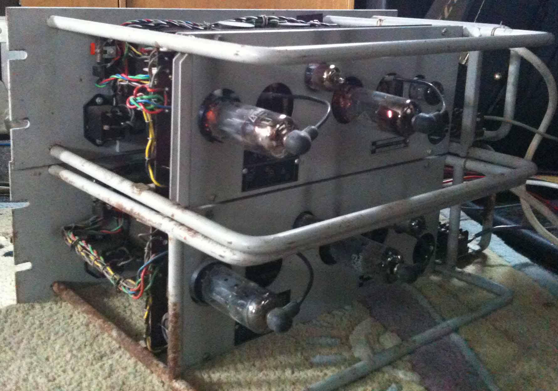

On Sunday, I repaired a pair of Philips EL6416 amplifiers that I purchased online. It took most of the day and I'm an excellent technician on this stuff!
These are commercial amps and have been rather neglected. They were dirty and have some rust on various parts. I'm not going to fix up the cosmetics, it would require complete dismantling.
One was distorting because of a faulty EL36. Unusually, it was warming up just the same as it's mate, but not producing any output. Usually a faulty valve will not get hot as it doesn't pass much current.
Many other things needed sorting:
1)Replaced all electrolytic capacitors.
2)Fitted trimpot to adjust output valve bias, so I could adjust to minimum distortion.
3) Found the amps made high distortion at low frequencies. For some unknown reason, the value of each capacitor feeding signal to the grids of the output valves was different. One valve had 0.47uF and the other had 0.047uf. This is consistent with the schematic. At low frequencies these have widely different capacitive reactance so the signal to each valve is different. This produces more second harmonic distortion as the frequency reduces. At 50Hz the distortion was around 5% with original values; after making both capacitors 0.47uf the distortion dropped to 0.6%.
4) The power output was low. Found the DC voltages were low. The selenium rectifiers were not performing well, having a high voltage loss. Bridged them with silicon diodes and the voltages came up to spec.
5) Adjusted bias to minimum distortion.
