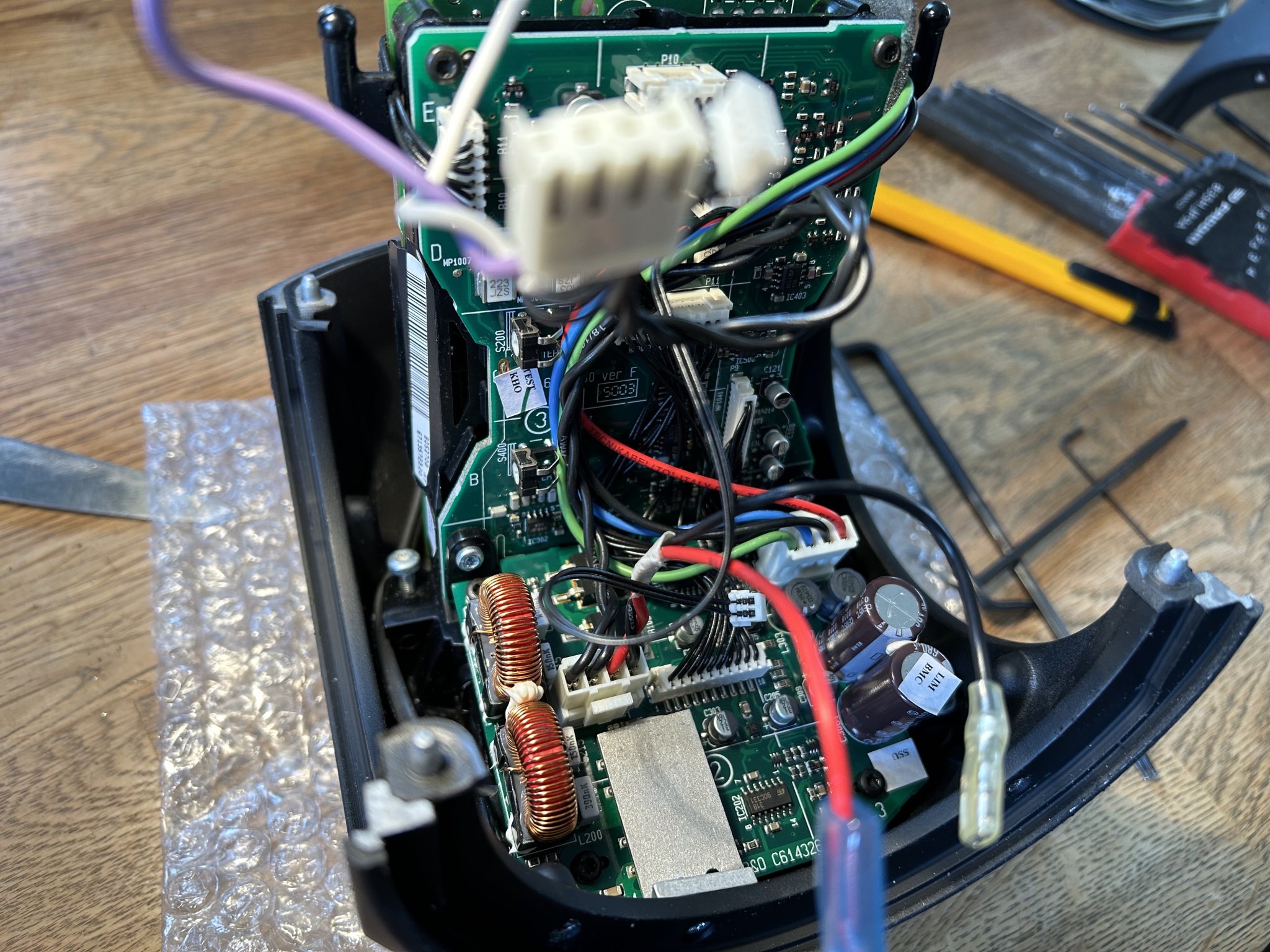

After disassembly (thanks to the excellent tutorial on Youtube), I quickly access the circuit board of the power supply.

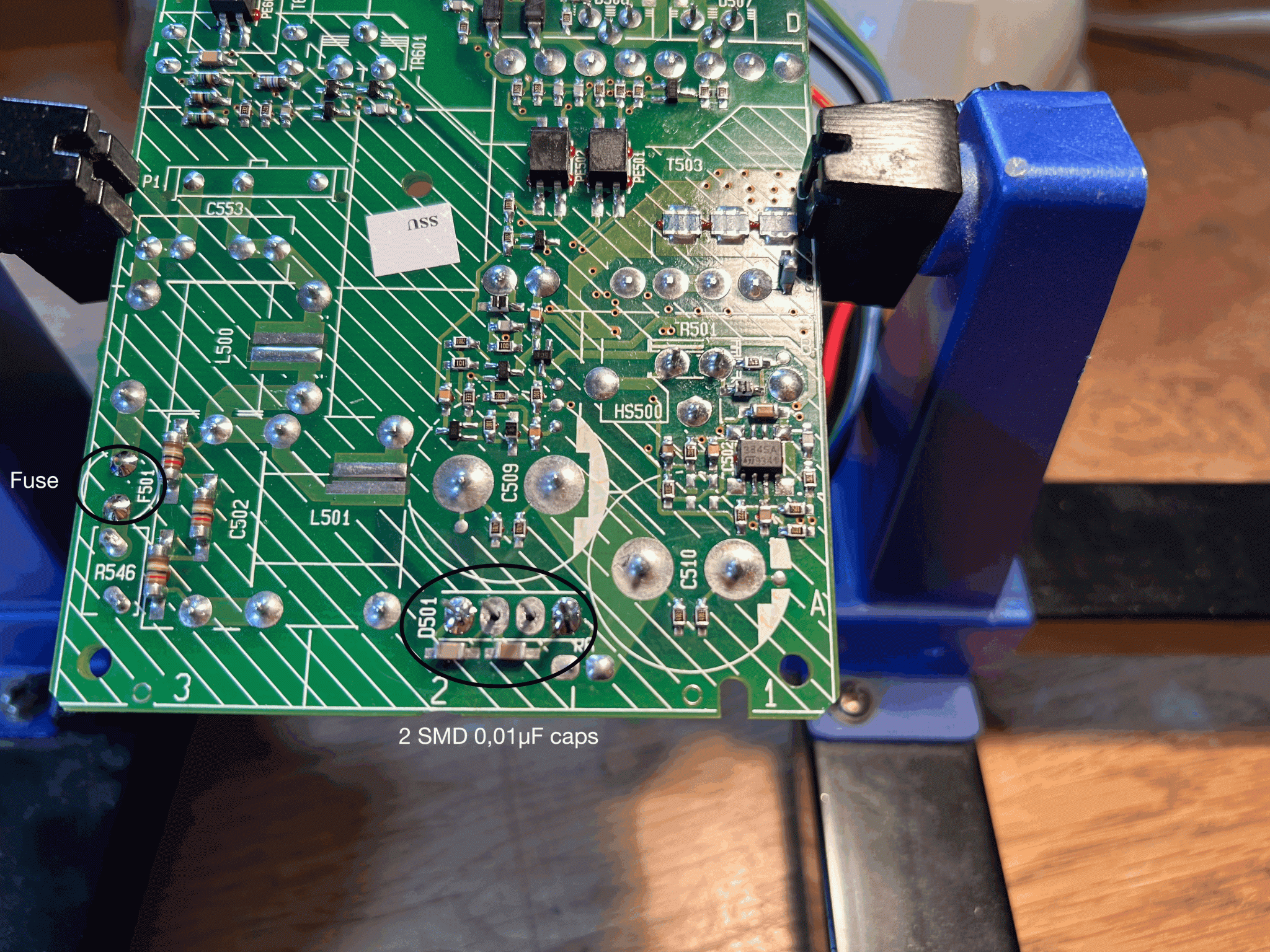

I can easily see that an SMD filter capacitor near the D501 diode bridge has exploded. I don't read any value or code, so I unsolder the second properly to measure it (10nF). I will change both.
I then take a look at fuse F501, it is cut, to be replaced! Not sure that the diode bridge is still operational, I unsolder it to test it completely out of the circuit, but during the operation I damage it. It's (solidly) soldered to the double sided circuit and my (low cost Chinese) desoldering pump isn't powerful enough to clean everything thoroughly, a pin in the bridge jumps out in the extraction. No big deal, I have to order capacitor and fuse, I'll add the bridge...

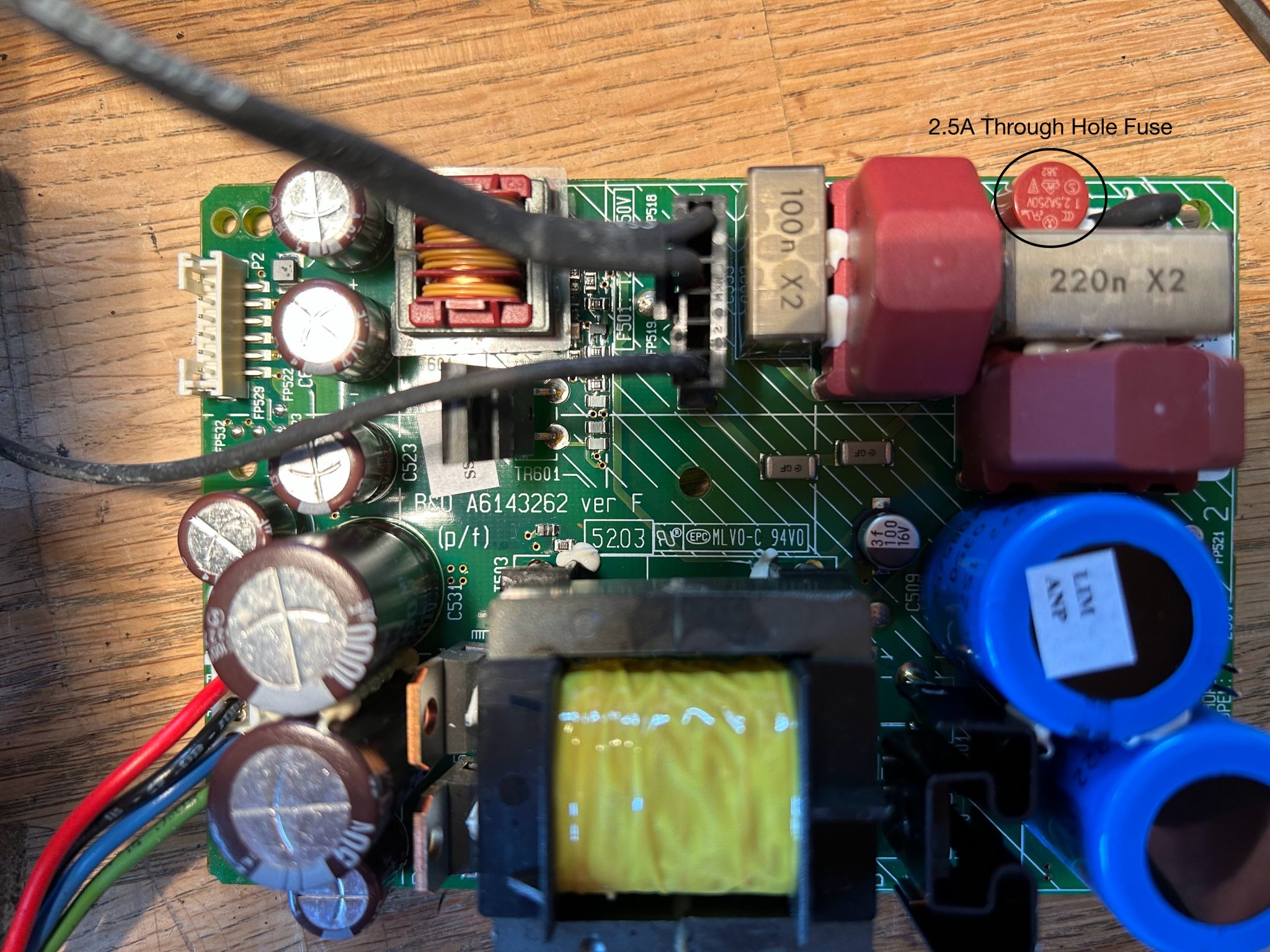

I receive the components in 2 days (thank you Mous.., perfect as usual), I resolder the 4 components (1 x Through Hole 250V IEC TL SL 2.5A TR5 series 382 fuse, 1 x KBP208G rectifier bridge, 2 x SMD Ceramic Capacitors 250VAC 0.01uF C0G 1206 10%). 2 photos: work in progress, finished:

A good way to deal with high thermal capacity board is to heat wide power trace near the pin you want to desolder with a soldering iron. Say, T12-DL32 will add 75 W to the desoldering gun, doubling its power capacity. Another trick is to debase lead-free solder at the pin with low melting point solder (Bi- or Cd-based). Yet another is to preheat the board to 120-150C with a 75-150W halogen floodlight.It's (solidly) soldered to the double sided circuit and my (low cost Chinese) desoldering pump isn't powerful enough to clean everything thoroughly, a pin in the bridge jumps out in the extraction
thanks @VoxCelestial for the tips. I often use the 2nd one, flowing lead-free solder before pumping/extracting, and hopefully its works often. Sometimes I hesitate or don't dare flowing too much, fearing I can't pump all that Sn/Pb mix...
I must admit that I'm much more cautious when I desolder a rare or costly component than a standard rectifier bridge!
But someday I'll get a real Hakko desoldering station (or equivalent) and it should work flawlessly 😉 (even a Aoyue!)

Hi @LasseW83 , I replaced the faulty capacitor with a 0,01µF Kemet CAN12C103KAGACTU ("Mouse" US website) for 0,38€ (bought five just in case...).
Careful when soldering, it's small. Check the F501 fuse too (round brownish through hole PCB fuse Littelfuse 38212500430) which has possibly blown.
