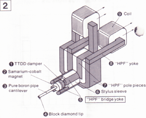

I'm loking a way to repair the original needle of Technics 205CMK3 cartridge. Issue is that the needle (cantilever) is now flabby (common issue for these).
Construction of the needle can be seen in attached image.
I suppose the TTDD damper material crumbled at some point long ago (now perhaps totally missing).
By user's guide of the cartridge, some visco-elastic material has been used. It says also that buthyl-rubber is commonly used damper material (least in late 70's). If I have understood correctly, material which I'm looking after is some sort of visco-elastic rubber.
I read somewhere that visco-elastic rubber has been used (an example) in the inner surface of tubeles tires.
Can anyone point me some suitable damper material which can be installed without dismandling the construction (not much space). Some instructions for how to DIY this would also be a welcome.

As I'm not familiar with cartridge construction basics, can someone explain it a bit (numbers from attached image);
- are parts 2 and 3 one construction?
- is the damper placed just between parts 2 and 5 ?
As there's zero info available over the material Technics used, should I try with some sealant based in silicon or buthyl or ?
2 and 3 are fixed together.
Yes thats where the damper (usually rubber) goes.
Not shown is the usual tie rod or wire, that pulls
on the end of the cantilever. Cartridges can get
"floppy" due to the damper disintegrating, or
the tie wire being stretched, usually by accident.
