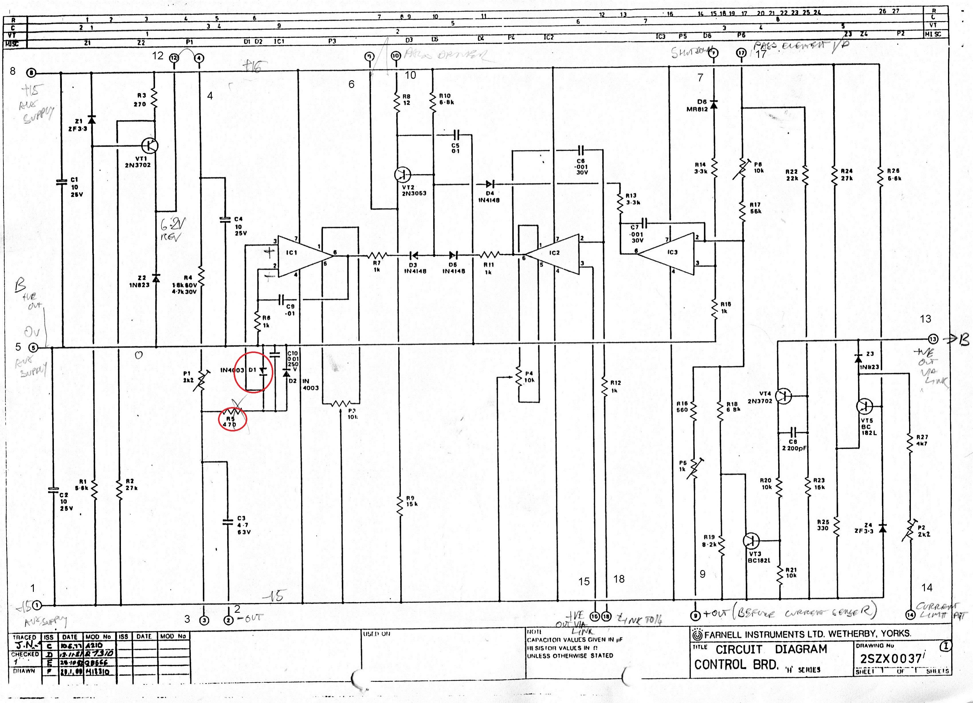

"Hi Chris .
You didn't say if D1 was open or short but (they usually fail shorted due excess voltage but they can fail open if you have put a large current through them )
Anyway I would say yes a shorted pass transistor could cause R5 and D1 to fail (and possibly p2,p1 voltage adjust pot if your unlucky) due to excess current through those devices .
Explanation :- If a pass transistor is shorted then V output would then be at max and someone would try to reduce ouput by turning V adj to minimum value ,now since the +-15V aux supply gnd rail is tied to main V+ out (so you will now have 60 V between this and -Vout) so now an excessive current will flow through D1,R5 via P1-P2 voltage adj control (which now is set to a low ohmic value when you tried to turn voltage down )back to -Vout .
Note that a failed D1 on it's own ( D1 is shorted) could also cause R5 to fail because the output could again be at max V (this time the inputs of IC1 would be shorted together by D1 and so IC1 output would be stuck at one of the supply rails due to it's own input offset voltage ). Again trying to adjusting the output voltage down would cause large current through R5 ,P1-P2 to -Vout ."

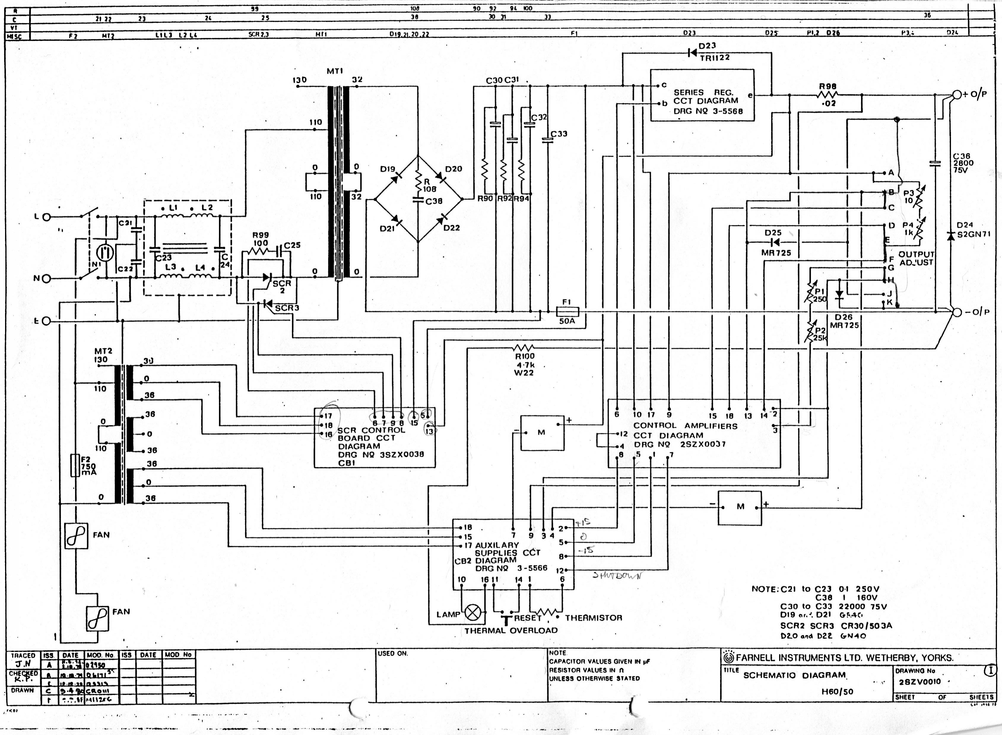

I can link to the schematics for both my machine, which seem to match it 99%, and for the earlier one with all discrete components instead of op amps and IC Scmidtt triggers. I have the manual which explains the topology of the earlier version too. I can't remeber if I can post links here though...
Having rebuilt the pass transistor tunnel heat sink assembly several times, and it being costly and time consuming, I need a better way to diagnose this!!
Thanks for looking.
Schematics that match my faulty unit 99% fully, and the manual that explains the board functions, but is for an earlier version that uses all discrete components are at:
http://www.gatesgarth.com/supply.zip
The schematics for the earlier all discrete components version are at:
http://www.gatesgarth.com/H60-50_Diagrams(2).pdf

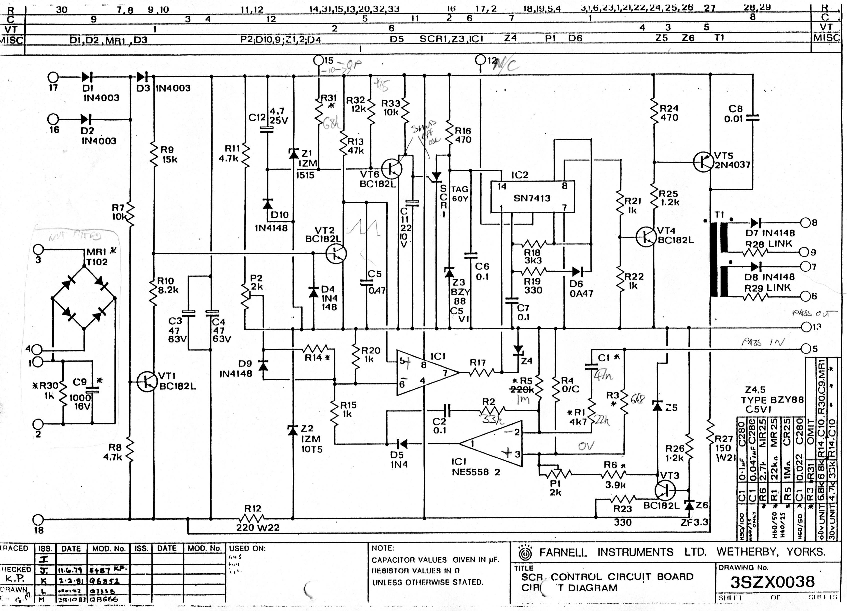

If you don't have a circuit description then yes it would take a while to sort through the control interactions.
You could disconnect the series regulator, and place a pot between the raw DC output (5) and 0V (15), with the wiper connected to (13), and place a load (eg 50 ohm 100W) across the raw DC (so that the SCRs fire ok). The aim is to fool the SCR regulator to think the series reg is there, as the SCR control circuit seems to phase reg just on some characteristic of the raw DC voltage and the output voltage of the pass reg (no current limit or current regulation control). That would then allow you to probe around the SCR reg circuitry and try and describe its control functionality. Working out how the phase regulation and SCR driver work is not a concern, unless their is a fault in that part of the circuitry.
You may not be able to remove the gate drive signal pairs, and probe them with an oscilloscope to confirm an appropriate pulse signal that is synced to the mains, and phases on smoothly, without a suitable output voltage levels - you may need to simulate them seperately with a simple 70VDC supply and the pot.
Just don't go probing the SCRs directly with mains applied! The gate to cathode of each SCR will have a measureable low resistance to check firstly. The SCR pins can be a connection problem over time if they are only push on connectors. And don't mix up the phasing of the SCR drive cables, or the AC voltage connections to the SCR reg pcb.

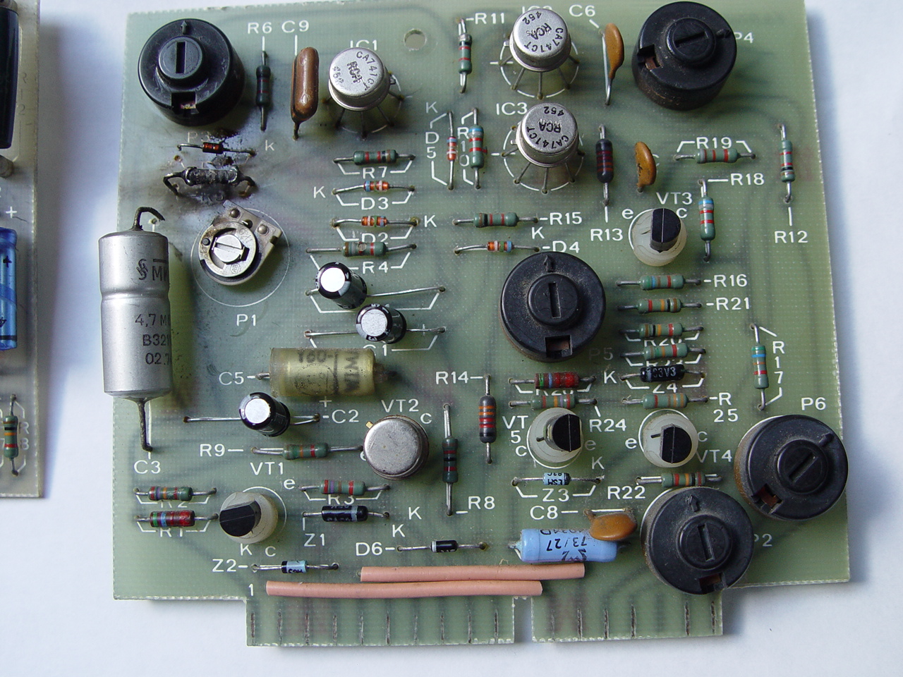

Rebuilt pass block with new 2N3055 to replace shorted one, tested all others, and tested again as an assembly before fitting. Checked with analogue Ohmeter front panel Volts control pots were not intermittent across their full range of movements. Disconnected bridge and smoothing caps from pass block at red line see http://www.gatesgarth.com/H60001a.jpg Base and emitter links to pass transistor block still connected. Wires to the two pass driver 2N3055's still connected. Input from 10 and 17 on Control Board left connected to bridge output, as well as to 15 on SCR board. Metering with DVM at output of full wave bridge, no load applied, the Volts knobs smoothly increased / decreased bridge output from a minimum of about 8V to a max of about 65V. Seems SCR stuff is working OK? No problems.
Left voltage from bridge at just over 8V.
Linked pass block to bridge with THIN croc lead, (at red line on H60001a.jpg) no real spark, no heating of lead but almost instantly Control Board R5 lit up like a bulb. Schematic at http://www.gatesgarth.com/H60002a.jpg Checked the pass transistors en bloc again with Peak transistor tester and all still good. One previous time that this fault occurred the main 50 Amp fuse blew. Cap or diode across output of supply intermittently faulty? I checked D24 when I rebuilt the pass block, again with my Peak tester and it seemed OK. Haven't tested C36 but it's on thin leads from what I recall, so would open them with over 50 Amps and shorted, I'd have thought.
Can I test Control Board output on pin 6 and inputs on pins 9 and 10?
Looking at Control Board again I lifted one leg of each of C3 and C5 My Peak ESR meter showed C3 as 4.9uF zero ESR but C5 was only 47nF on a Philips capacitance meter that's actually in cal still.
Thanks for any advice based on this, I can rig up a load tomorrow, if needed.

For R5 to have burnt control board pin 3 must be shorted to something really nasty! I cannot see the diagram as I write this but I assume the two pots (P1 & P2) in series on the main schematic are the coarse and fine adjustments, these could both be fully ACW contributing to the problem. I would check the wiring on the A-K terminal block or whatever it is very closely. A few pictures of the whole units internals might help. You don't say what your using it for, maybe given the age of the components it might be worth considering using the thyristor section alone as its working ?

This information isn't very helpful. The output voltage cannot rise uncontrollably during an output short circuit event. Does the supply blow up at turn-on, or after some unpredictable period of normal operation? Does the failure only happen when you are running at full output?It's taken to blowing pass transistors. What happens is I power it on and often it works fine. I often run it at the full 60V output with a current draw of about 35 to 40 Amps. Occassionally, and seemingly more frequently, it will have uncontrolled volatge output, quite how high it gets I haven't managed to catch, but the 60V meter goes off scale.
This could be a description of latching behavior, not component failure.If I am very quick to turn it off it may work fine again.
...at what load will this happen? Is it possible that a direct short develops internally? What about the load? Can the load present unpredictable zero ohm condition across the supply? It is possible that the supply suddenly loses all ability to regulate output voltage at the pass transistors, but design redundancy would probably shut down the primary SCR's at minimum. These supplies are very complex and if working properly the current control will not allow massive over-current conditions. Therefore I would spend some time thinking along the lines of the current sensing section. The supply will not just blow up unless there is an internal or external short that draws massive current, while at the same time allowing the regulators to run wide open.If I am not quick a pass transistor or two fails shorted and takes out D1 and R5 on the "control board".
I would not go speculating on all the different ways an industrial power supply might fail. The SCR primary control simply runs the secondary regulator stage at a more efficient input voltage. The supply would still be OK even if the input SCR's were turned on all the time. This would not result in the dramatic events you are having. I would say there may be two problems. One is an unpredictable internal or external short circuit. The other one is a fault in the current sense/current control section which allows a massive over-current condition. You should be able to crowbar the output of this supply without damage. Finally, I think there are a number of better choices for output regulators. If you have to replace parts, tossing the 2N3055's would be a great plan!

Just realised that like a *%$@~ I have put the wrong schematic for the control board in my first post, I put the one for the SCR board up as well as the overall schematic. This is the Control Board with the troublesome r5 and D1. I just had a look to see how it was doing on soak test and ran a infra red thermometer over the boards. I see C3 on the Control Board (also photographed in an earlier post) is heating up and sat at 40 degrees Celcius. What type of cap *IS* C3? My Peak ESR mater seems to see it as an electrolytic, but there's no polarity markings on the schematic or the board...
In case the schematic doesn't upload the link to it is http://www.gatesgarth.com/H60002a.jpg
C3 appears to be an electrolytic. If Vout went to max, then the voltage across C3 would appear to be that voltage, if the 0V rail of the +/-15V supply is at Vout, and terminal 2 is at output 0V (as shown by the hand-drawn link in the total system schematic), and may also have had ripple current through it (limited by 470ohm crispy resistor). If you measure the AC voltage across the 470ohm, then that will give the ripple current, and you can check against capacitor specification for ripple current. It looks like the polarity of C3 was correct.
