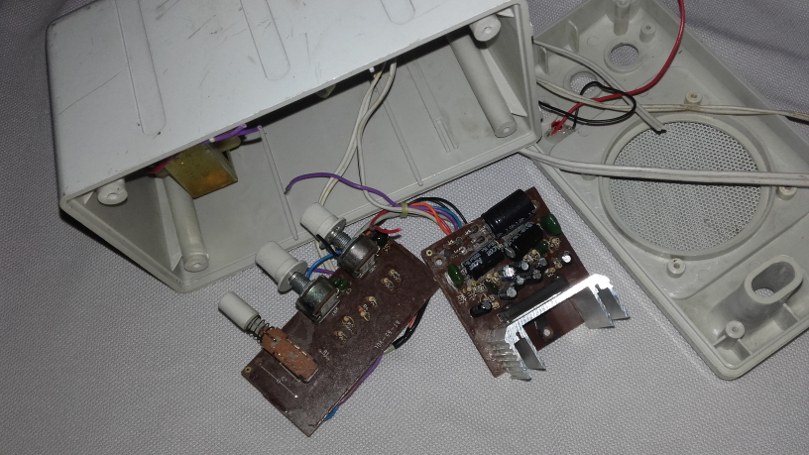

This circuit is not working, uses 120 V AC but was probably connected to 220 VAC which caused a minor overload.😉

I tried out the following:
Cut the AC input wires from the transformer and connected a 9V battery to the terminals.
No output. Some crackling noises when the battery terminals were touched with the wires.
No contact across switch. Removed switch and shorted wires. removed input wires - they looked burned out and shorted. Connected input wires to the bass and treble output. No sound yet.
Maybe it is the diode bridge? Will find output from diode bridge and connect the 9V to that, but with the correct polarity.

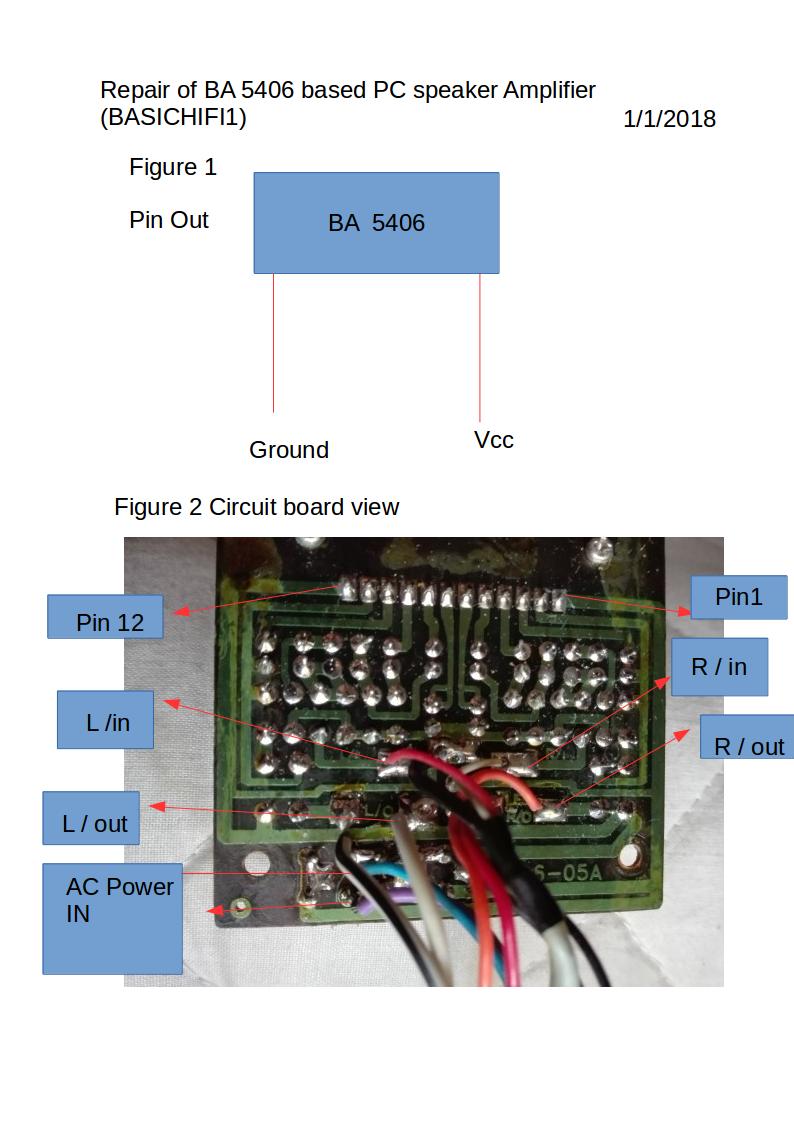

Photo of the circuit board and connections. Some of the labels are visible, some can be deduced from the original wiring.
Test :
1) Connect 9V to the AC in wiring and check if Pin 1 on the BA 5406 receives any power, ie check voltage between pin 1 and 12.
2) If this is OK, then connect an audio source to input and check if there is an output signal on each channel.

Connected a 9V battery to the purple and blue wires which were originally attached to the switch. Why 9 V battery? Because I do not want to risk burning out any power supplies by shorting the wires. Seems a safe way to test.
Connecting was a bit of a hassle, but 9V showed up all the way up to the Diodes. Voltage across pin 1 and pin 12 of the BA was around 8 volts, so it is receiving some power.
Next step: input / out output signal. Of course this was the original problem.

Testing: Connected a 3.5mm jack to my phone, and connected that to the input wires. Continuity was tested of the 3.5 mm on one channel to the input points the board and was OK. Next connected the output wires to a speaker - nothing, some crackling on one side.
Voltage testing of audio output: With a different chip amp, tested the voltage readings with full volume. Only slight variations on the needle were noted, and seemed to have nothing to do with the music with the speakers connected or without. However there was some signal detected. Testing for output voltages will be difficult then, I suppose. The voltages inside the circuit may be higher though at some points. Further testing confirmed this.
Power on voltage testing: voltages across some of the capacitors was indicated, differing from left and right in one case, where the capacitor was loose.
Resistance testing: different resistances were detected.

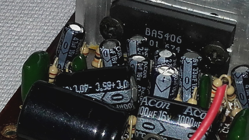

OK so more testing, this time resistances in circuit
There are about 18 capacitors here in the circuit. I started testing the resistances across the capacitors to check for short circuits or open circuits. These are all in -circuit so I was not likely to get correct values, however I did some checking of left and right channels to see if there was any variation between channels. There was no variation on the two capacitors I tested marked C8 and C1 both showing 100 Ohms. I gave up this line of testing because it was just too difficult to locate the pins corresponding to the capacitors.
I wonder what kind of innovator decided to build the current circuit board layout, with components on one side, labels hidden by components, and connections on the other side. In software engineering this is like having to look at the back of your monitor after running your code. Software troubleshooting is more difficult though, because of the components - custom made by yourself and non- standard, usually. Still, this circuit board thing is not a good user interface. Why not have the components and labels on one side, with the circuit clearly marked? Why use solder at all?
The next step was to test the resistance across the BA5406 IC pins, one probe on the ground and the other one on each pin.

What does this mean? With the symmetry of the circuit, it is unlikely that there should be two 200 Ohm resistances across the pins, one
of which is the IN signal, pin 5 and pin 8 are where the signal goes into the chip. Earlier testing showed that one channel was completely
quiet but the other channel showed some crackling at its output. At least one channel should work, then. And maybe one channel is burned out.
The next step will be to connect everything up and providing an input signal. But what input signal to provide? Ordinary music
barely moves the pointer, even at the amplifier outputs, as tested with another amplifier. I also needed to see if the input
signal could be detected on the meter. To this end I used a 3.5 mm jack with wires soldered to it, and checked the output
from an old mobile phone. Music ( Bee Gees - Staying alive) barely caused any movement, so I decided to try out pink noise
as a source, as there are no quiet moments in pink noise. This worked wonders as I immediately obtained noticeable swings of the needle
from the phone 3.5mm output, at full volume, and with the needle swinging into negative territory. So looks like we have our input signal.
Question is, will any of this damage the circuit or the chip? I plan to probe the input signal terminals and points along the way
for voltage values. I can test the input and output points on the chip and on the board, but not sure what to do in between.
Maybe trace the circuit for voltage values, but I need to identify which components are on the circuit diagram. Testing the output signal
from the amp chip will be able to tell me if the chip is working ok. Again, will this damage the chip?
From what I had learned in Physics at college level, the VOM will draw very little current, so it will not short the circuit and cause damage. This line of investigation generated more interesting results.
Pin 12 Ground, resistance when connected to:
Pin 12 Connected to Pin 1 25 Ohms
Pin 12 Connected to Pin 2 15ch
Pin 12 Connected to Pin 3 22
Pin 12 Connected to Pin 4 24
Pin 12 Connected to Pin 5 32
Pin 12 Connected to Pin 6 25
Pin 12 Connected to Pin 7 51
Pin 12 Connected to Pin 8 200
Pin 12 Connected to Pin 9 200
Pin 12 Connected to Pin 10 50
Pin 12 Connected to Pin 11 18
