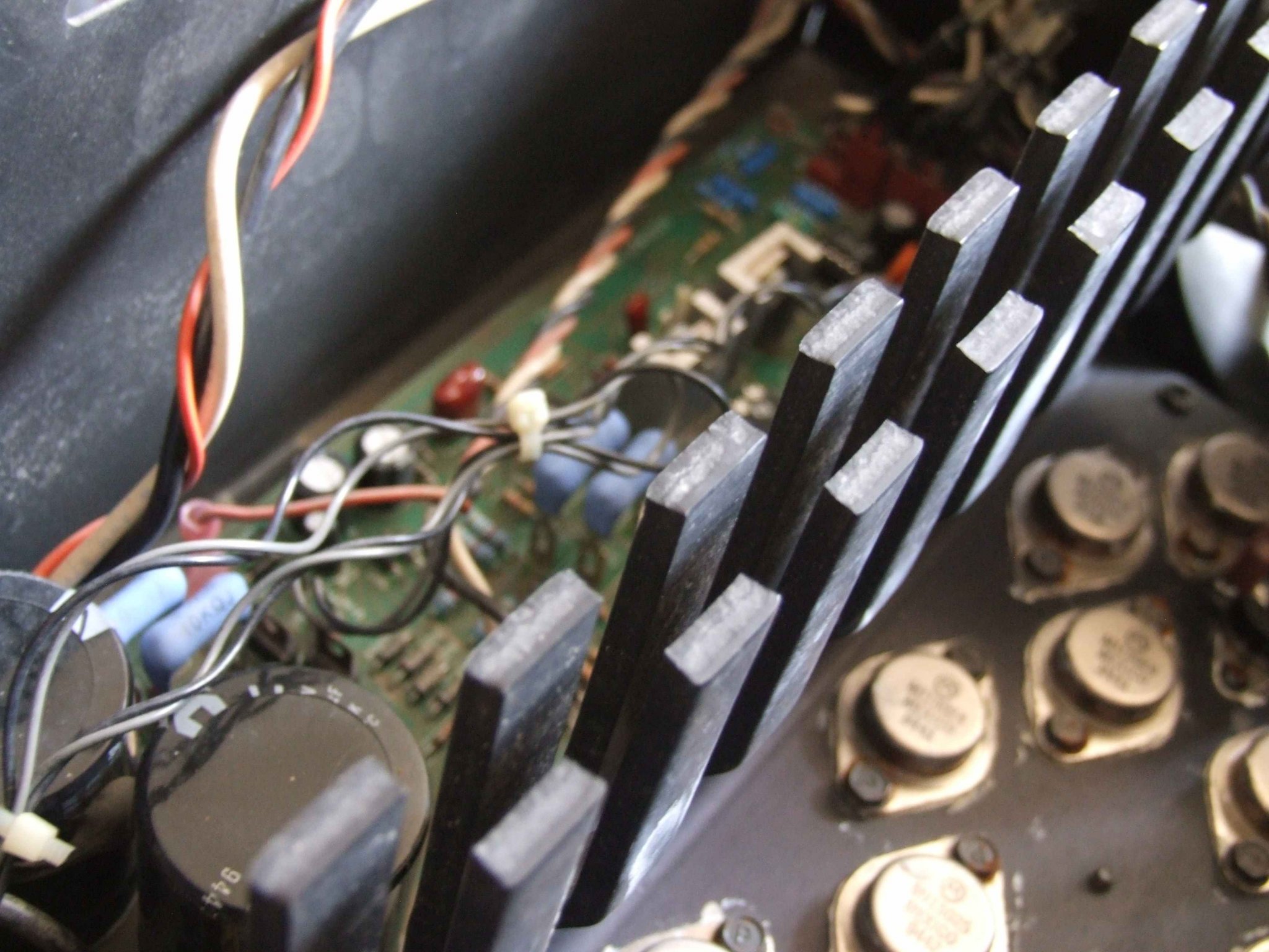

I opened amplifier. and I saw a heavy layer of dust. Even vacum cleaner can't peel off this aggregate. I will borrow air compressor and try again !

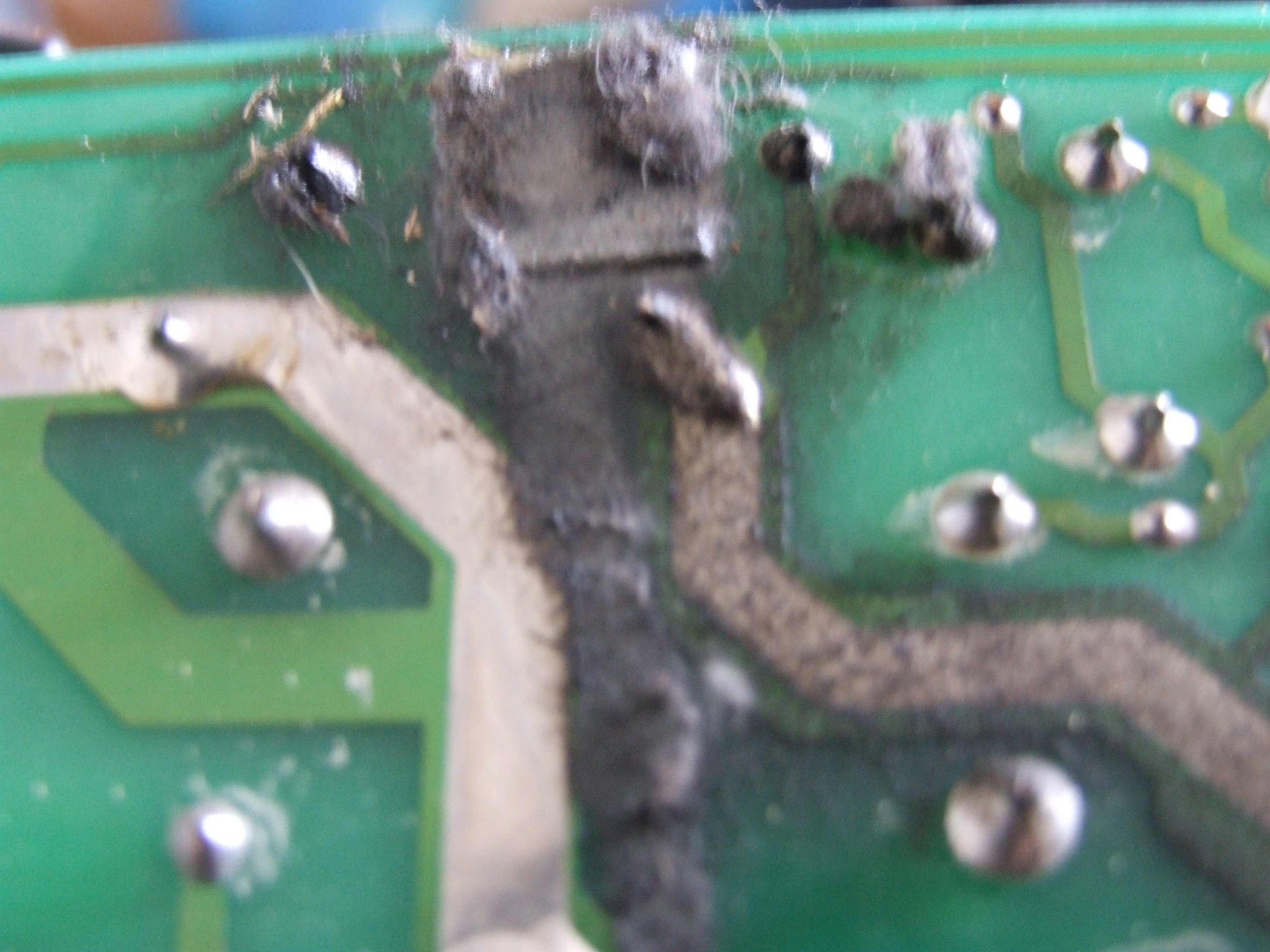

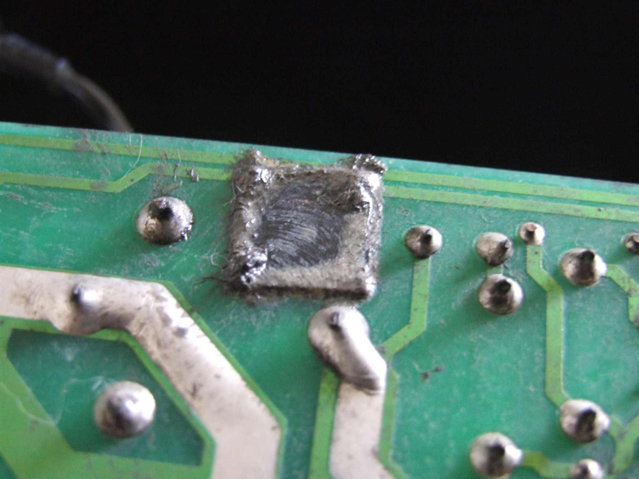

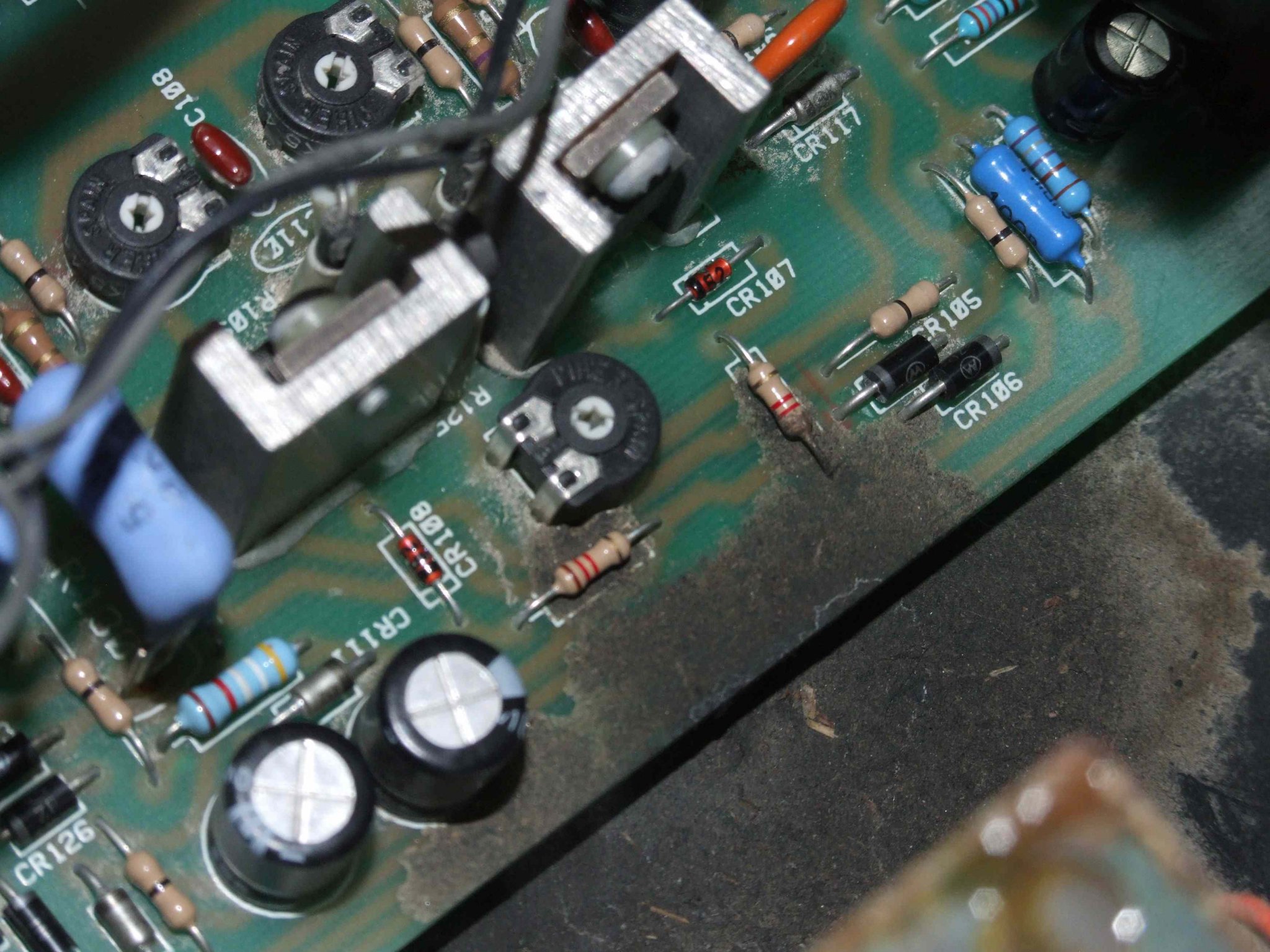

Cleaning was a success. I used a solvent and air compressor. This amp was installed near a kitchen of restaurant during 16 years. So dust with grease gave a solid layer :-(
One part pcb seems suspect. I don't know yet if pcb is damaged. I also read that Altec use glue and foam under pcb...

The pcb may not be damaged. It looks like oil stains from the kitchen.
Try squirting some Ronsonol. If it's oil, it'll dissolve.
I don't recall any glue or foam under the pcb.
You can actually remove the entire pcb. Just pull out all the Molex connectors.
With the pcb removed, you can clean the inside of the case as well.
Mike
That does look like a liquid of some sort got spilled into the amp. If it’s oil/grease it won’t be corrosive, if it’s something else it might. Beer or soda being the worst. I’d pull and clean/replace any components whose leads got contaminated, and physically scrape the substance off the board.

Pads were not stick on any composant and were fixed on the left/right sides of pcb. So for me, it's not for thermal raison but for spacing. I missed something ?
