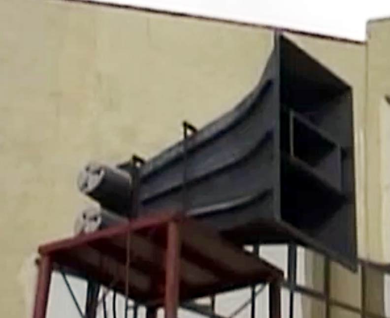

I have seen large side entry horns where the throat is basically a slot. Don't know who made them.
Here is a blurry photo of a side entry horn. Not really unity, as there is a high frequency horn down the center. Just to show that there are many interesting horn designs out there.

Pano that side entry horn looks a lot of like the "offset driver" horn you can model in Hornresp. This is also how the midranges/bass drivers can be modeld on a Synergy/unity horn. I guess the horn is hyperbolic so low inital flare rate?

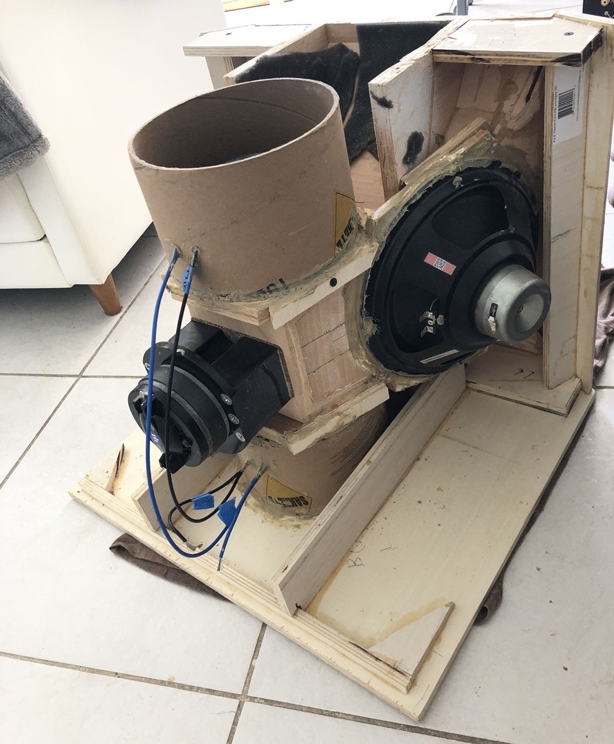

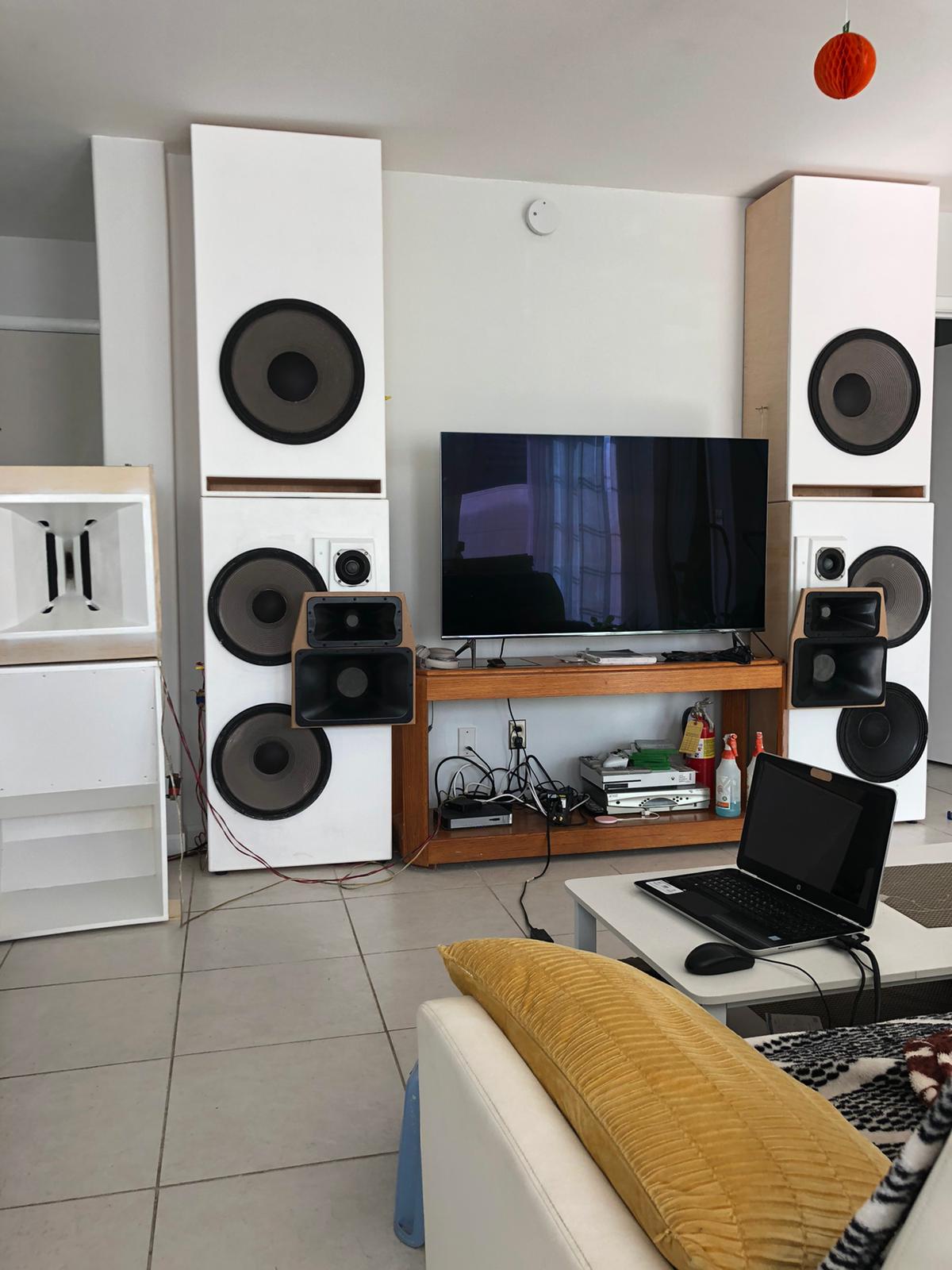

I had the R&H with one CD, two CoEntrant 6.5" PHL1070 and 18 Sound 15W700 under. Lately converted them in full Synergy replacing 15" with 2 10" B&C.
Mids are in the tubes.

cool setup grec13, whats the lower wave guide near the TV? CMCD of some kind?
so your RH box stock had two 6.5" drivers fed in the vertical slots and you added 2*10" drivers that go into the ports?
Also whats going on with the compression driver mount/throat? it looks very unusual externally.
