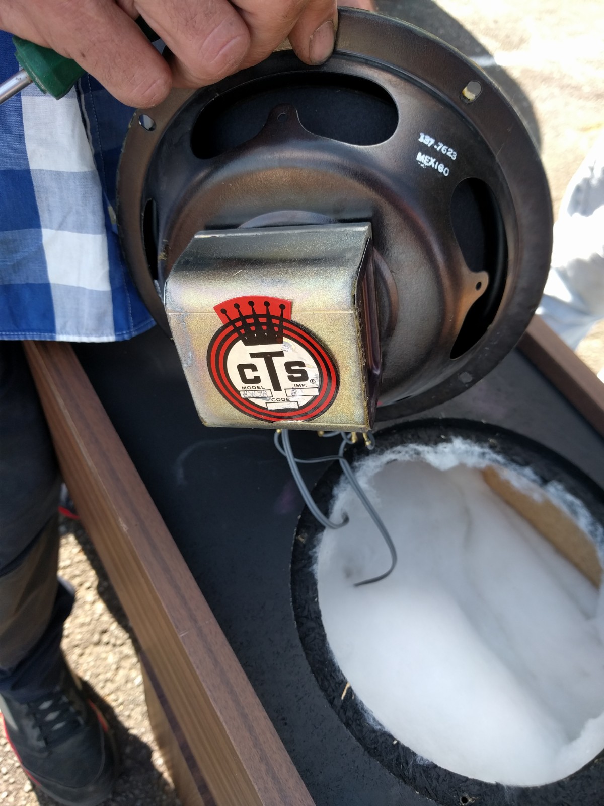

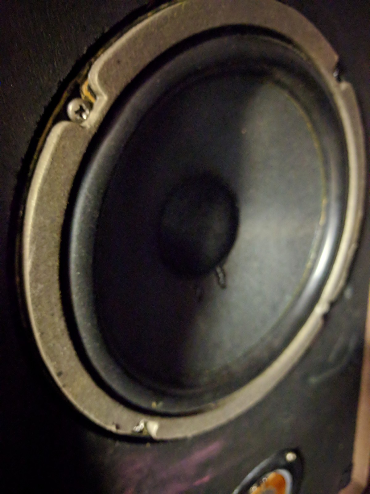

Hi All.
I'm having a go at restoring 2 Loudspeakers.
They are of 2 way design featuring cTs Model 8W9R Woofers.
The Woofers are fitted with rubber surrounds.
To improve sensitivity I'm considering the removal of the rubber in preference to foam surrounds.
Removing deteriorated foam surrounds is straight forward.
How should I go about removing the rubber types without damaging the cones?
thanks
Cliff

My 2c:
you will not improve sensitivity by much, maybe 0.5dB, sensitivity alone should not be your main objective.
when a rubber surround ages it becomes stiff and raises Fs and also changes other parameters.
this alone is a good reason to replace old rubber surrounds with foam.
how do I know? I've done it many times, specifically Vifa poly midwoofers that suffered from stiff surrounds.
also have replaced doped fabric and paper surrounds with foam and always getting a good outcome.
in all the cases T/S parameters were brought back to nominal values.
rubber is not more sensitive as some people believe.
it's heavier and the driver's sensitivity will be lower with also lower Fs.
in my book worth the effort especially with those Alnico drivers.

Keep in mind there are different types of foam as well as rubber. Aging deterioration is another topic. I have compared stiff foam with compliant foam, thick rubber with thin, and also vinyl rubber which is the least compliant, butyl being the most but heaviest. The important factor is to maintain original design parameters. If you change the behavior/characteristics of the surround, you change other parameters also, some more important than others.
The general design principle is that cones prone to break-up, eg. paper, use a higher damping surround to absorb energy travelling to the circumference, they preventing it returning to the centre, hence various rubber materials.
Foam is used in designs in which the cone is more self damping eg, polyprop, where this energy is damped and dissipated by the cone itself by design, on curvilinear cones, and so does need as much circumferential damping. Your paper one looks like a curved design also and will probably be a higher Q material. If you use foam it will reduce required absorption of the unwanted radiating energy and increase coloration.

It depends on many things Cliff.
Some rubber surrounds will peel off easily with a bit of help with a sharp hobby knife.
With paper cones sometimes I had to cut it off carefully around the cone circumference and clean as much of the remains of the old surround as possible without damaging the cone.
It is a time consuming exercise and also requires a lot of attention, sharp eyes and good light. I never use chemicals, too great a risk of causing other problems that cannot be seen and rectified immediately.
