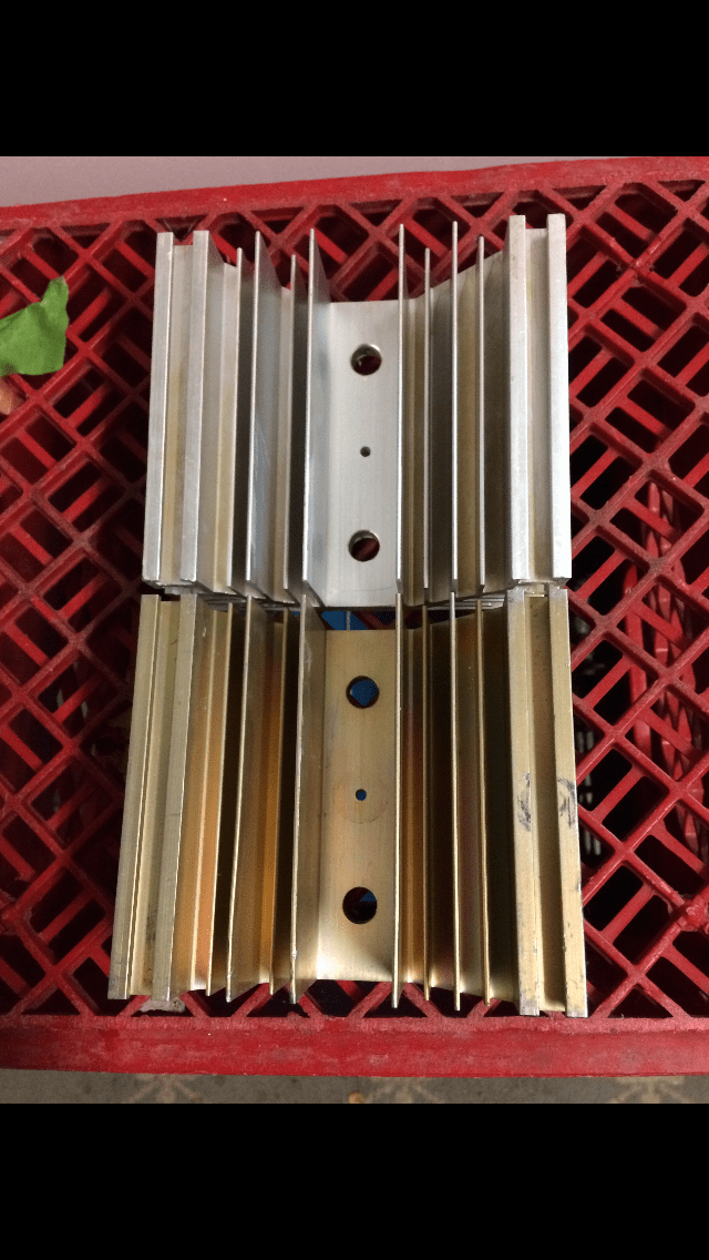

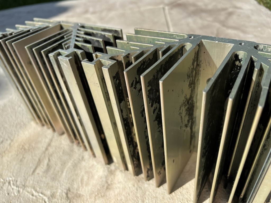

I have a couple of nice big heat sinks that someone did a terrible paint job on. I was able to remove most of it but not all using Aircraft Remover. I would like to get it all off but don't know what to do at this point.

It doesn’t look like a lot of paint, I would use paint/varnish stripper and brush with steel brush.
Or blow torch it and steel brush.

Normally Aluminum is anodized not painted as paint must be used with an acid etch primer to adhere to aluminum.
To remove anodizing, you soak the piece in a lye / water solution. Drano is lye with bits of aluminum. Adding water gets the nice caustic reaction. You can filter a Drano water mixture to get rid of the aluminum.
Pure lye is a bit more difficult to get these days as it was being used to produce illegal drugs. But it is easily available on the internet.
Lye does dissolve aluminum, and can burn your skin, so proceed carefully. Gloves, a face shield and mask are useful.
If you are sure it is paint, methyl Ethel keystone (MEK) is sold at many places such as Home Depot and will remove most paints. Some caution is called for as it just may be more hazardous than lye.

If the remaining finish is anodized, then only lye will remove it. MEK first will show if it is actually paint.
I would not use etchant, once the anodized layer is removed from aluminum, it is pretty reactive and soft.
Abrasion, baking?
Too hot may cause distortion.
Or leave them alone if not visible.
