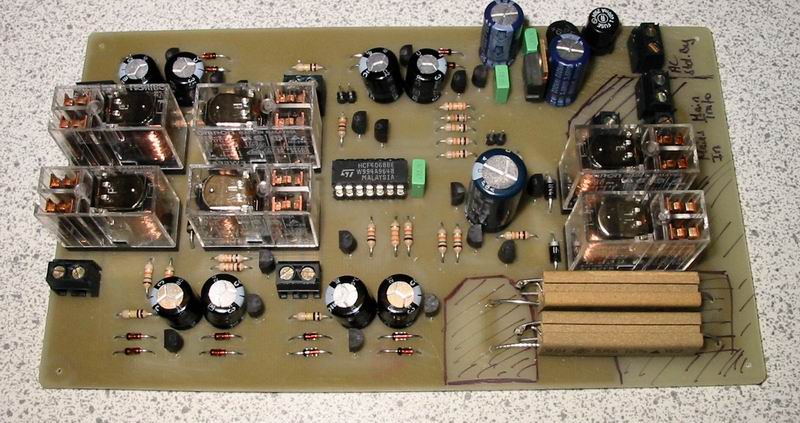

Hello,
I made this module that both has slowstart DC protection and mutedelay on start.
I use it to start 2 500VA transformers and 320000µF @ 55V
It needs a "stand by" transformer, but has an on board 12V regulator.
\Jens

Jens, can you post a schematic for it, please? Does it require a ±12V supply, or will a single supply work?
I'll see what I can do for schematics.... I have to dig it out from a backup disk, since I have changed computer since I made this board.
It only needs an AC of say 15V. There is an onboard 12V DC supply on it, this powers the relays and control cricuit.
\Jens

Nice looking board Jens. I like the idea but I don't have room for a second transformer.
