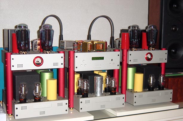

When I was living in a rural area and had a lot of trouble getting decent connectors surplus, and they were too expensive, I started building vertically. Seperate chassis and the cabling is internal. In my last design I used a vertical slat type grill to keep fingers out as my inquisitive nephews poke at things but still allow heaps of ventilation.
The preamp is the middle one. These aren't mine.
WOW:bigeyes:
That is a pretty set up........
Not too sure about the multi coloured design though.....😀
If the reason for removing the power supply from the amp stage is to remove its potentially damaging effects, would placing them directly underneath really make that much of a difference?
The proximity in those shown must only be 10 cm more than them being in the same chassis...
