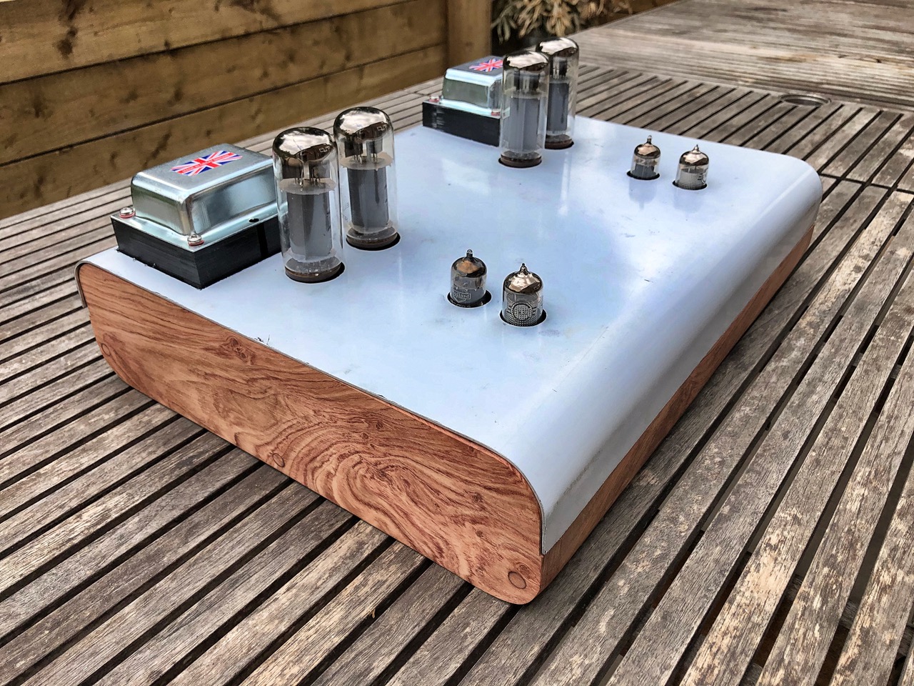

I'm building a Claus Byrith 4-30 (updated Mullard 5-20) and want to have a front mounted mains switch for convenience, but I don't want to run 230VAC to the front of the enclosure, and risk all the extra mains hum it will likely cause. Has anyone come up with elegant solutions for mounting the mains switch at the back where the power comes in, and linking it mechanically to a front mounted button of some kind?

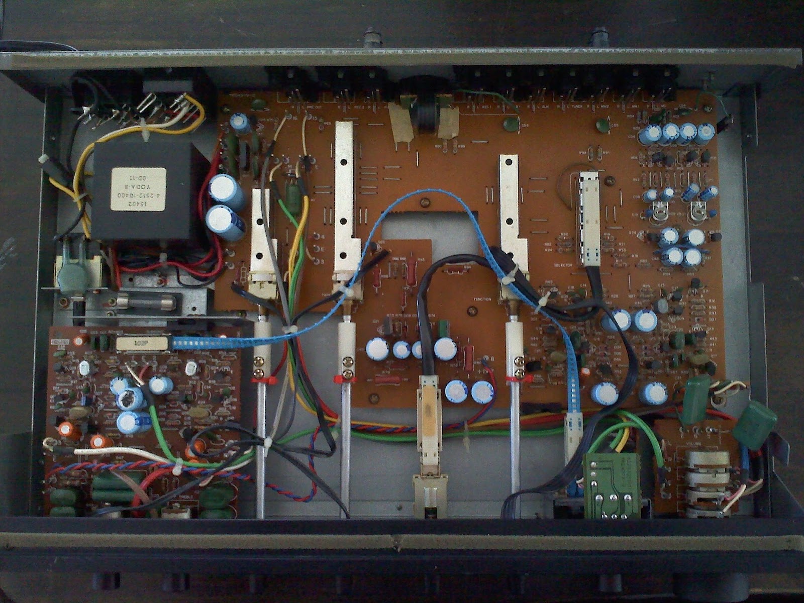

Push (or maybe rotary) switch inside the chassis close to the rear AC inlet and the long rod connected to the button (or knob) on the front panel
