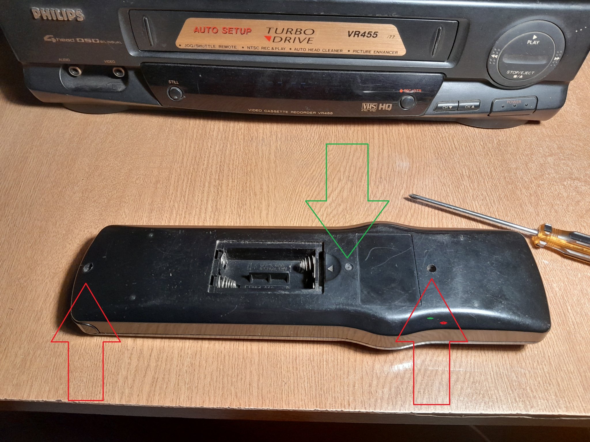

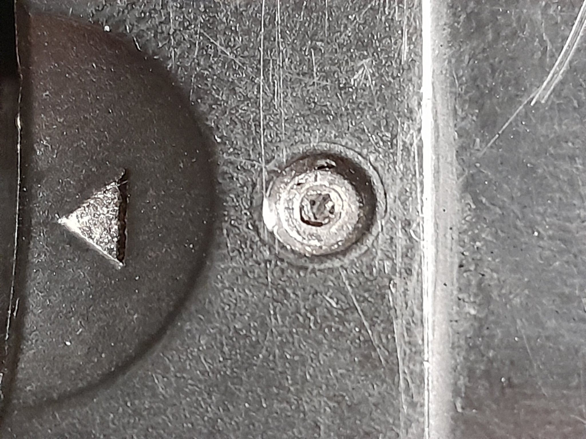

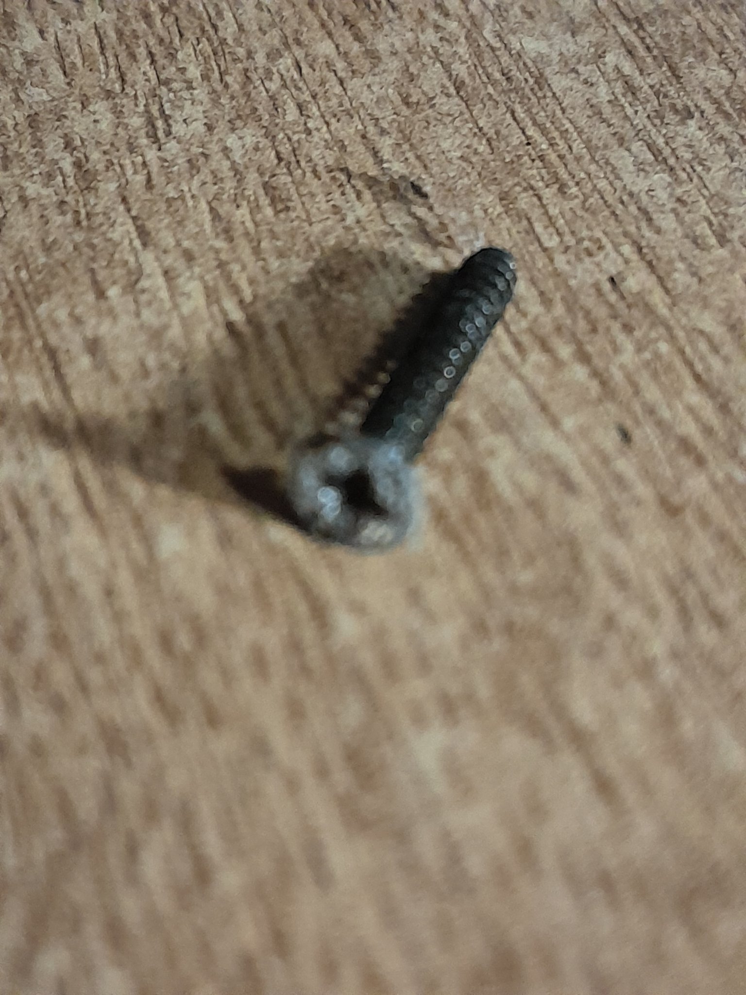

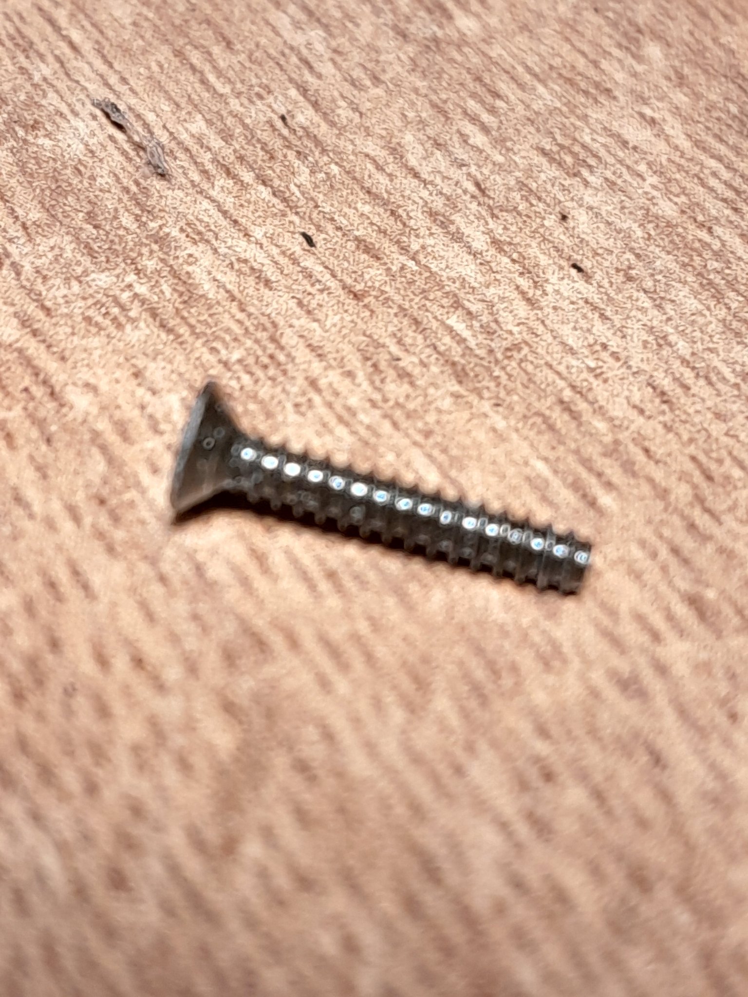

I'm trying to open this CR for a Phillips VCR.
There are only two screws (red), and after removing them, I tried to separate the parts by applying pressure with a plastic card. It's not possible. I'm asking the older technicians who have worked with these devices: Is it possible that the plastic rivet (green) needs to be removed?
Thanks in advance!

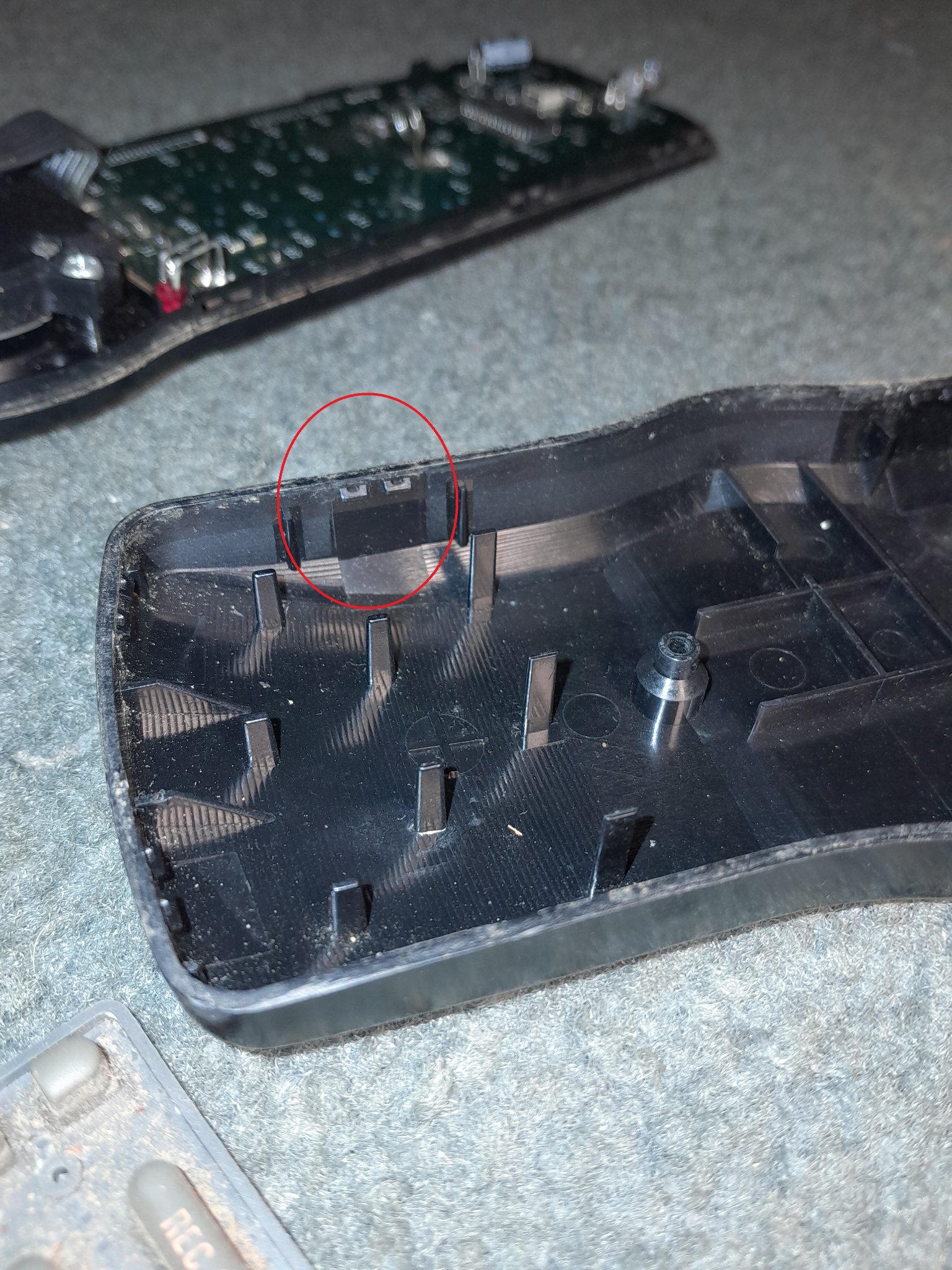

Most cases like this have clips along the circumference. You don't know which direction, so you must bend the side of either the upper part OR the lower part outwards. Best to try this is to pry a small screwdriver in between the halves. Push it between the two halves, lift the screwdriver upwards and bend out the side of the lower part. If nothing happens, reverse the direction so you can bend out the side of the upper part.
In some cases you only can find out when you unintentionally broke off all clips in this process. It is not a big deal since the two halves can be put together again using the screws. But it is not as neat.
Most such items have molded clip s along the border, the svrews are a secondary lock.
Use the widest blade that will fit in the groove between halves.
The interior, after removing battery cover, will give you some idea of what has been done for that particular item in molding and assembly.
Do not use excess force.

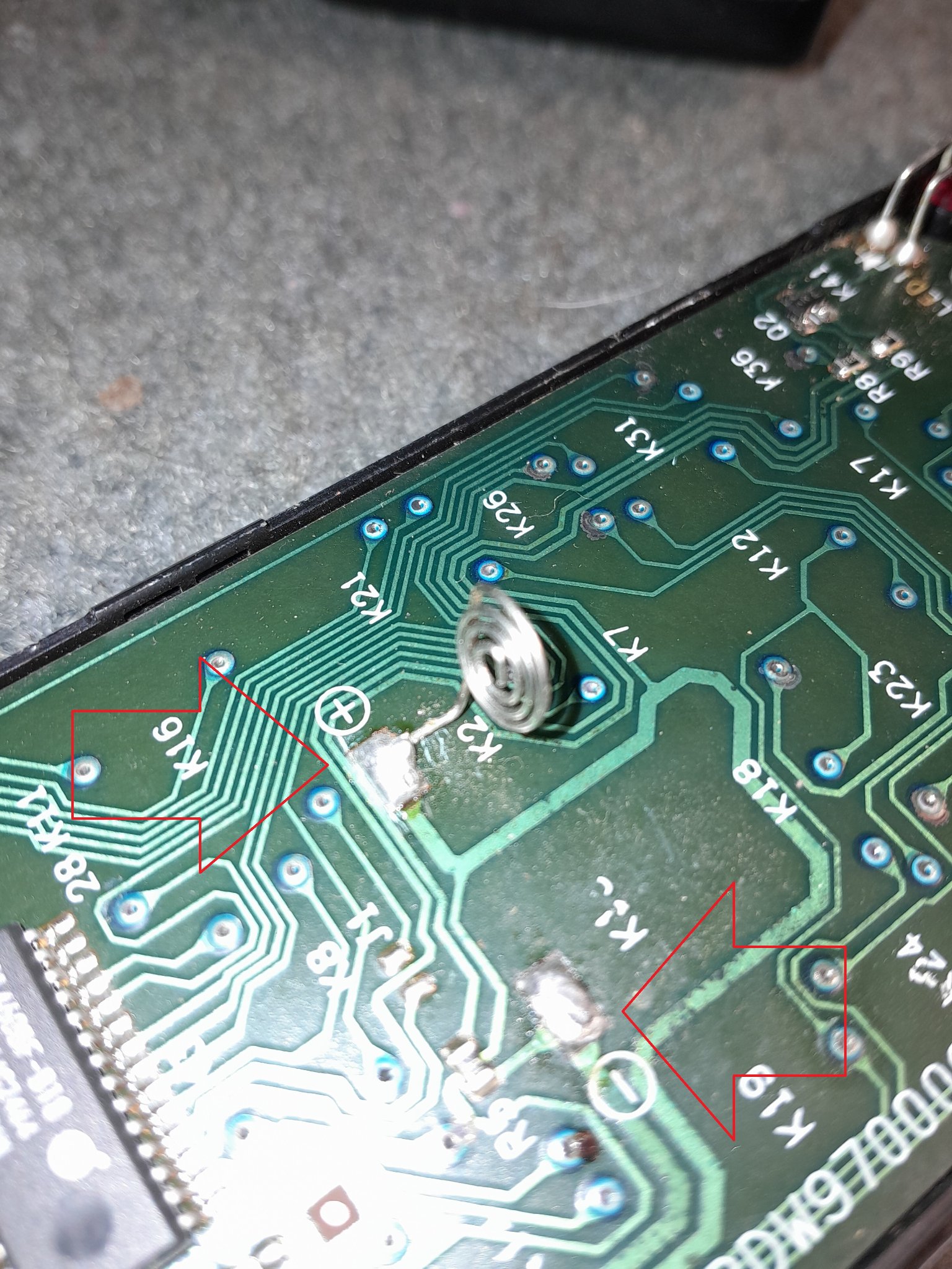

Clean and dry the parts, including PCB and pads, with dish wash or hand wash LIQUID soap.
Check battery terminal joints on PCB for dry joint and corrosion.

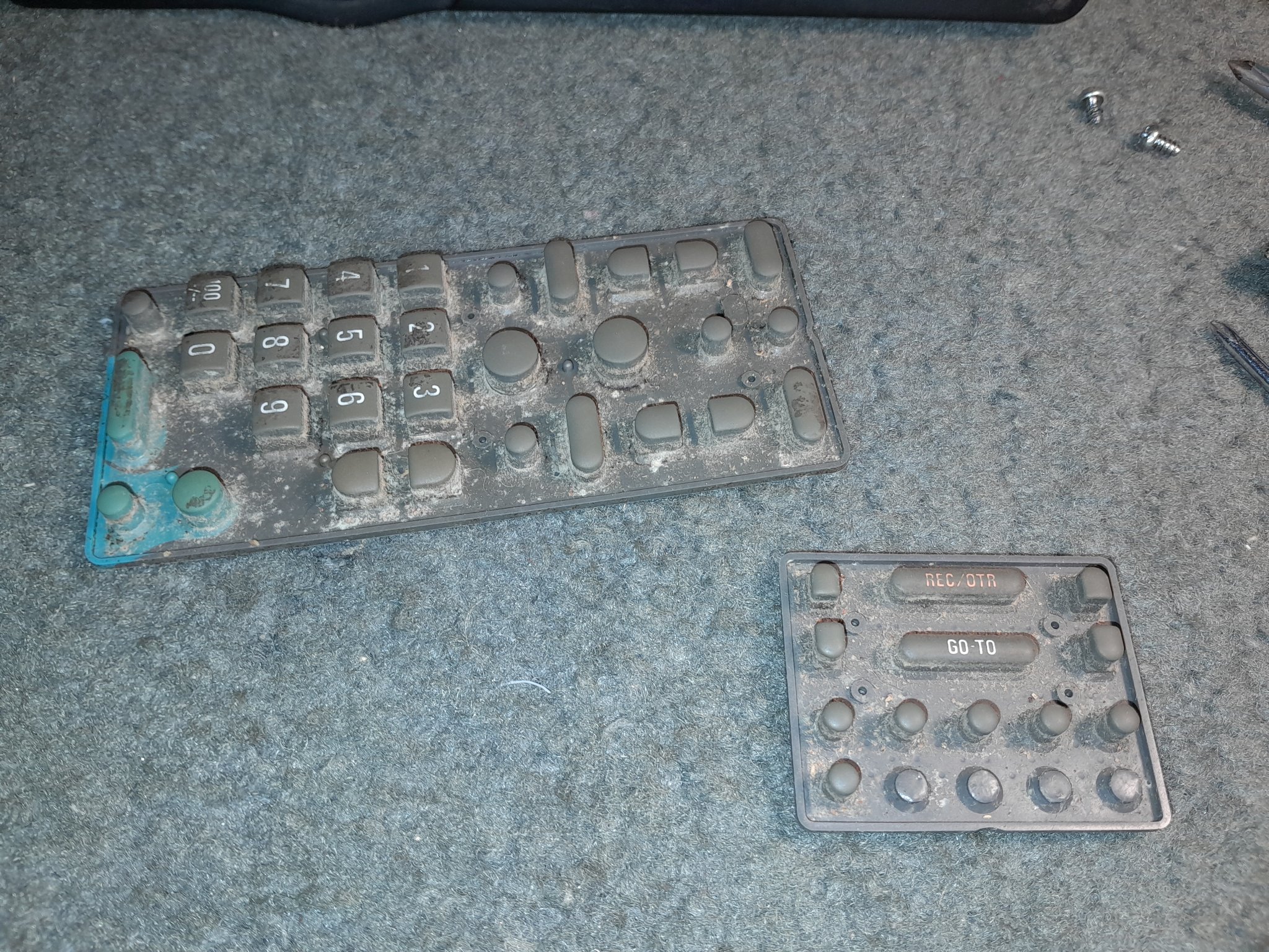

There are also available conductive pads and ink to repair the keypads.
The PCB to keypad surfaces get worn out, or coated with food residue like oil, vicible on the most used keys. That happens after a few months or years of use, and other failures can be after dropping or long term non use.

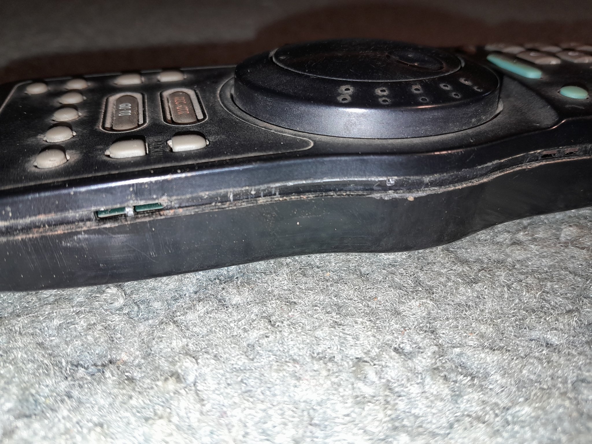

Thanks for the replies. I've opened many CRs before, but this one is holding up. The screwdriver only damages the edges, but it doesn't open even slightly. It's a very rigid plastic, not flexible at all. What do you think of that plastic "rivet" in the center? It looks like something along the lines of "if you open it, we'll find out, and you'll lose your warranty." It's late here; I'll upload photos of the edges tomorrow.
Dril out the rivet with a pin vice or drill press, hand drill may wander.
Then try a gentle edge heat with a hair dryer if that does not free up the joint. Too much will cause the plastic to warp, that is a big headache.
I do not think the maker would have put adhesive to seal the joint.

You likely need to pinch the 2 sides and then pull the front cover (with the buttons). The plastic rivet seems the thingie needed in the plastic molding process.

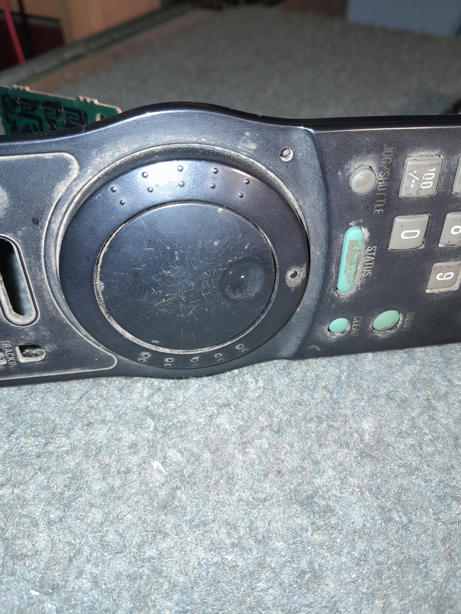

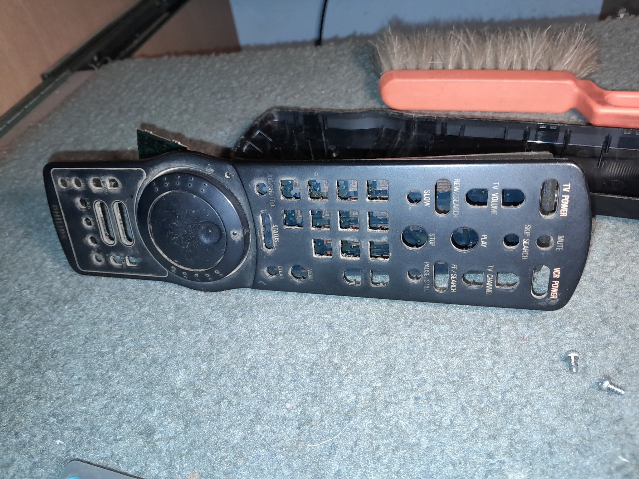

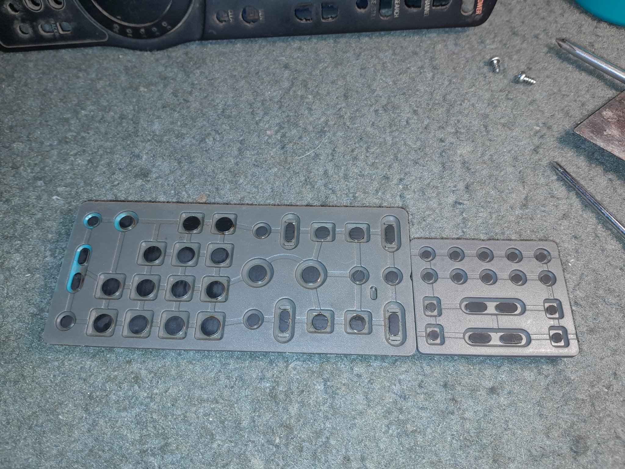

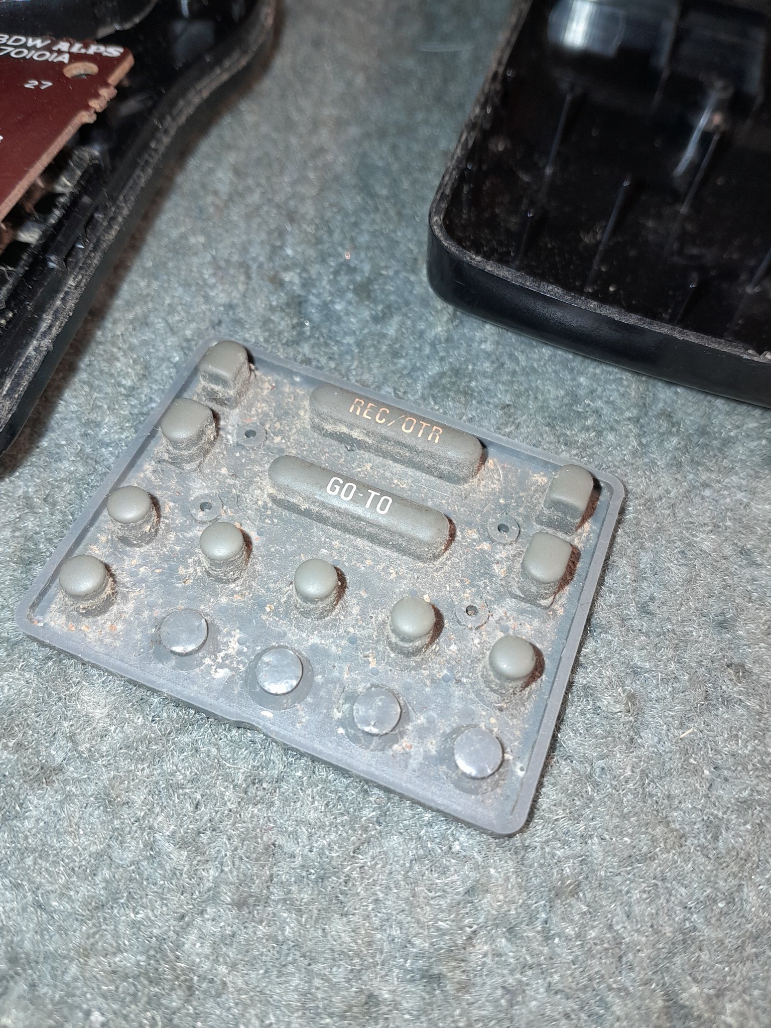

Well, it's open, as NarashBrd and Rayma suggested, by prying it off with the appropriate tool. You can see the locks in the photos; click to enlarge.
The "rivet" was part of the injection process, as Jean Paul said.

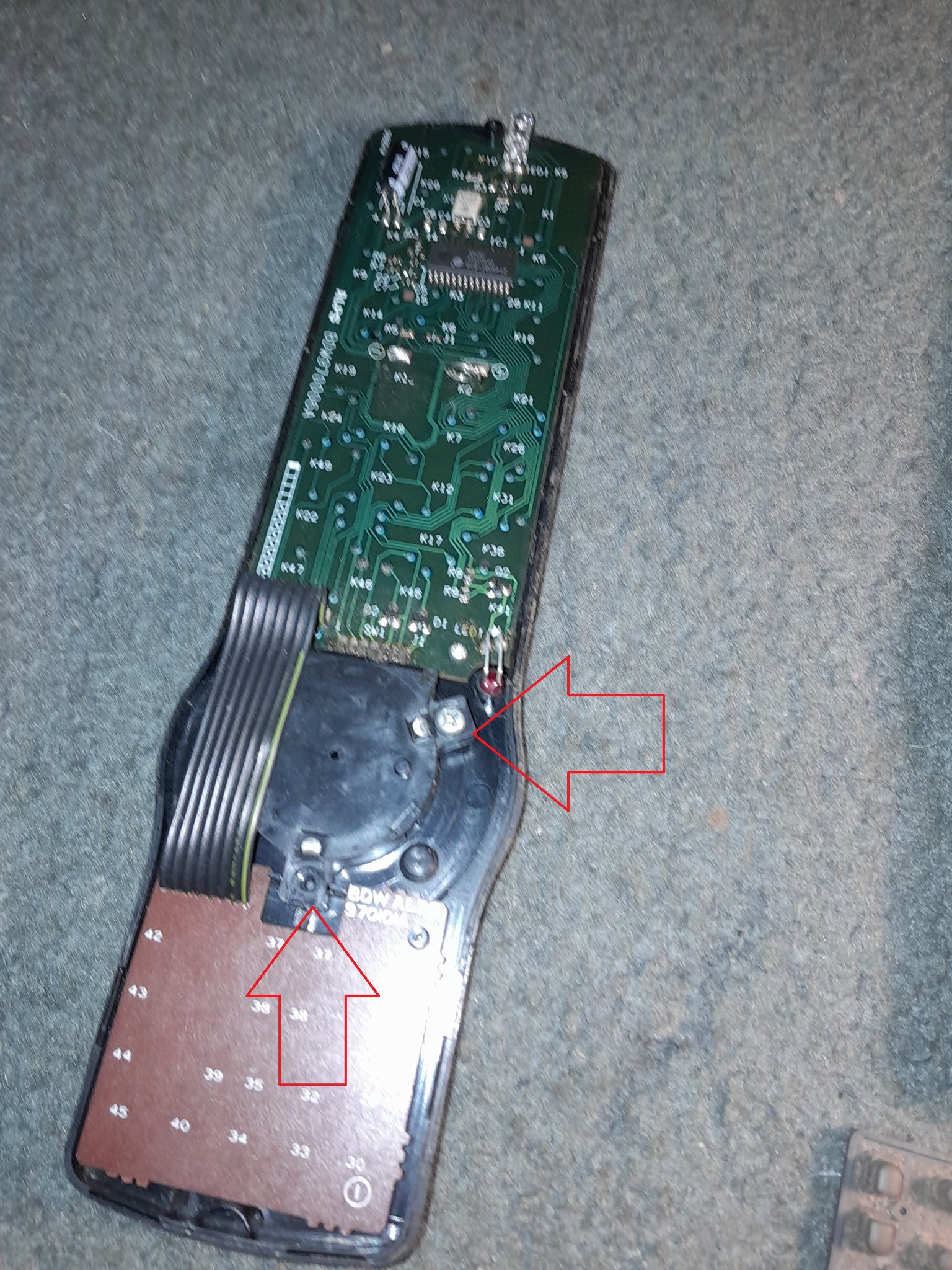

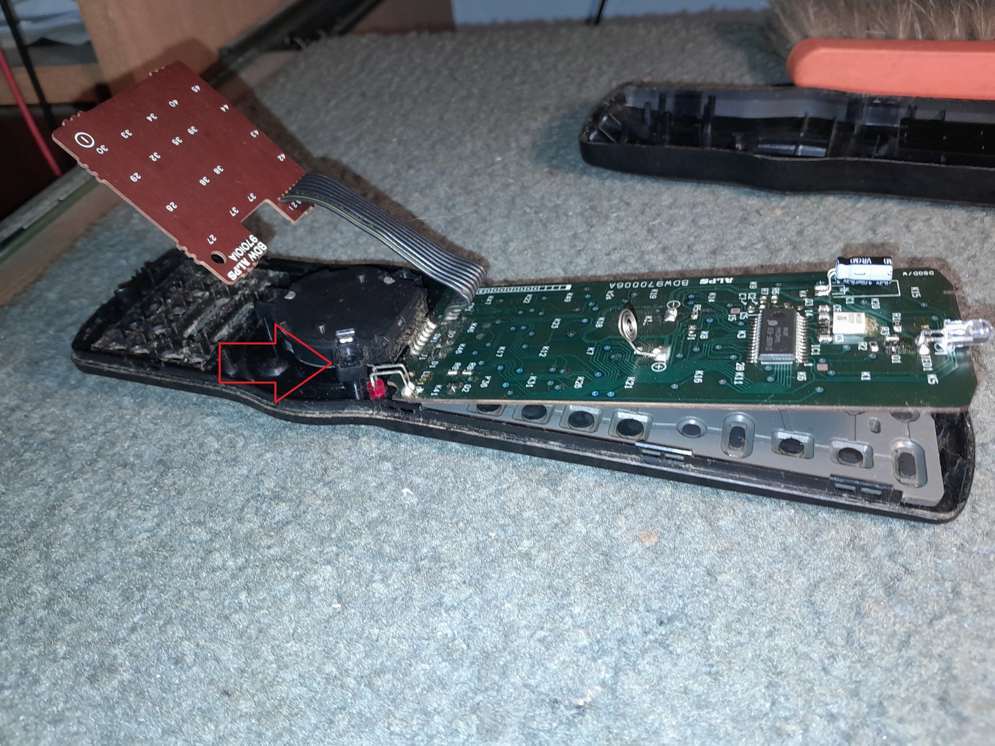

The CR had stopped working; the battery contacts were unsoldered. Changing the batteries after so many years of use had caused the solder joints to come loose.
This CR has a huge spring-loaded rotary knob; I don't know what it's for, because the VCR was given to me by a dear friend, who is no longer with us in this vale of tears. But the CR's most important functions worked until recently (mainly the tracking adjustment, which is impossible to do without it), so this mysterious device doesn't worry me. If anyone knows, I'd be grateful for clarifying it for me. I'd never seen this system before in other VCRs I've owned.
That system is complicated to disassemble because you have to separate the mechanism from the knobs, and the PCB is in between. I removed the screws, studied everything, and gave up. There's a risk of breaking something if you apply force. I tried with minimal pressure, and it doesn't come off. I can clean the contacts with isopropyl alcohol—they're in good condition—without disassembling that part.
I'll let you know if I'm successful when I'm done. Everything suggests there won't be any problems, and I'll be able to use this VCR to watch and, if possible, edit family memories and burn them to DVD. A task I've attempted several times but never managed to achieve. You buy Pinnacle Dazzle Recorder; it works well in Windows 7, but time flies. You start the task, interrupt it, and when you resume, it no longer works. You have to upgrade to Windows 10! And the heirs of our friend Bill are already warning me that technical support will end in October and I will have to upgrade to Win 11....Surely when I do, Win 12 will come out!!! And I will have to learn everything again.......sniff....we were so happy!
